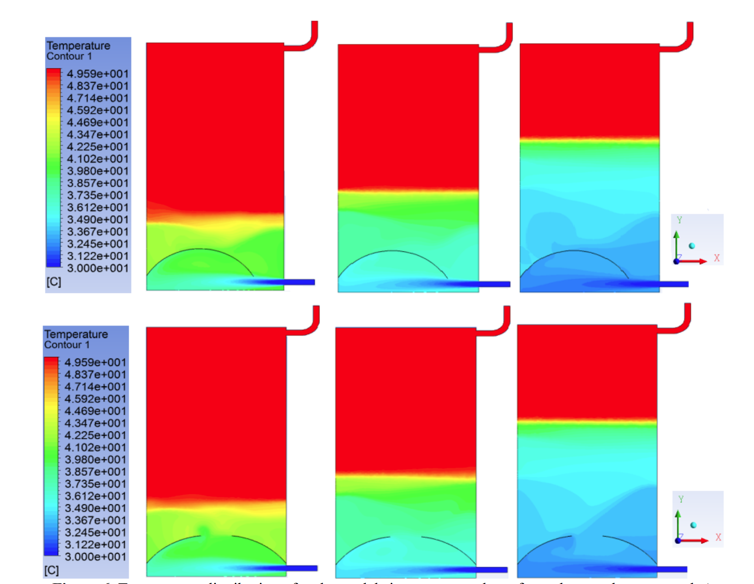

IanR Posted January 29, 2023 Share Posted January 29, 2023 4 minutes ago, JamesPa said: The only way to balance the flows into and out of the tank if the two pumps are operating at different flow rates, is for there to be a top to bottom (or bottom to top) flow as well as a lateral flow. But no mixing. The warmer water remains above the thermocline, at flow temp, and the cooler below the thermocline at return temp, the proportions of each body of water increase and decrease, moving the thermocline up and down the tank. 11 minutes ago, JamesPa said: Of course as the water flowing from top to bottom moves through the tank it will heat up or cool down by robbing heat from (or donating heat to) the body of water in the tank. But one way or another it must move through the tank and must exchange heat with the water it mixes with. No, the bodies of water at the two different temps do not mix. Their different densities keep them apart with the lower density water having the top spot. The volume of each of the bodies of water change in inverse relation to each other as either the heat pump adds more flow temp water to it or the HC removes flow temp water from it. 17 minutes ago, JamesPa said: That doesn't necessarily destroy stratification, but still exchange of energy takes place. Your version does destroy stratification where there would then typically be a linear temp gradient from top to bottom of the tank. My version requires stratification to remain in place, otherwise there is no point to a 3P or 4P buffer. 1 Link to comment Share on other sites More sharing options...
JamesPa Posted January 29, 2023 Share Posted January 29, 2023 Im not now sure if we are agreeing or disagreeing! Assuming that both HP flow and CH flow are at the top and HP return and CH return at the bottom, lets start with an extreme example. Suppose we switch off the HP pump but leave the CH pump on. Nothing will flow through the HP circuit. Over time cool water will come in at the bottom (from the CH pump) and slowly both the actual water and the thermal gradient will move up to the top. Eventually the water at the top will be more or less the same temperature as the water coming in at the bottom. It will take a while to get to this point because the circulating water in the CH system will continue to give up energy to the house, and thus return to the tank cooler, until it has cooled down completely. That's similar behaviour as a DHW tank when you switch off the element. If we switch the HP back on but it is running at a lower flow rate than the CH pump, then there will be a slower movement of the, initially cool, water molecules from the bottom to the top, at a rate equal to the difference in pump flow rates. If this movement were not taking place, then more water would be entering at the bottom (at the flow rate of the CH pump) than is leaving at the bottom (at the lower flow rate of the HP pump), and more water would be exiting at the top than is entering at the top,. This can only be resolved by the movement of water from bottom to top. The water may well move 'slab-like', but it must move. As the cool water molecules are pushed up they will, if the heat pump is on, exchange energy with the warm water molecules, so the thermal gradient will be maintained. If everything is left for a while, it will eventually reach a steady state. The movement doesn't, if its sufficiently slow and is not too turbulent, destroy stratification, but it does involve energy exchange. In principle the energy exchange could be purely by conduction, but more likely it also involves water mixing in the top stratum as the rising cooler water encounters the turbulence likely caused by the hot water flowing in and out of the ports. If the movement through the tank is sufficiently slow and not turbulent (other than, possibly, at the top) I would expect that the penalty would be small, quite possibly negligible. This could be verified by measuring the temperature drop from flow inlet to flow outlet across the buffer tank. Basically Im saying that I agree that a 4 port buffer tank with little turbulance operated with pumps that have reasonably similar flow rates will not incur a penalty. However If the flow rates aren't reasonably similar (particularly if the CH flow is faster than the HP flow) or there is significant turbulence, then this may not be the case. 1 Link to comment Share on other sites More sharing options...

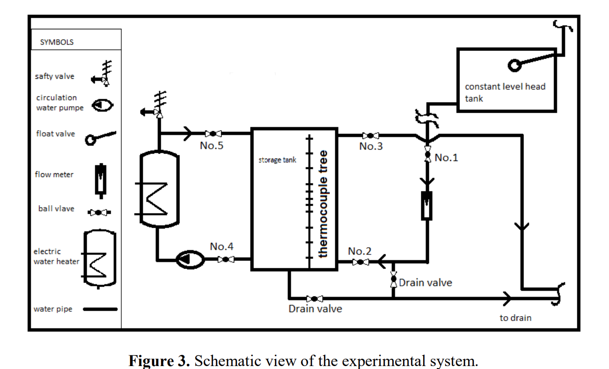

IanR Posted January 29, 2023 Share Posted January 29, 2023 (edited) 5 hours ago, JamesPa said: If everything is left for a while, it will eventually reach a steady state. For which the time frame would be 10 to 100 times longer than the cycling of the heat pump, while it is providing heat to the central heating, so is not relevant to the performance of the heat pump. This also takes us deeper into the physics of temperature stratification in hot water tanks, where I do not feel this conversation needs to go - there are loads of references for it on t'internet. But, in short, the insulating properties at the boundaries of the stratified layers means that the convection currents from standing losses far exceeds any conduction between the layers so the cooler lower area actually cools quicker than the warmer upper layer and the tank becomes more stratified as it cools. The convection currents are caused by the standing losses at the tank wall which cools a very thin vertical layer of water adjacent to the wall. The water of the vertical layer becomes denser than its surroundings and slips towards the bottom of the tank, reducing the temp at the bottom of the tank. But none of that matters while the pump is cycling as the energy losses are minor and covered by the known standing losses for the tank. The standing losses for my tank, based on it being an average 50% charged during the call for heat period is 17.5W. or at a worst case CoP of 3............ 6W of electrical power. Maybe I've not allowed for the times the buffer is fully charged just as the call for heat ends, so gets wasted, but were talking really small numbers that are well within the potential error size of such predictions. 5 hours ago, JamesPa said: If this movement were not taking place, then more water would be entering at the bottom (at the flow rate of the CH pump) than is leaving at the bottom (at the lower flow rate of the HP pump), and more water would be exiting at the top than is entering at the top,. This can only be resolved by the movement of water from bottom to top. The water may well move 'slab-like', but it must move. If you mean by the water in the the lower portion of the tank, which is at return temp, increasing in volume, while the water in the upper area of the tank, which is at flow temp, reducing in volume so that the boundary between these to stratified layers (the thermocline) rises up the tank a little, the yes it "moves". 5 hours ago, JamesPa said: Basically Im saying that I agree that a 4 port buffer tank with little turbulance operated with pumps that have reasonably similar flow rates will not incur a penalty. However If the flow rates aren't reasonably similar (particularly if the CH flow is faster than the HP flow) or there is significant turbulence, then this may not be the case. Unfortunately that's not what I'm saying. There is absolutely no need for the pumps (ASHP & heating circuit) to have any similarity of flow rate or duration, which is lucky because they don't. The heating circuit pump will run continuously while there is a call for heat, while the heat pump will cycle on and off. In a correctly sized buffer, there won't be sufficient turbulence to cause mixing since the heat pump flow rate and pipe sizing will restrict the flow velocity to within the capabilities of the tank. The images and link I posted above show how robust the stratification in the tank is with the thermocline plane in the bottom 25% of the tank and close to a 12 l/m inlet that has only a plain baffle, flat sides, no porting, no pockets no swirl bowl in the lower face. Looking at the colour chart I would suggest the top 70% of the tank has remained at the flow temp, or within 0.5°C Edited January 29, 2023 by IanR Link to comment Share on other sites More sharing options...
JamesPa Posted January 30, 2023 Share Posted January 30, 2023 8 hours ago, IanR said: If you mean by the water in the the lower portion of the tank, which is at return temp, increasing in volume, while the water in the upper area of the tank, which is at flow temp, reducing in volume so that the boundary between these to stratified layers (the thermocline) rises up the tank a little, the yes it "moves". Yes that's exactly what I mean. For this to happen water must actually move upwards in the tank, but I agree that the integrity of the boundary could be maintained, at least until it pushes so far up the tank that its nearing the top 8 hours ago, IanR said: Unfortunately that's not what I'm saying. There is absolutely no need for the pumps (ASHP & heating circuit) to have any similarity of flow rate or duration, which is lucky because they don't. The heating circuit pump will run continuously while there is a call for heat, while the heat pump will cycle on and off. In a correctly sized buffer, there won't be sufficient turbulence to cause mixing since the heat pump flow rate and pipe sizing will restrict the flow velocity to within the capabilities of the tank. The images and link I posted above show how robust the stratification in the tank is with the thermocline plane in the bottom 25% of the tank and close to a 12 l/m inlet that has only a plain baffle, flat sides, no porting, no pockets no swirl bowl in the lower face. Whist the analogy with DHW is useful to understand turbulence within tanks, it can only be pushed so far. We run DHW for minutes and in any given run extract only a portion of the tank volume. We run CH continuously and the volume passing through them is a fairly short period of time well exceeds the tank volume. I think its time to 'do the math', it may well be that we agree on the outcome, if not actually the mechanism. Lets consider an 8kW heating system operating at approximately full load, with a 200l tank and (since this is a UFH thread), a deltaT across the emitter of 4C. Roughly 0.5l/s of water must be delivered to the load. If the HP pump and the CH pump are operating at exactly the same speed, the tank water will remain static except at top and bottom where 0.5l/s will pass laterally between input flow and output flow/input return and output return. A static thermal profile will establish. Lets call this the 'baseline' If the HP pump is stopped, then it will take 400s, 6.6 mins, for the contents of the tank to cycle round the CH system, the original thermocline will have moved fully through the tank (and possibly replaced by a new one at a lower temp) and the water exiting the tank will be (roughly) at the initial return temperature. If, alternatively, we have both the HP pump and the CH pump on and the HP pump is operating at half the speed of the CH pump, it will take 800s, 13 mins, for the water initially at the bottom to rise to the top. But rise to the top it must because otherwise there is more water leaving at the top than entering at the top. The thermocline will be pushed up the tank relative to the baseline. Eventually half of the water exiting the tank at the top will have come from the bottom, heating up as it is pushed up, but not quite as high as the original temperature. If the system remains like this it will eventually reach a new steady state where there is a flow temp difference, however small, across the buffer tank. If, we have both the HP pump and the CH pump on and the HP pump is operating at twice the speed of the CH pump, it will take 800s, 13 mins, for the water initially at the top to rise to the bottom, cooling as it falls. Eventually half of the water exiting the tank at the bottom will have come from the top, cooling down as it is pushed down, but not quite as low as the original temperature. If the system remains like this it will eventually reach a new steady state where there will be a return temp difference, however small, across the buffer tank. I imagine what happens in a properly designed system is actually none of these. I expect that the HP can deliver more than the maximum load required by the CH. If the HP pump switches off for a time whilst the CH pump continues running (because the demand from the buffer tank is satisfied but not the demand from the load), the thermocline moves up with the excess water entering at the bottom. However the HP pump switches on again before the cool water reaches the top. The HP pump then, for a while, delivers water at a faster rate than the CH pump, and the thermocline moves down again as hot water is pushed down the tank. This cycle can continue indefinitely, the control system of the HP effectively balancing the input and output to the tank even though the pumps themselves are not balanced. The water in the centre of the tank gently oscillates up and down the tank, but plausibly never leaves it. Thus, over time, the appearance of a quasi steady state is maintained (it would be interesting to build a glass tank, introduce some dye into the water, and watch it move!) Is this more or less correct in your view? 1 Link to comment Share on other sites More sharing options...
