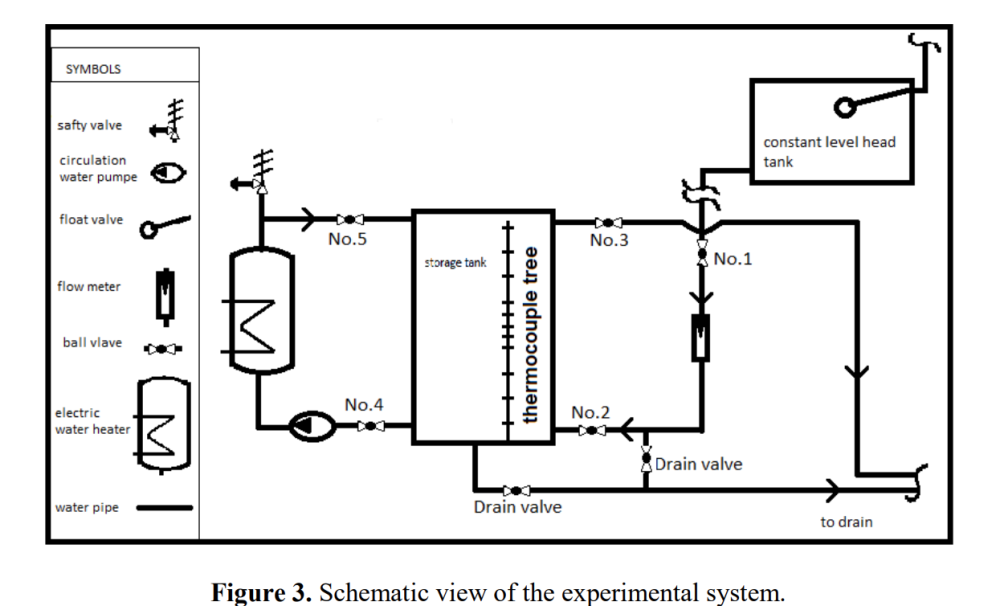

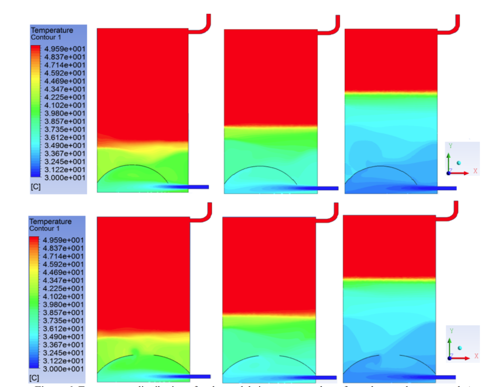

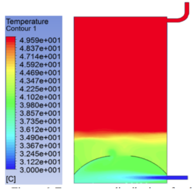

49 minutes ago, JohnMo said:
Not sure it does say a different conclusion, but that report is now very old and only really applied to fix speed heat pumps.
With regards the aspect being discussed here, Buffer tank effect on CoP, the report off the "Kiwa GASTEC at CRE" government website states: "Very little difference was seen in the predicted COP between the different configurations. (Indeed the errors in the predictions probably outweigh the difference, so this should not be relied upon for decision making)".
Where as the "Brendon Uys" suggestion shows a 28% reduction in CoP.
They are coming to different conclusions, with regards to buffer tank effect on CoP.

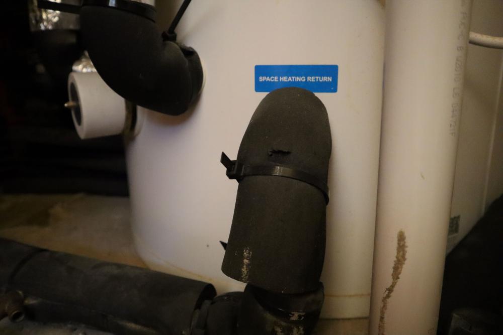

Here you are, @JamesPa.  I have a 4-port buffer integrated with and underneath my hot water cylinder.  My LG therma V 12 kW heat pump is set to do Weather Compensation but a Drayton Wiser thierd party controller overrides the LG one.  I have two zones, one for most of the house and one for the 3 smallish bathrooms.  The heat pump reports its output and input flow temperatures.  I have personally insulated the pipes between the heat pump and the buffer using Kingspan phenolic insulation and that appears to be effective.  It also makes measuring the temperature actually at the buffer inputs and outputs rather difficult, will you accept the heat pump temperature data?  This only updates about every 30 seconds so I think some of the details about what happens are lost.
At the moment it is warm out and my heat pump operates in 20-minute cycles.  At the start of each cycle the inlet and outlet temperatures are typically around 35 C.  When the room thermostat calls for heat the internal heating pump circulates water from the buffer for a approximately two minutes.  The external pump then comes on.  This runs for another two minutes before the compressor turns one during which time the inlet and outlet temperatures fall by a few degrees as the cooler water from the heating system reaches the heat pump.  In the next stage the outlet temperature starts to increase, initially on its own.  The outlet temperature lags about 5 degrees behind.  This morning it got to 40 degrees out 34 in and the main zone cut out as warm enough.  This left the smaller bathrooms zone which is required to be warmer at this time of day.  This got to 45 in 40 out before the heat pump cut out even though the thermostat was still calling for heat and the pump was circulating water around that zone.  The maximum power drawn was about 3.5 kW for a 12 kW heat pump.  In principle the maximum output temperature should be 41 C at 5 C outside.
A few minutes later and both zones now back on, both pumps running but compressor still off.  Flow temperatures have dropped to 36, 36.  now 37, 33 as compressor comes back on, then 37, 32,  then 37, 33 main zone off, then 39, 35, then 40, 36 , then 41, 37, then  42, 38, then 43, 39, then 43, 40, then 44, 40 and compressor off.  maximum power about 2.5 kW.  Internal pump on bathrooms zone runs for a couple of minutes longer.  Now no call for heat although the bathroom thermostat is 1 degree short of its target temperature (main zone at target).  The second cycle, which I recorded completely, ran from 07:25 to 07:45.
So at the moment the heat pump has the difficult task of maintaining the temperature in most of the house whilst trying to warm up three smallish bathrooms.  But this is the real world.

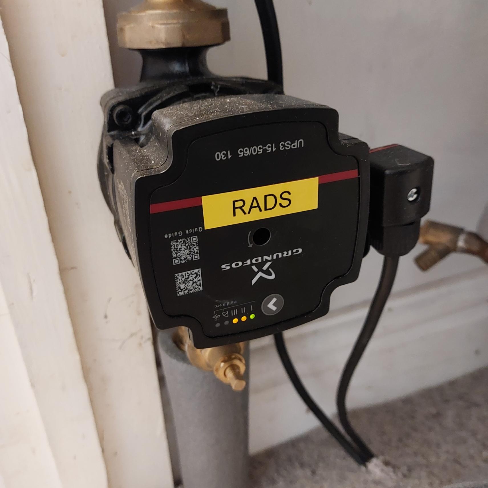

Thanks @JamesPa.  My internal pump is a Grundfos 3-speed pump.  It's normally on setting 2 because setting 3 increases the system noise level and I don't like the noise; and because the installer set it up to be on setting 2.

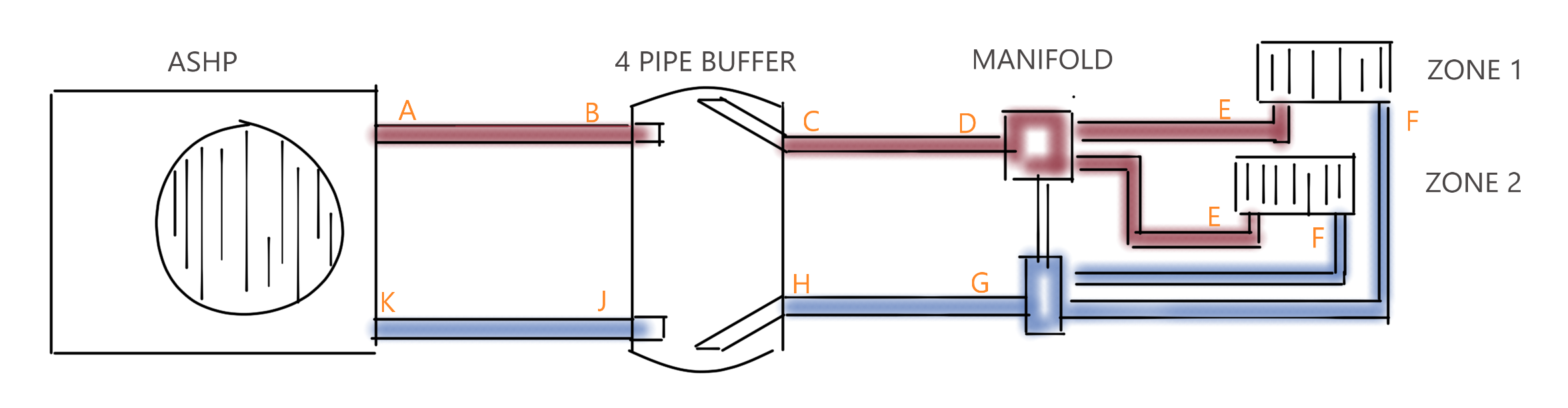

@ReedRichards, Can we clarify where you are making your temp measurements?
From what you've said, none of your measurements are at B, C, H or J. But I get confused whether you are measuring across the emitter ie. either D to G or E to F
I've made a guess below at what your Space heating plumbing might look like.
I think mine may be the same - is it this one? Would be interesting to try a lower speed. My flow temp difference is only 3degC at 35 up to 4degC at 50, and it's quite audible, although not excessively
I believe @JamesPa believes you are providing measurements across the buffer ie. B to C, H to J, or perhaps A to D and G to K.
I'm not measuring anything, I'm going by what the heat pump reports at A and K but I hope that A and B are at almost the same temperature, as should be L and K.  The drawing of my heating system is accurate except insofar as "Manifold" is two 2-port valves, one for each zone.    Points B, C, J & K are well-insulated and the insulation is fixed in place so measurements there would be difficult.  I have tried to make measurements at E and F across radiators but I only have a single thermometer and the water temperature never holds constant so it's difficult.
@PhilTMy pump is a UPM3 Flex 25-75 130 AZA.  The pump itself is not noisy and makes a low humming sound but water in nearby pipes and radiators makes a rushing sound when water is flowing through them.  I tried it on setting 1 for a while and that makes the system a little quieter but only a little.
