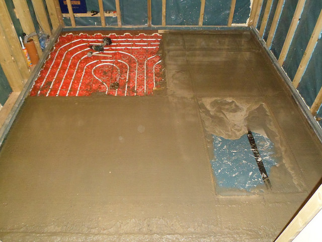

Declan52 Posted June 7, 2016 Posted June 7, 2016 I done exactly the same as on off, I just put a 100mm drain to a large rectangular hole in the floor. Had it boxed off to let the screed get put in which bought me enough time to let my wife make up her mind what she wanted. When time came I marked where the waste was in the tray and dug a slot out of the floor insulation and ran a 50mm waste to the 100mm drain. When the tray was set I made up a bucket of concrete and filled in the gap.
Onoff Posted June 7, 2016 Posted June 7, 2016 1 hour ago, Declan52 said: I done exactly the same as on off, I just put a 100mm drain to a large rectangular hole in the floor. Had it boxed of to let the Screed get put in which bought me enough time to let my wife make up her mind what she wanted. When time came I marked where the waste was in the tray and dug a slot out of the floor insulation and ran a 50mm waste to the 100mm drain. When the tray was set I made up a bucket of concrete and filled in the gap. I've done something right then! 1
