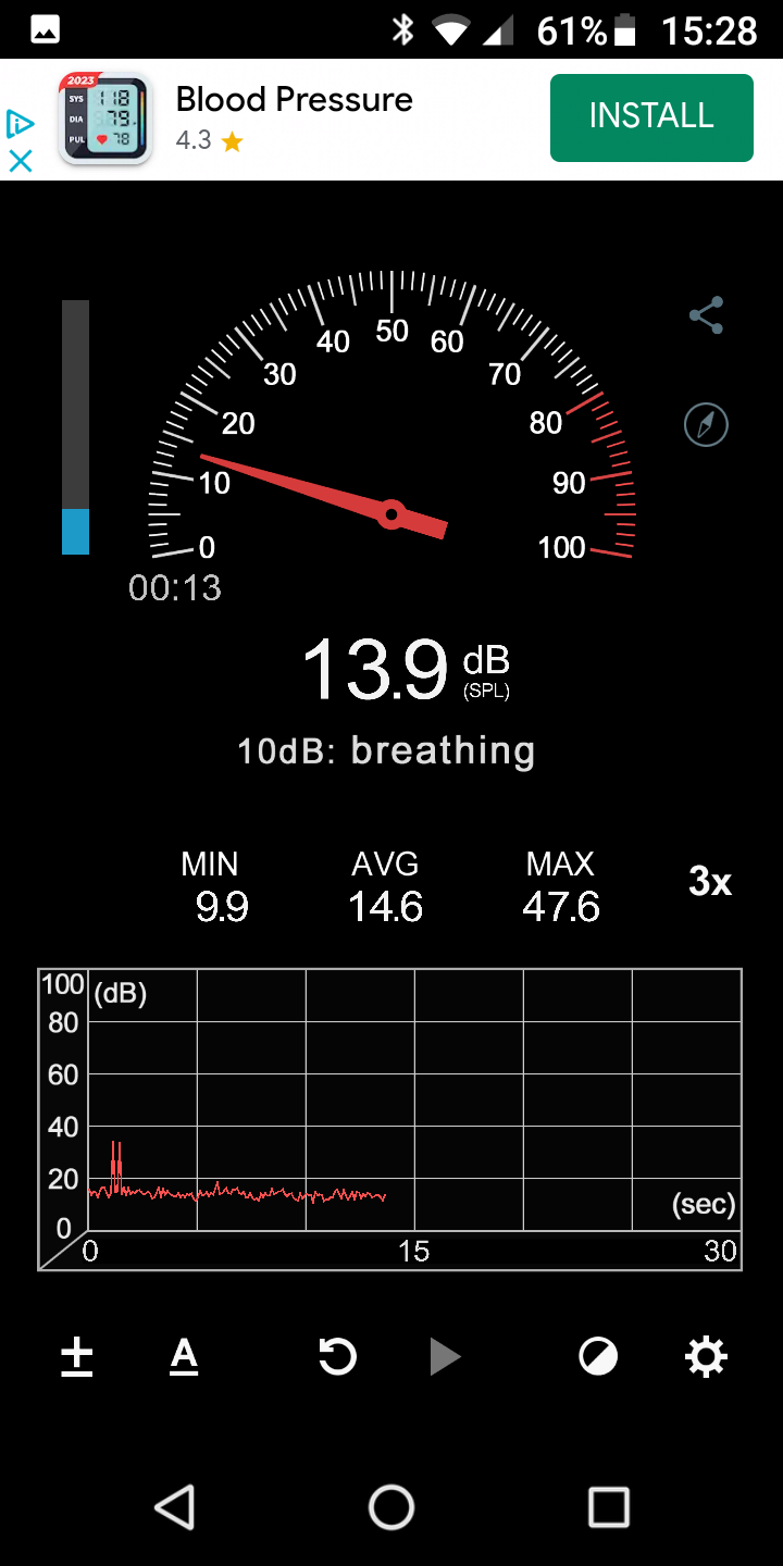

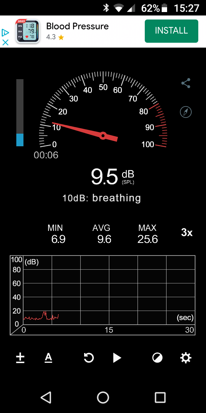

We have an old fridge at work made by Bush that is so quiet I may swap it for my one at home.
Just did two sound readings, one with it not running, and one with it runnin. 1 meter away. The spike on the first one (not running) is me breathing.
Not running
Running

My one at home, that I did the sound test on, was the cheapest from Currys.
https://www.currys.co.uk/products/essentials-cur48w22-undercounter-fridge-white-10227820.html
The Bush one at work is probably 15 years old, no idea what model it is, looks similar to this one though.
https://www.argos.co.uk/product/9312603
