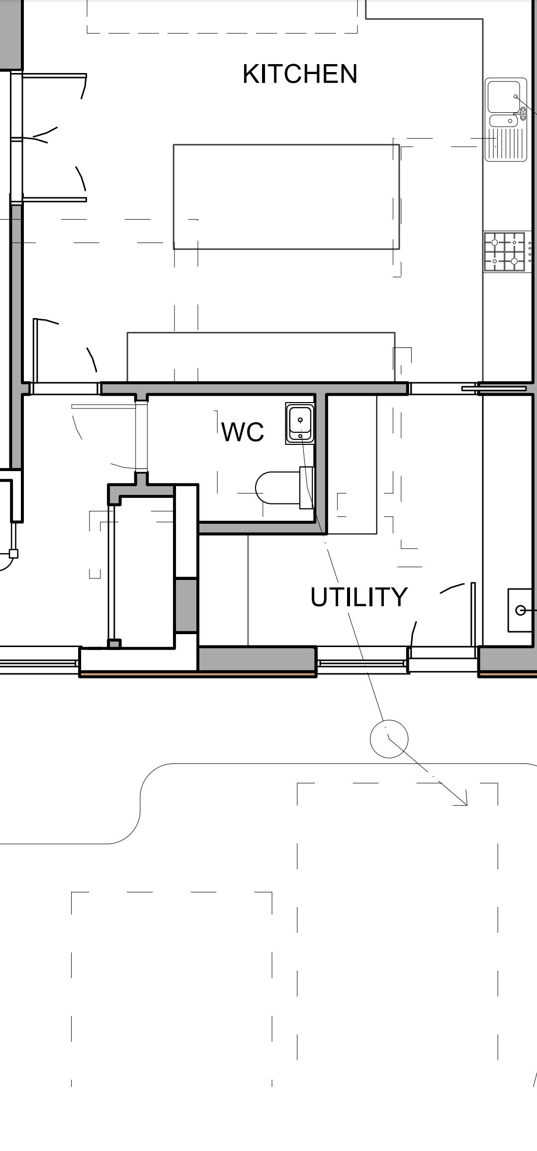

Anyone any idea how to make an external vent possible and not out of place in a wooden clad house. Have a downstairs toilet and utility room and I need to extract from, but outside front of house will have wood cladding to bottom of downstairs window cill. Only option I can see is to take up stud and through roof, any other option.

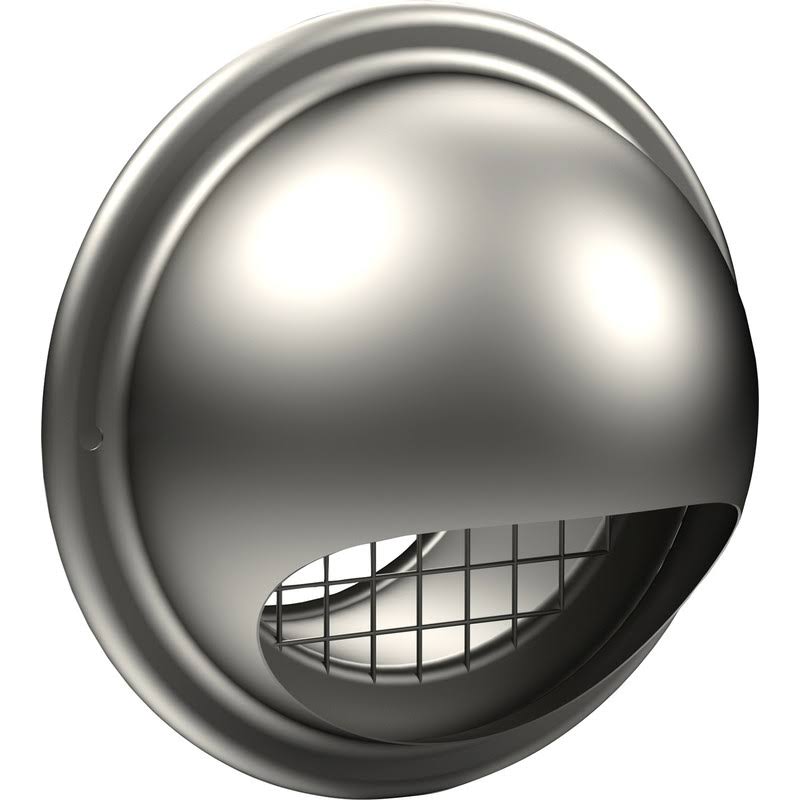

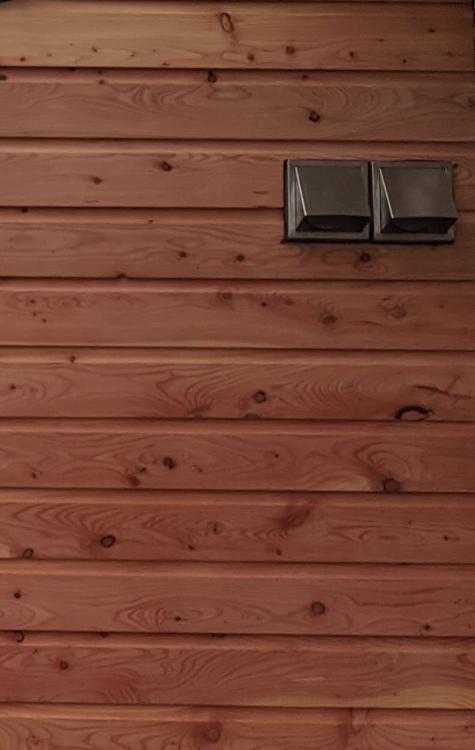

I have used these stainless steel cowls on my extension, they're functional but I think they look acceptable.
Or there are quite a few places round here that use the bullnose version:
To be honest I think I prefer the bullnose as they're a bit smaller.
But I had to put two vents beside each other and so the square ones looked the least worst. If I had my time again I would have made sure the duct outlet lined up to the cladding spacing a bit better, maybe centred to a board, although it'll never be perfect due to the mismatched size. But in real life when you're looking at the whole wall they look smart enough that you don't notice them.

Thanks, can I ask where you got those from. And did you use an inline fan. My issue is that I will have to go for a rigid duct going from the toilet,through section of utility to outside I think as steel between roof of toilet and utility

And yes, an inline fan with a rigid duct through the wall. My layout is similar to yours, without the steel. So the bathroom just has a wall terminal, then rigid duct to utility, inline fan in the top of a utility cupboard, rigid duct to the outside.
I installed the exterior duct before the cladding to allow me to seal it properly to the breather membrane.
