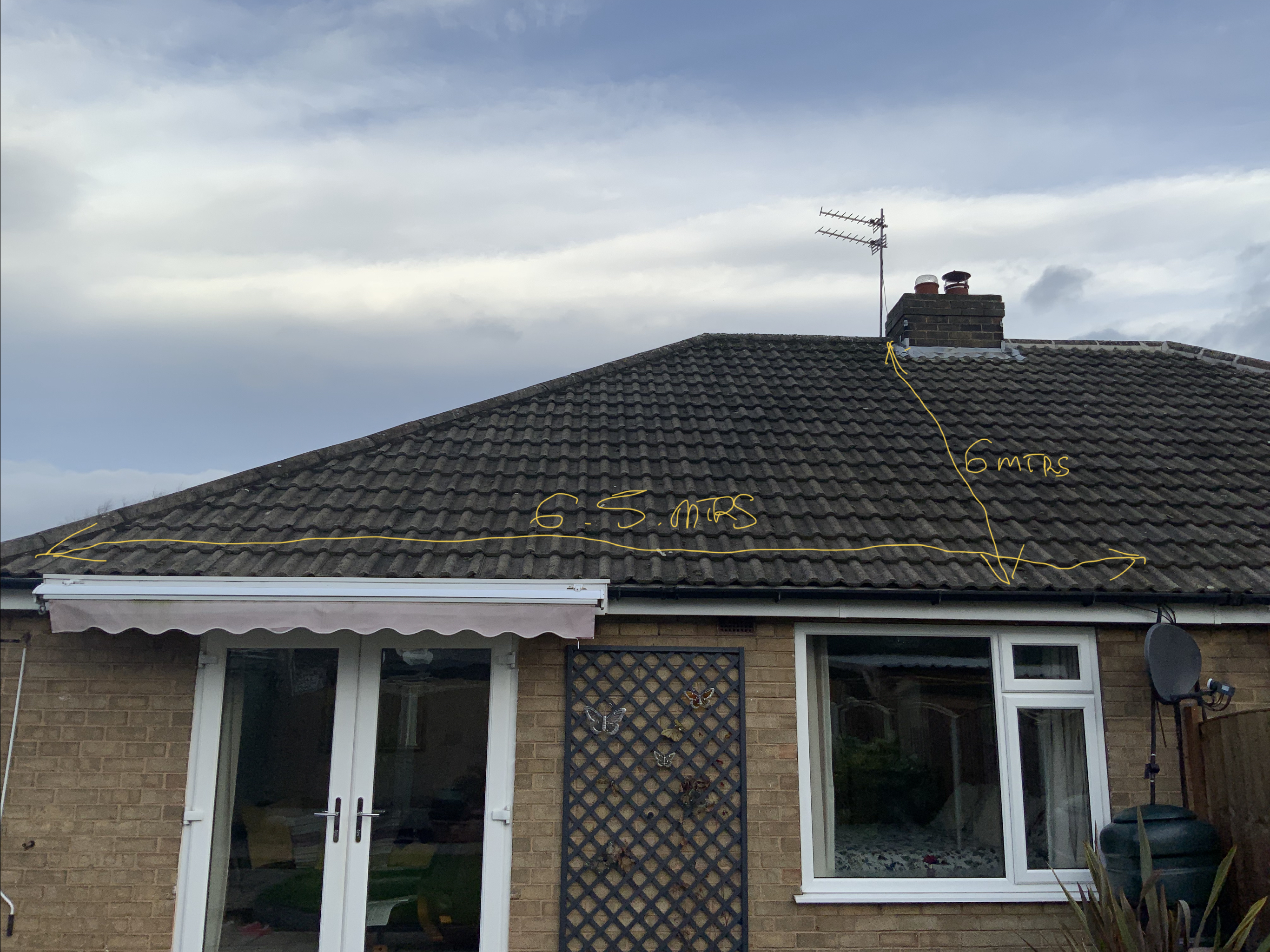

I’ve got a Lux 3600 ACS Inverter with 3x 3.2 Greenlinx batteries  system fitted 13/10/22 which I’m well pleased with supplying 98% of my daily use! My last years electricity  usage was approximately  6,000.KWH. So I’m not looking to fit solar panels on south facing semi bungalow roof!
i’ve had a quotation for fully fitted all certificates using existing inverter. 6xJinko Panels 415 (2.4) kWp @ £ 4,397.00. & 9 Jinko Panels 415 (3.7)kWp @ £5,022.00.

I wonder if the ridge section is the width of a 'landscape' panel, in which case I guess you'd get 5 panels up to the L of the stack. One more can go anywhere you want in the remaining triangle. I think 9 might look 'busy'. I am no expert of aesthetics, and not a lot bothers me, but I think the 'notchy' look where PV 'climbs a hip' is not to everyone's taste.
Prices look about what I'd expect. Some have, I think, had 4kW for £4k or just under, but £4400 sounds acceptable to me (especially when that could have cost £17 - 20k in 2009/10!!

One thing I noticed from the photo you posted is that if the West face of your bungalow isnt shaded you can add panels the that bit of the roof as well as the south face.

The 3600 Hybrid has DC inputs for two strings, so one option is to put the "awkward" panels (assuming there's enough of them and they're fairly similar in awkwardness) on string A and all the good panels on string B. Or you can just not use the awkward spaces and, as @Dillsue suggests, have the west face as string A and the south face as string B.

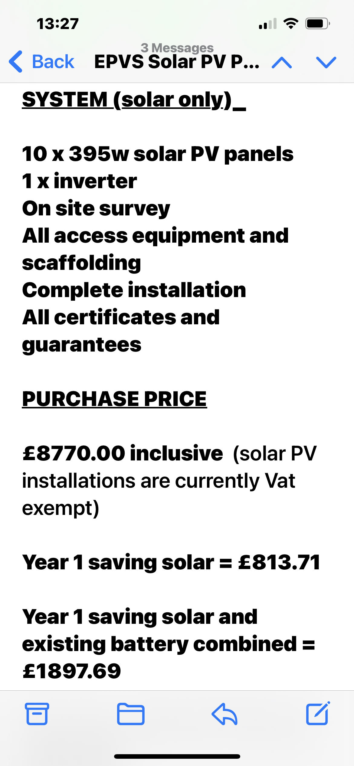

4 minutes ago, Alshamal said:
What’s your thoughts on this quote and projections!
Get some more quotes, that's ridiculous for a 4kWp install. Take 40% off and it would be reasonable. Less if that's switching for a hybrid inverter, it's not clear from the quote.
