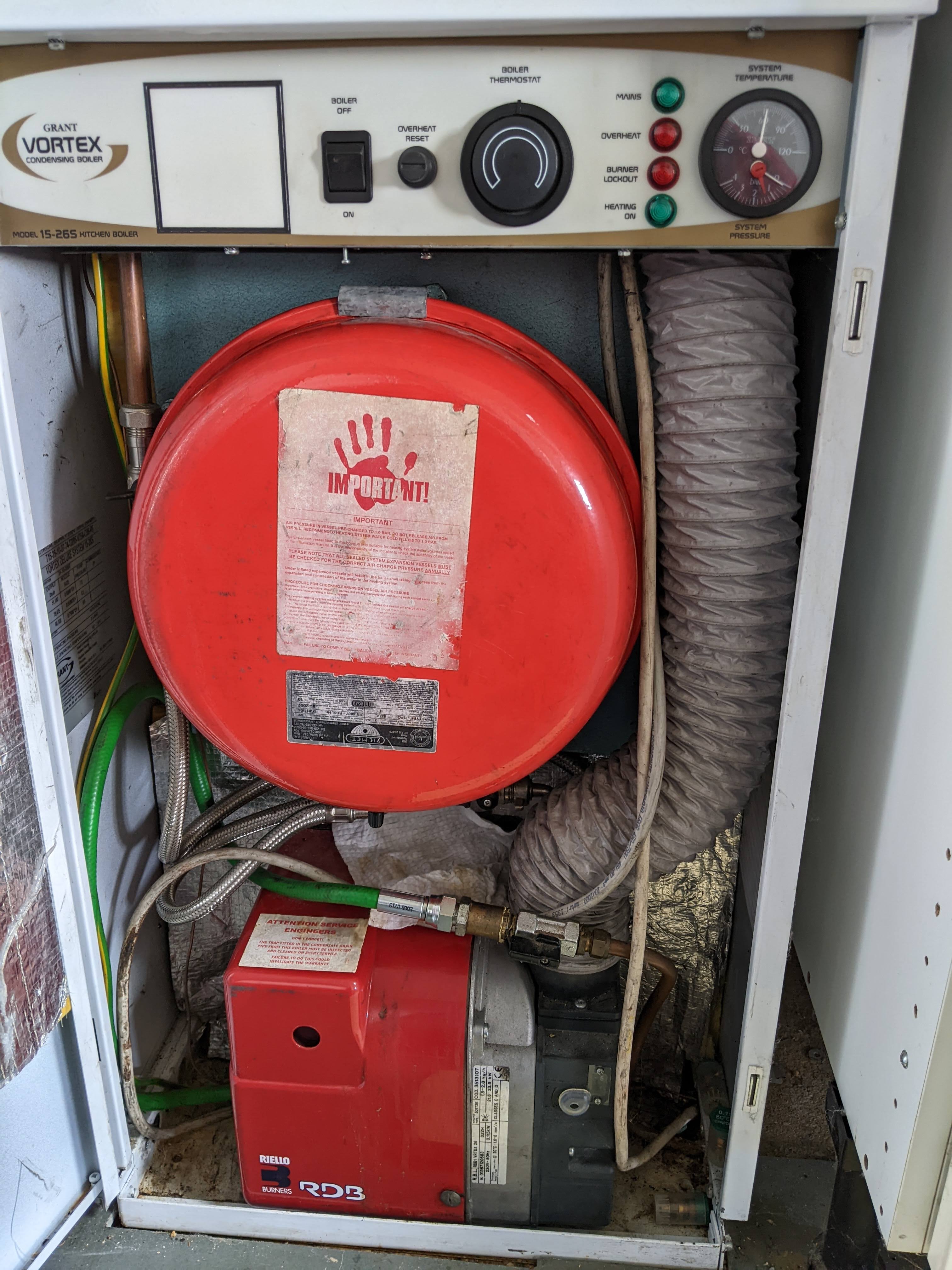

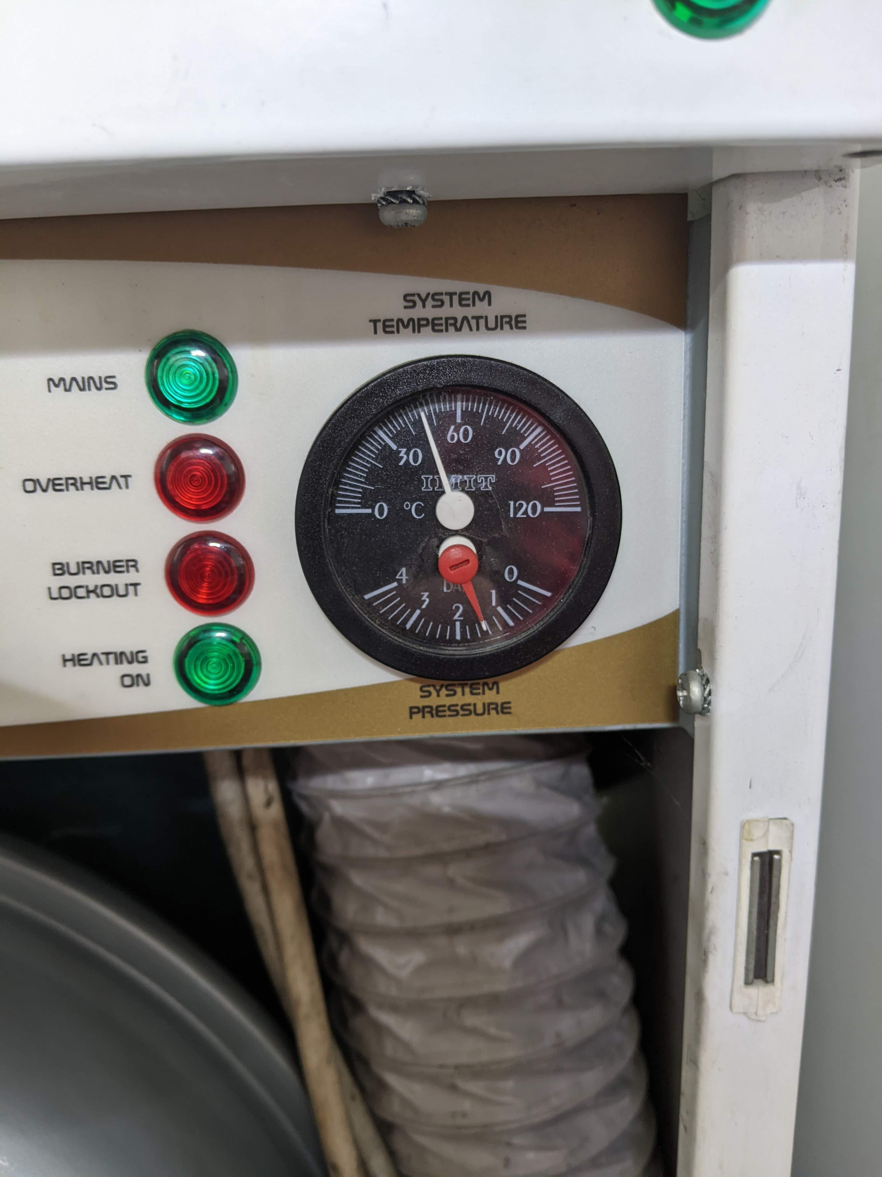

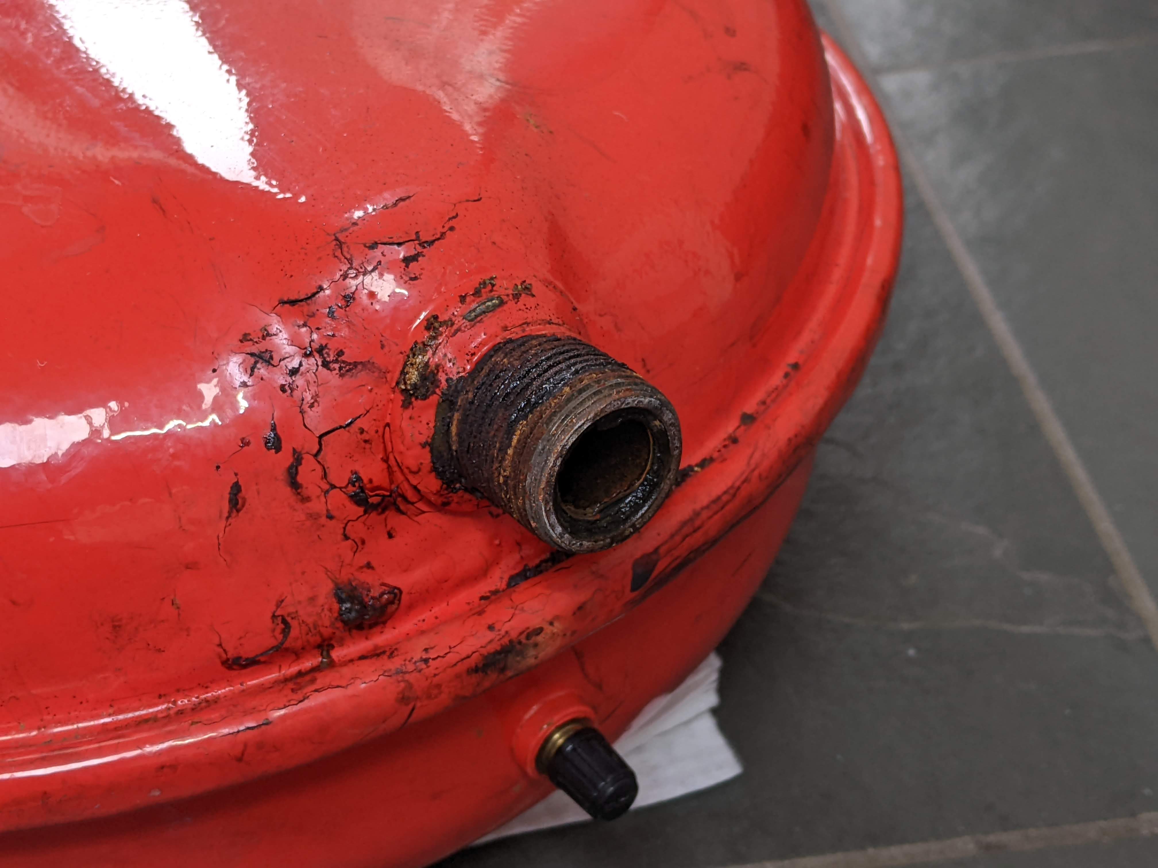

Furnace Posted January 15, 2023 Share Posted January 15, 2023 It appears that the expansion vessel has failed. Water comes out of the schrader valve for a few seconds, then air. Leaving it for a few seconds, the same thing happens again. This suggests that there is a hole in the diaphragm? I've ordered a direct replacement. Is it a simple DIY job to replace it? I was intending to: Turn off the mains and open a hot water to depressurise the system. Unmount the expansion vessel and move it outwards from the boiler to the extent of the braided hose. Position it over a bucket Undo the fitting on the old EV base. Pray water doesn't piss everywhere. Install flexible fitting on base of new EV. Check pressure on EV with tyre pressure gauge Remount EV on boiler. Turn on mains water. Pray Does that sound reasonable? What have I missed Link to comment Share on other sites More sharing options...
ProDave Posted January 15, 2023 Share Posted January 15, 2023 That's a system boiler not a combi, so opening the hot tap won't let off the pressure. That EV is for the sealed heating system. The water should already be turned off. There is an over pressure release valve on the top of the boiler if you remove the top cover, you can manually open that to let off the pressure. But the pressure already looks very low. Link to comment Share on other sites More sharing options...
Furnace Posted January 15, 2023 Author Share Posted January 15, 2023 Thanks Dave. I should replace 1. with "Remove boiler cover and release any excess pressure from the system" and 9. with "repressurise boiler system by opening filling loop valve" Makes sense? Link to comment Share on other sites More sharing options...
Temp Posted January 15, 2023 Share Posted January 15, 2023 (edited) I think you should drain the heating system not just release the pressure. Unless there is a way to isolate the expansion vessel from the rads. If it needs draining put corrosion inhibitor back in afterwards (eg Fernox f1 or similar). What does @Prodave think? May need ptfe tape for the connection to the expansion vessel. Edited January 15, 2023 by Temp Link to comment Share on other sites More sharing options...

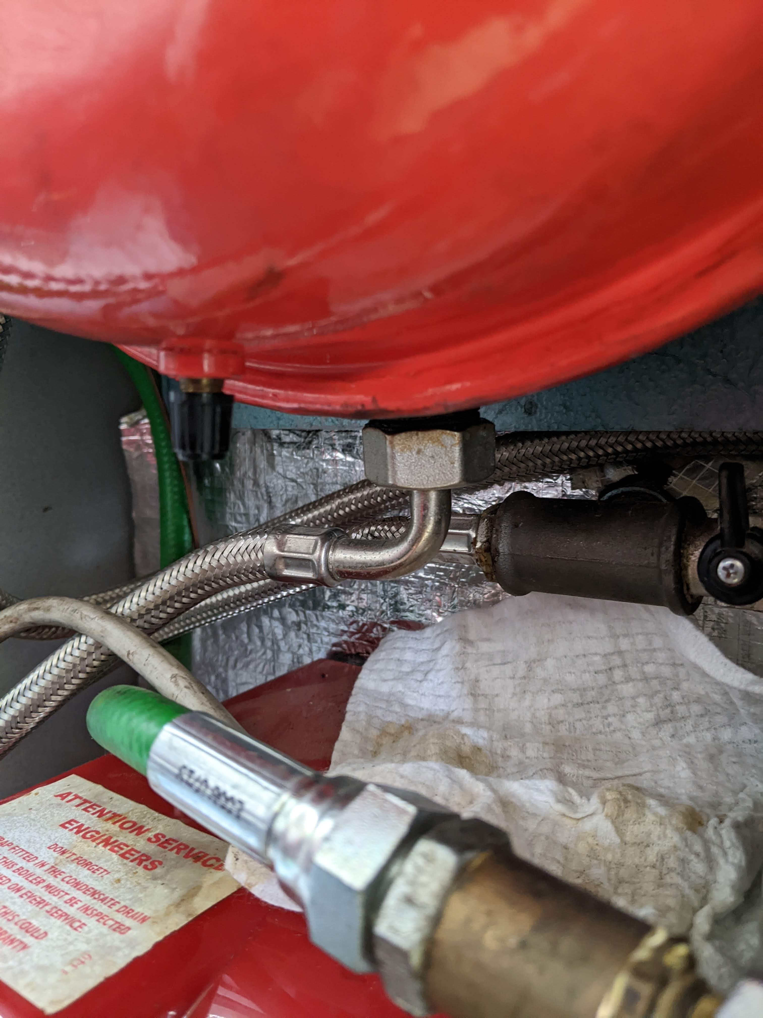

PeterW Posted January 15, 2023 Share Posted January 15, 2023 @Furnace from memory those hoses have a rubber washer in them on the face of the joint with the expansion vessel. Ideally you want to change that too, or at least turn it over and re-seat the hose. Good opportunity to drain and refill with inhibitor as @Temp said - when was the system flushed last ..?? Link to comment Share on other sites More sharing options...

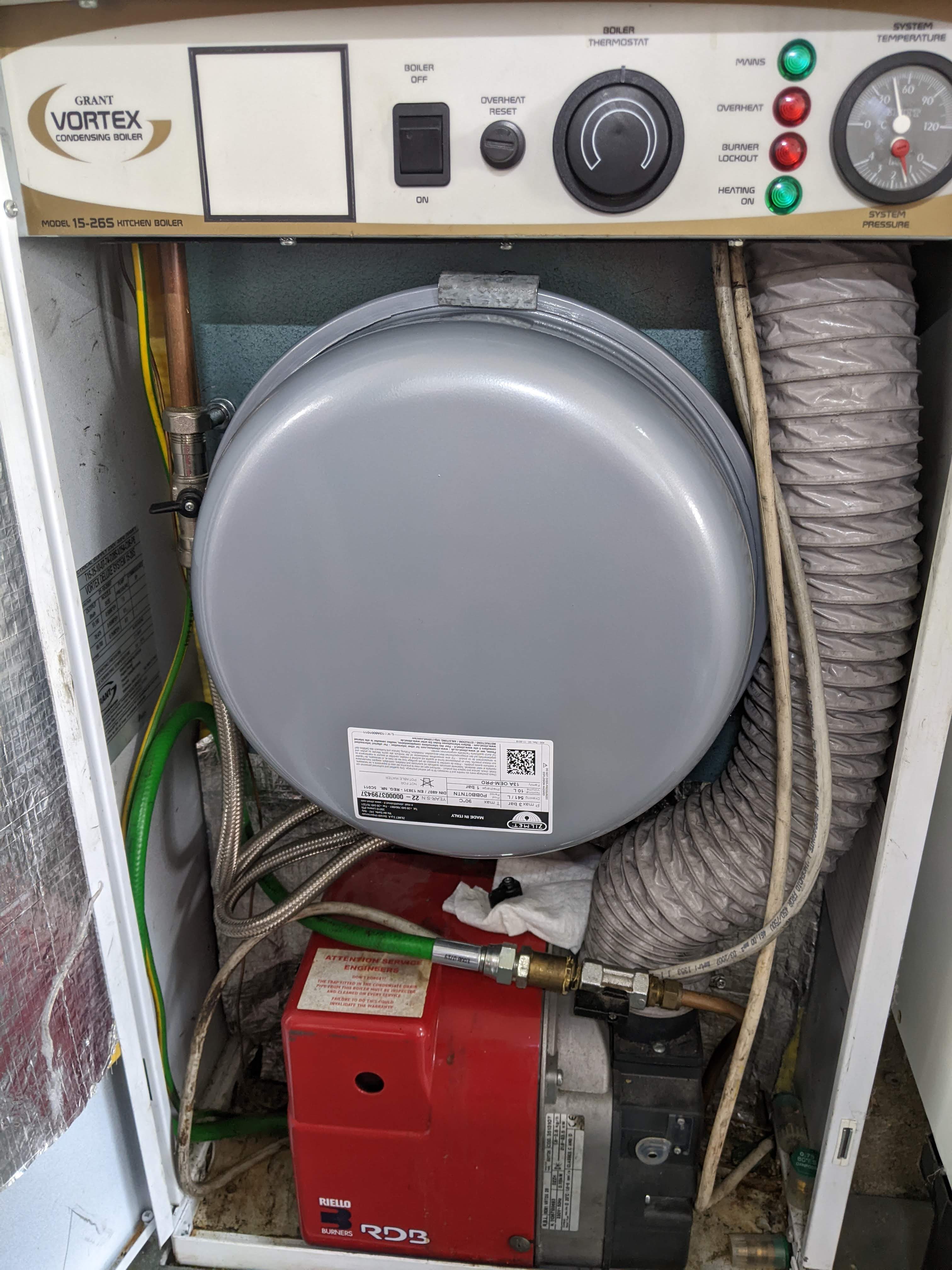

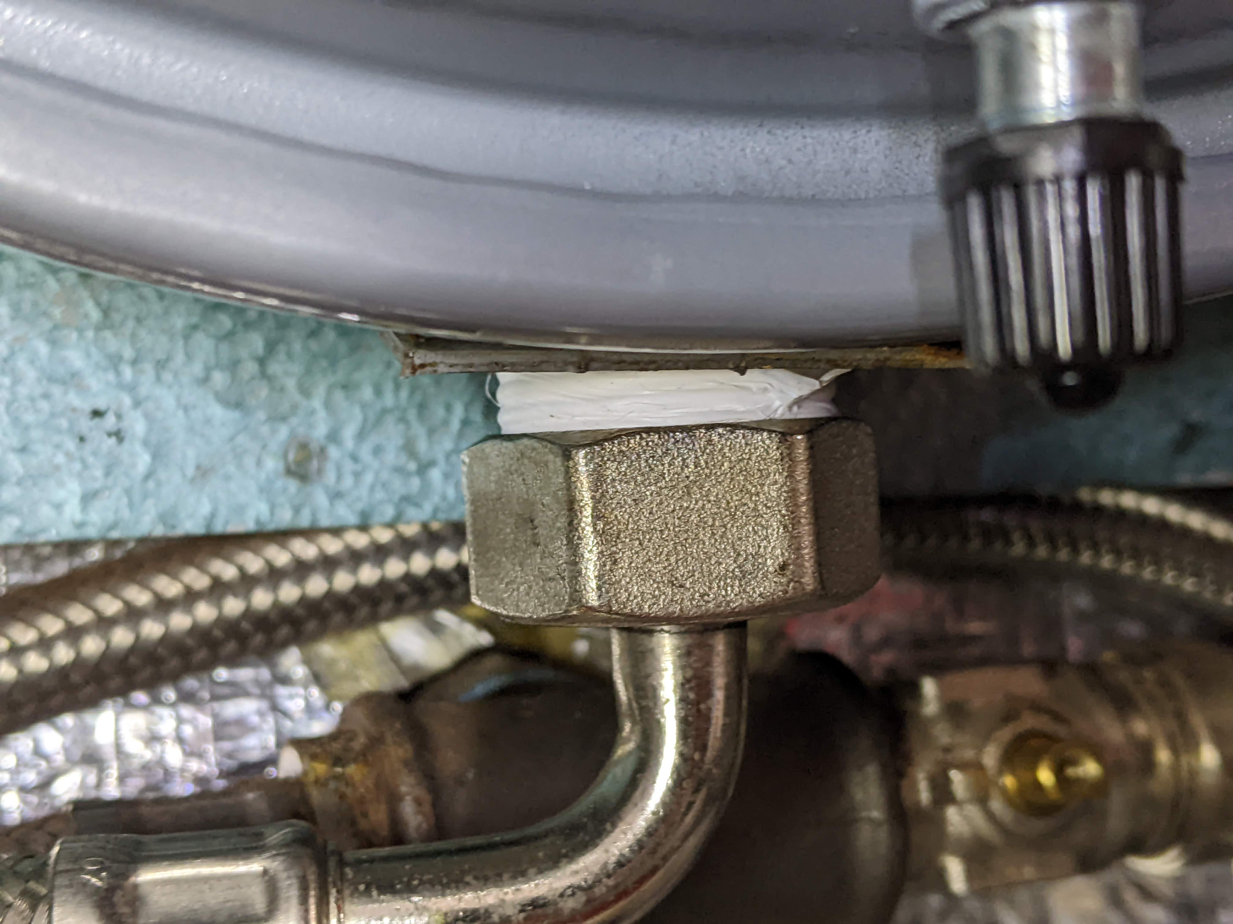

Furnace Posted January 17, 2023 Author Share Posted January 17, 2023 Job done and it looks to be running at the correct pressure now. It's too cold to mess around with draining down and refilling - it's my folks' house and they're in their 90s. Thanks to all for input and saving me waiting 2 weeks for the next available plumber. It looks like there may have been a micro-weep around the EV vessel causing corrosion. I've put on PTFE tape that may (or may not) prevent it happening again. It's 15yrs old, so I'm not too miffed. Link to comment Share on other sites More sharing options...

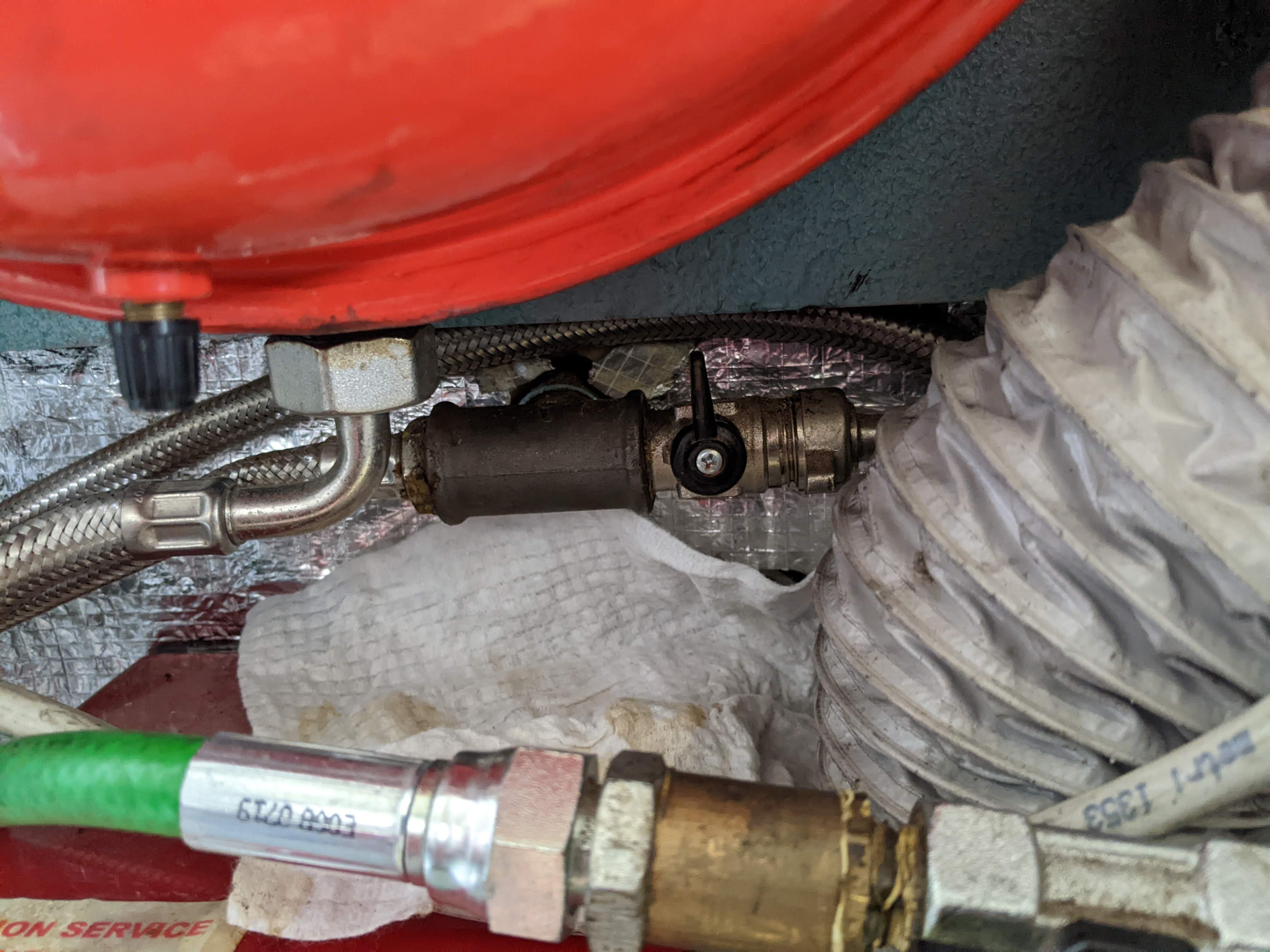

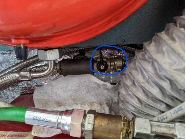

Furnace Posted January 17, 2023 Author Share Posted January 17, 2023 Final question for the panel... The isolating valve for the filling loop circled in blue has a weep emanating from the valve actuating shaft that keys on to the black handle. I've positioned it so that there is currently no leak, but I'd prefer to replace it so there's peace of mind. Is there a particular type that is required because it's in a hostile, high temperature environment? The supplied Grant version is about £20 which appears a bit steep? I'll need to drain down the system in order to replace it.😔 Link to comment Share on other sites More sharing options...
PeterW Posted January 17, 2023 Share Posted January 17, 2023 Weep will probably disappear when the boiler is properly back to temperature as it’s screwed into the iron tee on the tank. You “can” change them but they are a b#tch to align and are usually put in with Jet Blue or similar so they don’t need to bed down to create a seal. Link to comment Share on other sites More sharing options...
Furnace Posted January 18, 2023 Author Share Posted January 18, 2023 10 hours ago, PeterW said: Weep will probably disappear when the boiler is properly back to temperature as it’s screwed into the iron tee on the tank. You “can” change them but they are a b#tch to align and are usually put in with Jet Blue or similar so they don’t need to bed down to create a seal. Thanks so much Peter. I don't fancy wrestling the old one out, nor aligning the new one so I'll keep an eye on any weeping but leave it be for the moment. Thankfully the EV change has resolved the heating issue and my elderly parents are now reclining at 21degC rather than 16. Thanks to all who contributed Mark 1 Link to comment Share on other sites More sharing options...
