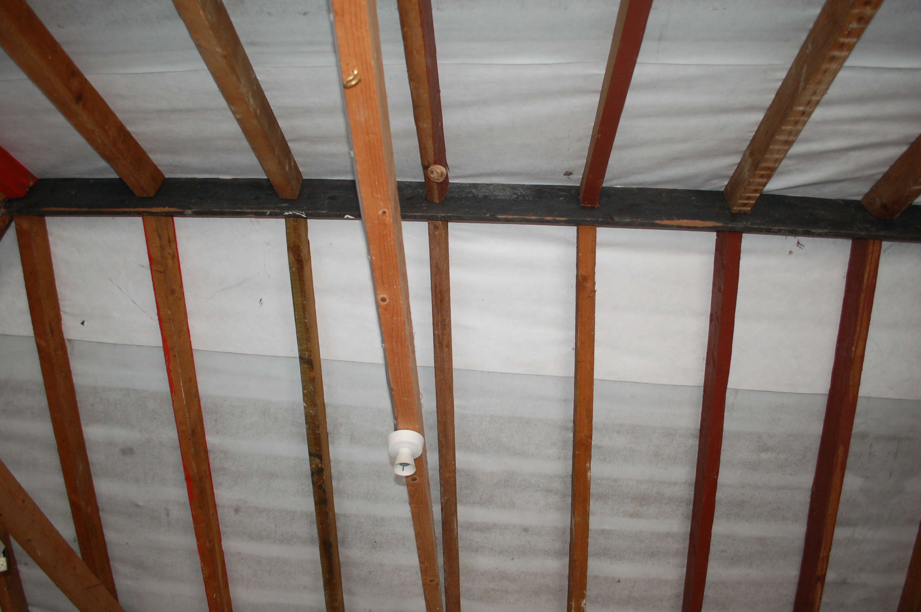

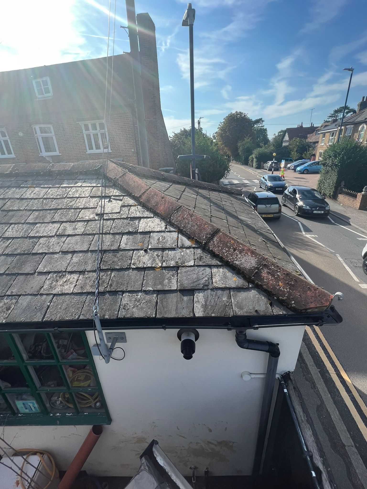

tvrulesme Posted January 15, 2023 Posted January 15, 2023 We are looking to convert our detached garage into living accomodation. It's part of a Grade II listed building so maintaining the exterior appearance is very important. The current structure is timber rafters, membrane and natural slate. Plan is to deepen the rafters by attaching 50mm timber battens and insulate between and below the rafters with PIR leaving a 50mm ventilation gap. I have wide soffits which I can use to provide an inlet for ventilation but I am wondering how I can provide an exhuast at the ridge without altering the external appearance (which means that ridge vents are out of the picture). Any ideas greatly appreciated.

tvrulesme Posted January 15, 2023 Author Posted January 15, 2023 9 minutes ago, nod said: A Simple solution is to remove the ridge tiles and mortar and redux with a dry ridge system Thanks a lot. Looks interesting but... can I reuse existing ridge tiles and would this increase the height of the main ridge at all? Both of these would be deal breakers for the conservation officer. Seem to be the constant mediator between the Conservation Officer who doesn't give a damn about building control and building control who don't give a damn about listed building requirements...
PeterW Posted January 15, 2023 Posted January 15, 2023 1 hour ago, tvrulesme said: can I reuse existing ridge tiles and would this increase the height of the main ridge at all? Both of these would be deal breakers for the conservation officer. OK so the dry ridge will be slightly lower / same height as mortared ridge tiles however you do need someone to install it correctly. Those ridge tiles could be reused however if they are crock full of mortar you may crack them removing it so worth getting some spares anyway. Looks like you’ve got a couple of slipped slates too so you may have to do some rework on that roof. Is the membrane breathable that has been installed ..?? Makes me laugh though that the conservation idiot is worried about ridge tiles yet is happy with UPVC guttering ….. they really are a strange breed !!
nod Posted January 15, 2023 Posted January 15, 2023 2 hours ago, tvrulesme said: Thanks a lot. Looks interesting but... can I reuse existing ridge tiles and would this increase the height of the main ridge at all? Both of these would be deal breakers for the conservation officer. Seem to be the constant mediator between the Conservation Officer who doesn't give a damn about building control and building control who don't give a damn about listed building requirements... yes you can 1
Temp Posted January 15, 2023 Posted January 15, 2023 If you have the height (propably not?) then put insulation at ceiling height rather than between rafters?
Redbeard Posted January 15, 2023 Posted January 15, 2023 Eaves-to-eaves ventilation works for a huge number of roofs, but it may not work for your BCO... My house has no ridge ventiulation and no moisture issues (well, not in the roof....) 1
tvrulesme Posted January 15, 2023 Author Posted January 15, 2023 24 minutes ago, Temp said: If you have the height (propably not?) then put insulation at ceiling height rather than between rafters? Thank you. I have the height but really really like vaulted/cathedral ceilings
tvrulesme Posted January 15, 2023 Author Posted January 15, 2023 1 hour ago, PeterW said: OK so the dry ridge will be slightly lower / same height as mortared ridge tiles however you do need someone to install it correctly. Those ridge tiles could be reused however if they are crock full of mortar you may crack them removing it so worth getting some spares anyway. Looks like you’ve got a couple of slipped slates too so you may have to do some rework on that roof. Is the membrane breathable that has been installed ..?? Makes me laugh though that the conservation idiot is worried about ridge tiles yet is happy with UPVC guttering ….. they really are a strange breed !! Yes it's a breathable membrane. Looks pretty recent suprisingly. Tell me about it. There are so many things that suprise me in what they will allow and what they wont.
Redbeard Posted January 15, 2023 Posted January 15, 2023 If the ridge height is really a problem could you have a mainly-vaulted ceiling with just a tiny dropped area at the apex to allow an air-passage/'plenum chamber'? 1

tvrulesme Posted January 15, 2023 Author Posted January 15, 2023 13 minutes ago, Redbeard said: If the ridge height is really a problem could you have a mainly-vaulted ceiling with just a tiny dropped area at the apex to allow an air-passage/'plenum chamber'? Fantastic idea. I hadn’t thought of this.

PeterW Posted January 15, 2023 Posted January 15, 2023 TBH if I was putting additional load on those rafters I would be putting in collar ties and then you get the semi vaulted ceiling by design. You’ll need minimum 100mm between and 35mm over to get close to building regs and may then get away with replacing one or two slates on the hip end with nice lead vents - one at the hip and one high up at the far end should allow airflow and keep BCO satisfied https://www.leadworx.co.uk/shop/lead-roof-vents/lead-flat-top-roof-vents These guys make some lovely stuff..!! Should be a conservation idiots wet dream … 1
