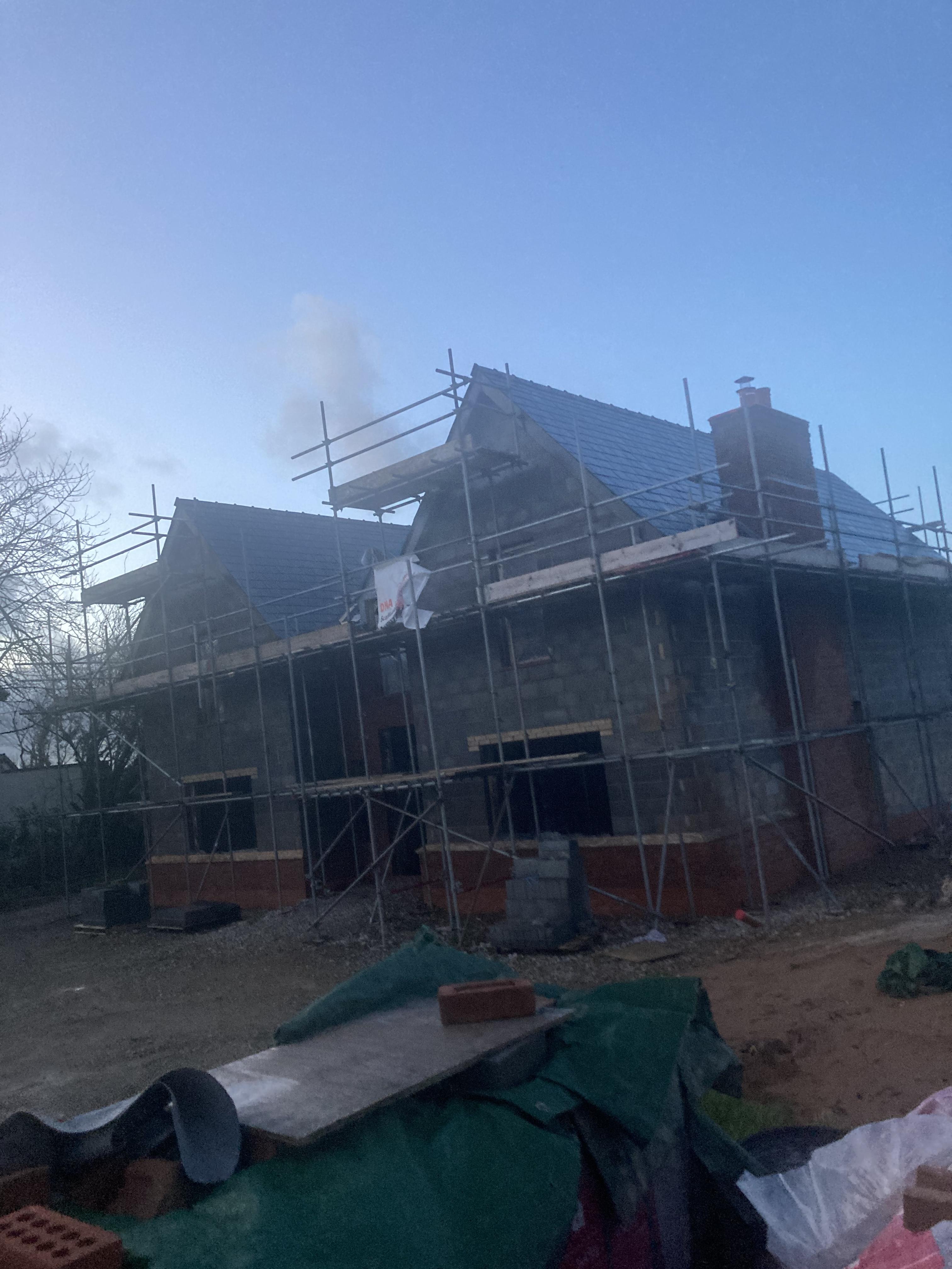

nod Posted January 14, 2023 Posted January 14, 2023 Three months on since I started the main house roof Lots of design issues that simply didn’t transfer to reality I expected to birds mouth every truss and new there would be a lot of work in the valleys to carry the 60 meters of lead But I didn’t anticipate the time it would take with the loose rafters and making the two dormer windows up Deborah and myself are chipping away at the slating Lots of cuts But mostly the weather has slowed things down Lead on the two dormers and chimney to finish and about 1200 slates still yo do 4500 already used There’s 1200 to lay on two lower roofs But can’t put the roof on till the roughcast render is done Our son has offered to give me lift with rendering the workshop and house Two days scratch and mesh coat three days top coating That’s dry days 😁 I wonder how many of us have said if only we were a couple of months earlier in starting

nod Posted January 14, 2023 Author Posted January 14, 2023 45 minutes ago, dpmiller said: chimney looks very low? 7000 +600
MJNewton Posted January 14, 2023 Posted January 14, 2023 (edited) It does look a little on the low side, compared to the roof slope. Optical illusion perhaps given the camera angle? The flue vent should be at least 1m above the roof surface and 2.3m measured horizontally. Edited January 14, 2023 by MJNewton Better wording (I think!)
nod Posted January 14, 2023 Author Posted January 14, 2023 1 hour ago, MJNewton said: It does look a little on the low side, compared to the roof slope. Optical illusion perhaps given the camera angle? The flue vent should be at least 1m above the roof surface and 2.3m measured horizontally. Yes it is a bit of an odd angle The ridge is actually 7 meters from the back of the chimney Though doesn’t look it in the photo I had a 2 meter lift on the scaffolding Which was ok for Building off But my 6”5 frame would stretch to put the Cowell on so I had to climb on the stack
MJNewton Posted January 15, 2023 Posted January 15, 2023 2 hours ago, nod said: Yes it is a bit of an odd angle The ridge is actually 7 meters from the back of the chimney The measurement isn’t taken from the ridge, it’s the point at which a horizontal line from the flue outlet (centre of) hits the roof surface. It’s a bit late for me to do some mental trigonometry but I guess if the ridge is 7m away then the point of interest on the slope is likely beyond the minimum required. 1
