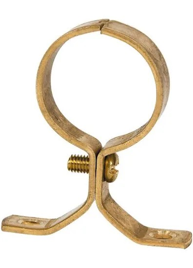

PeterW Posted January 14, 2023 Share Posted January 14, 2023 Use Munsen Rings as you can slot them behind the pipe then add the top ring Link to comment Share on other sites More sharing options...

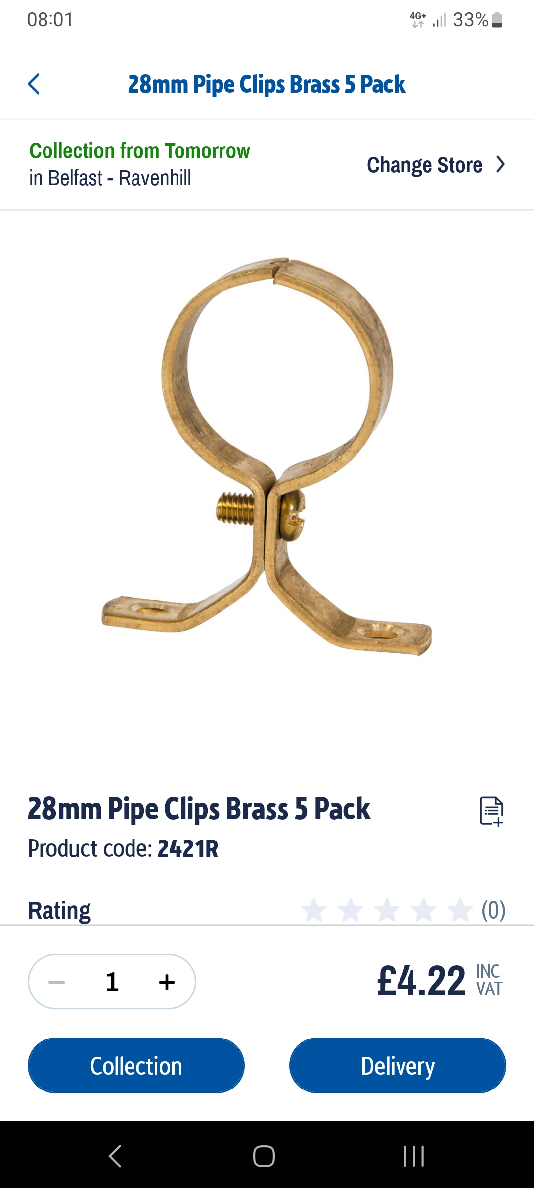

Conor Posted January 14, 2023 Share Posted January 14, 2023 Plenty of choices on Screwfix. How far from the wall is the pipe? If there is a decent gap, you can fit a clip /munsen ring to a small piece of 12mm ply, slide in behind the pipe then screw in either side of the pipe. Had to do that on a few of my ventilation ducts after they were fitte and I realised they weren't supported enough. But with this one it should be easy enough to fit to the pipe insitu and screw directly to the wall. Link to comment Share on other sites More sharing options...
