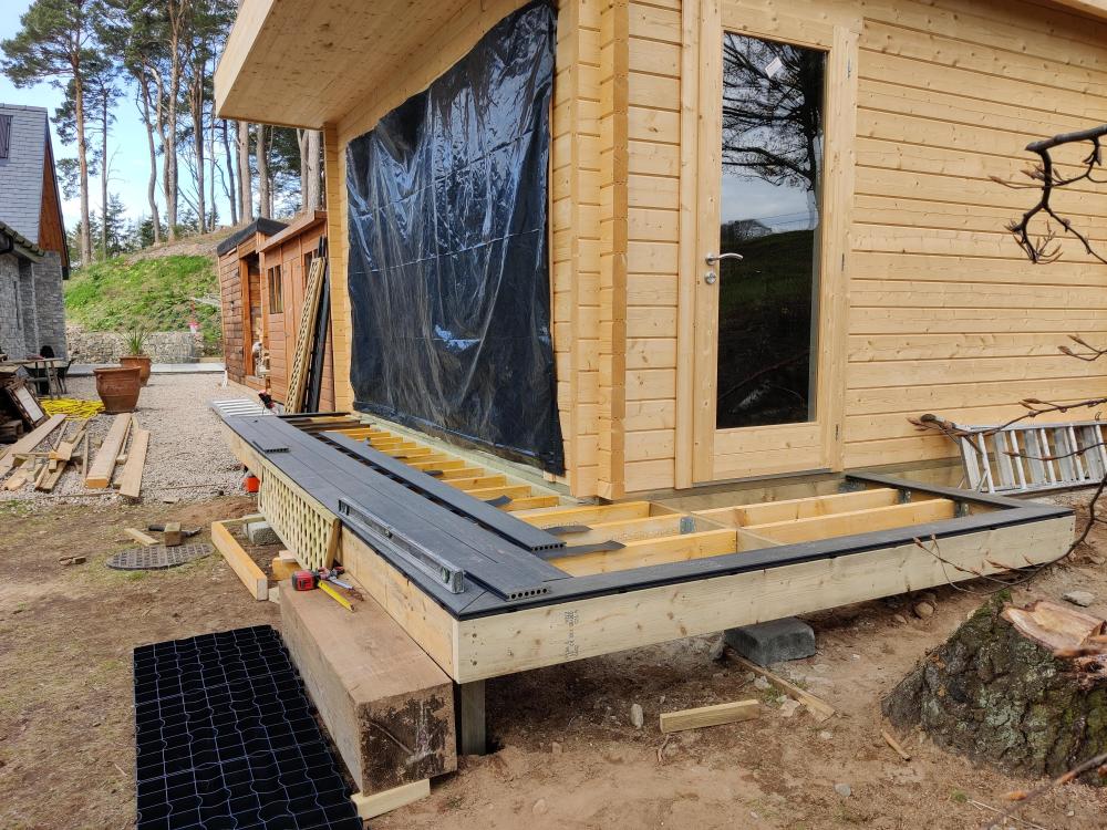

  • Some progress today before the rain.
  • Update Walls insulated with 90mm Frametherm 32, vapour barrier, and then plasterboarded. Due to be taped on Monday.   Expansion gap at top of wall, is to allow roof to move up and down

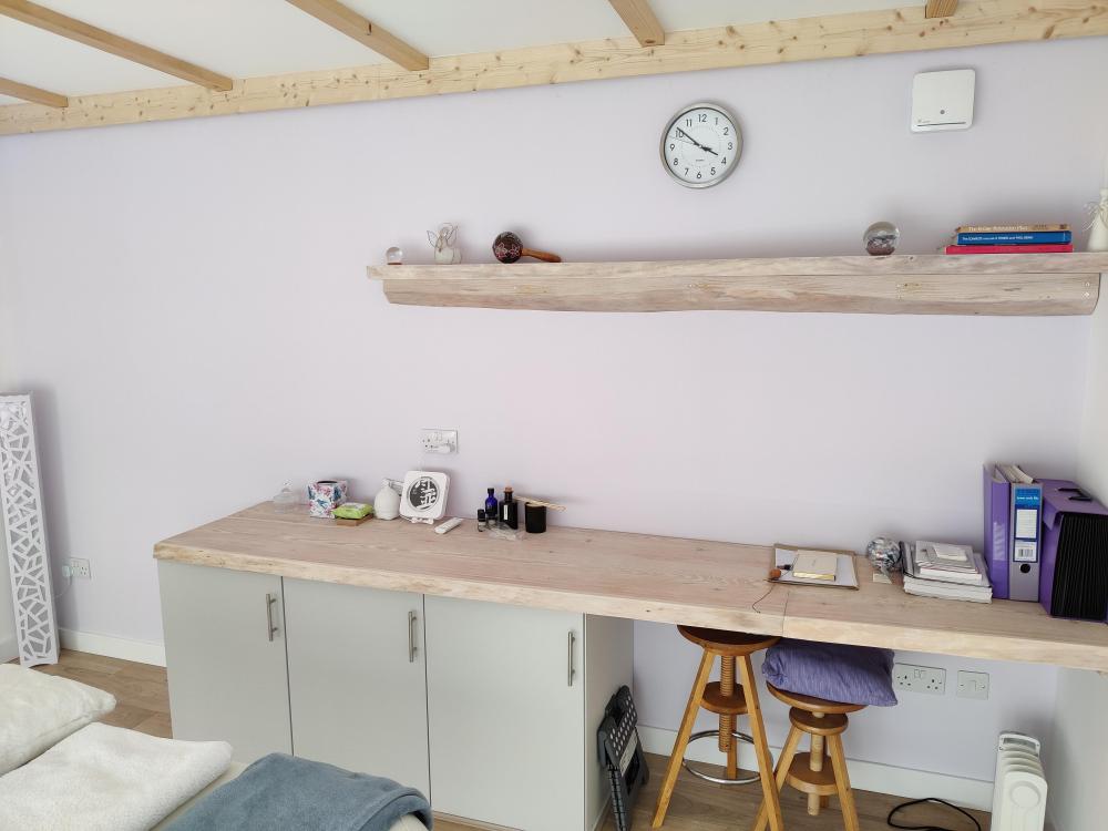

  • Work surface which is 3.5m long and the shelf are made from a tree we took down (Scottish larch) and we had it cut into planks.  Work surface is made from 4 pieces cut, biscuit jointed and glued.  Bot

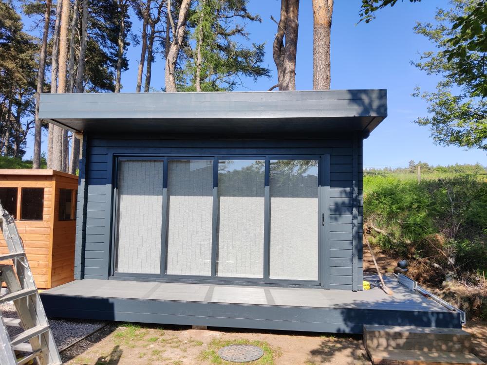

Still all fine. The only issue is the sliding doors, leak like a seize.

The kit was pretty easy overall, the additional insulation added a bit of complexity but it's very solid, pretty much keeps noise out, so quite overall. Only downside is overall airtightness. Better sliding doors would help. But at the end of the day with the dMEV fan ticking over, it's humidity stays nice and low.
Heating - doing it again I would do a through wall Aircon unit for heat and cool, instead of tying into the house.
The experimenter in me, would do a Larson strut if doing it again.
