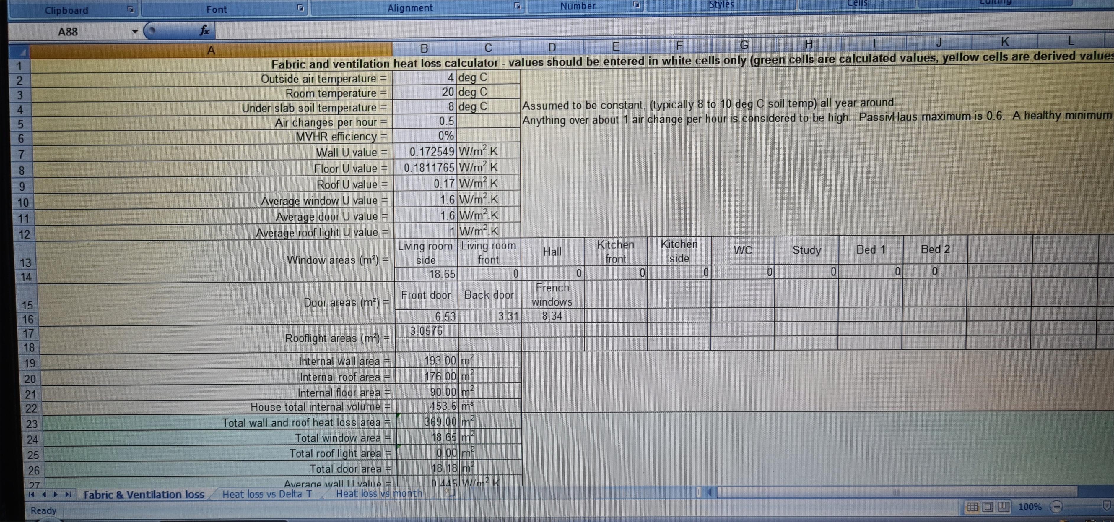

Barnboy Posted March 29, 2024 Author Share Posted March 29, 2024 I still haven't managed to get to the stage of ordering anything UFH wise yet but have been going over and over this in my head. I've got 140mm of Insulation below my already laid 65mm screed, this gives me a u value of 0.18W/m²k. Using Jeremy's heat loss calculator and some off the top of my head figures I get a total heat loss of 3268W with a floor area of 90m². If I understand this correctly and have filled everything in correctly I work it to equate to about 36w/m² of ufh being required??? If I was to opt for the Variotherm gypsum panel, this in my thoughts would basically act as part of the screed but with the pipes 65mm upwards of the insulation and about 45/63mm below my ffl. Would the insulation u value and depth compared to the pipework allow this system to work to a decent standard or would there (A) not be enough insulation (B) the height of the pipes in the build up not allow the slab to work as a thermal mass well enough ? I've read on here of people having their pipework midway up there slab and also having 100 -120mm of slab with ufh. Any inputs to help my understanding before I loose anymore sleep and hair over this. Thanks Link to comment Share on other sites More sharing options...
JohnMo Posted March 29, 2024 Share Posted March 29, 2024 Are you certain you have filled the spreadsheet in correctly? Sound a huge heat loss for 90m2. What air change figure have you use? Link to comment Share on other sites More sharing options...
SteamyTea Posted March 30, 2024 Share Posted March 30, 2024 4 hours ago, Barnboy said: u value of 0.18W/m²k. Using Jeremy's heat loss calculator and some off the top of my head figures I get a total heat loss of 3268W with a floor area of 90m² 0.18 [W.m-2.K-1] x 90 [m2] x 20 [ΔT] = 324 W Have you got a factor of ten error somewhere? (I know that is just the floor, but it is to highlight the possibility of an error) Link to comment Share on other sites More sharing options...
Barnboy Posted March 30, 2024 Author Share Posted March 30, 2024 These are my inputs, I need to measure the walls and windows etc accurately and just went from memory last night, but I don't think that I'm far out with those. I can't find anything relating to air changes in any of the architects paperwork ( He pretty much abandoned me when I said I was going to self build) everything is taped and sealed as best as I can do it so I'm pretty sure it's well done, a sparky mate who's on sites everyday keeps telling me that I've gone ott with my membranes and taping. Link to comment Share on other sites More sharing options...
JohnMo Posted March 30, 2024 Share Posted March 30, 2024 It's unlikely you will have 0.5 ACH unless you are running MVHR, if that's the case add 90% in MVHR efficiency. If not MVHR how are you ventilating? What is your target airtightness? Link to comment Share on other sites More sharing options...
