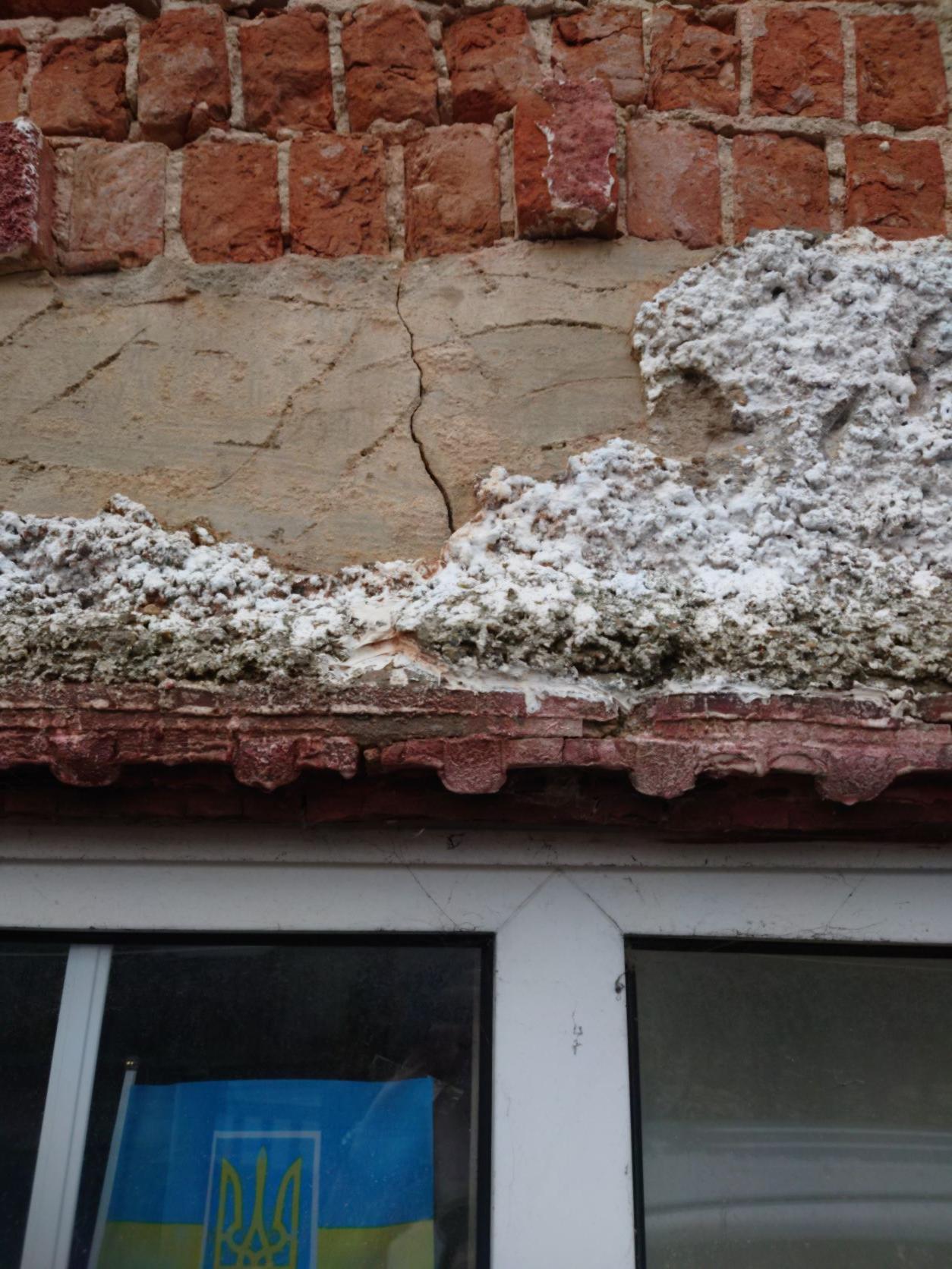

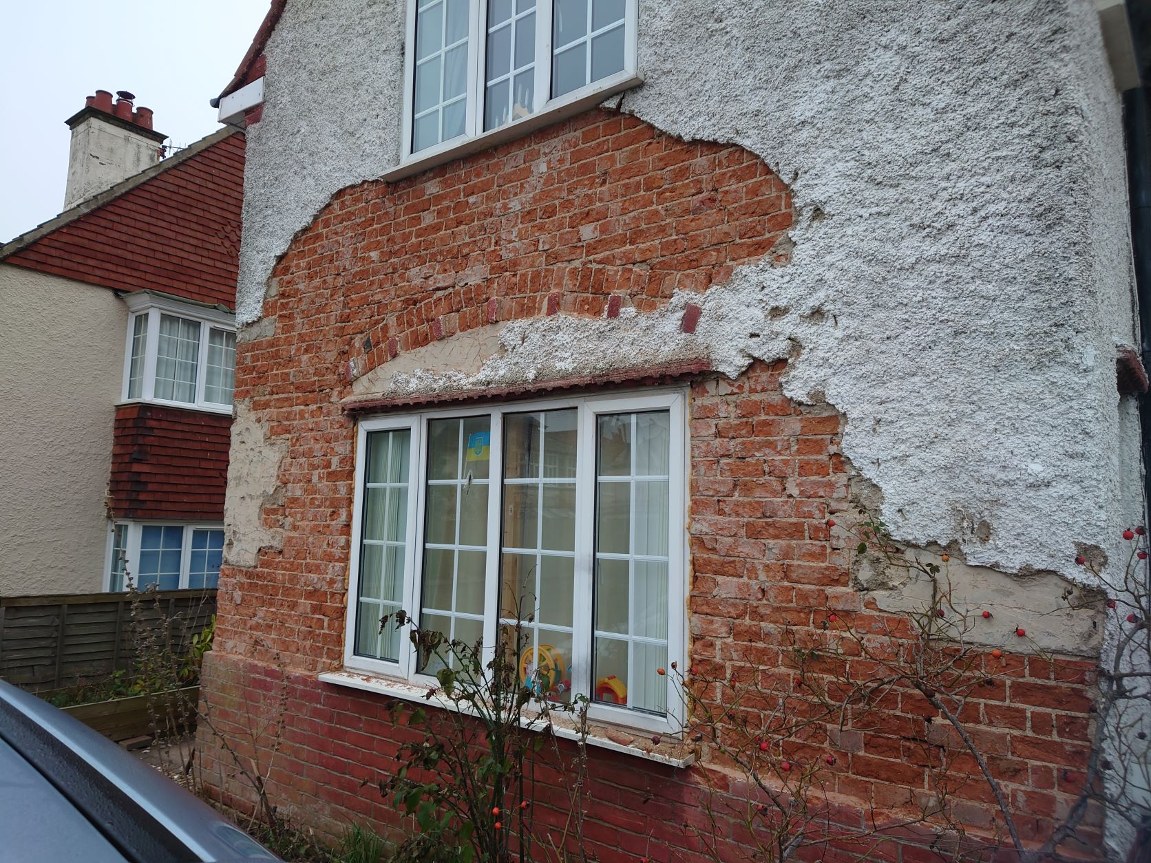

So we have had a problem with penetrating damp. Solid walls, cement render. So I have hacked off some of the render (well, quite a lot of the render!) and that has solved the damp problem. Hurrah.
Of course, one issue is that all the bricks are spalled... and I need to put back some kind of breathable render on the top... but my main question is about my lintel, I don't understand it.
So I have an arch, with concrete infill underneath - I'd always presumed a steel lintel was in there as well, but I actually have no idea.
The concern is that the lintel has cracked in the middle, I gather/presume from replacement of original frames with uPVC windows. But the uPVC windows have been there a long time and the wall hasn't fallen down.  You can see the vertical cracking either side of the frame and there was historically on the inside evidence of a vertical crack underneath the middle of the window. We filled that in several years ago and it's not reappeared, so I am working on the assumption that it hasn't moved/cracked any further.
The crack is at least 45mm deep having poked a bit of earth wire in it. Extends perhaps 3mm across at widest point.
It's a gable end wall, but the 1st floor joists are sitting on this wall so it is taking some weight.
Above the first floor window there's also looks evidence of an arch but the lintel is timber, and, from having looked at this from the inside of the house (when putting up woodfibre boards) in good condition.
It's a 1920s house. Dwarf cavity walls with solid walls on top.
Have people come across this sort of lintel arrangement before?  And do I just ignore it or should I get some work done to strengthen it? I've had one company indicate they could reinforce with helical bars which sounds great but I've got no experience of this.
Any easy way to work out if there is a steel in there without hacking back the concrete? (I've tried poking a tiny magnet in to see if it magically got picked up - no dice)

Just looks like mortar infil to me - the arch is doing all the work there by the looks of it.
If you’re handy with a grinder and have a decent scaffold to work from then you could helibar it yourself using one of the kits - it’s basically 30mm deep cuts with 6mm twist bars and then epoxy grout inserted into the cracks. That will stop it moving any more and you can always drill and inject epoxy mortar into the crack too.

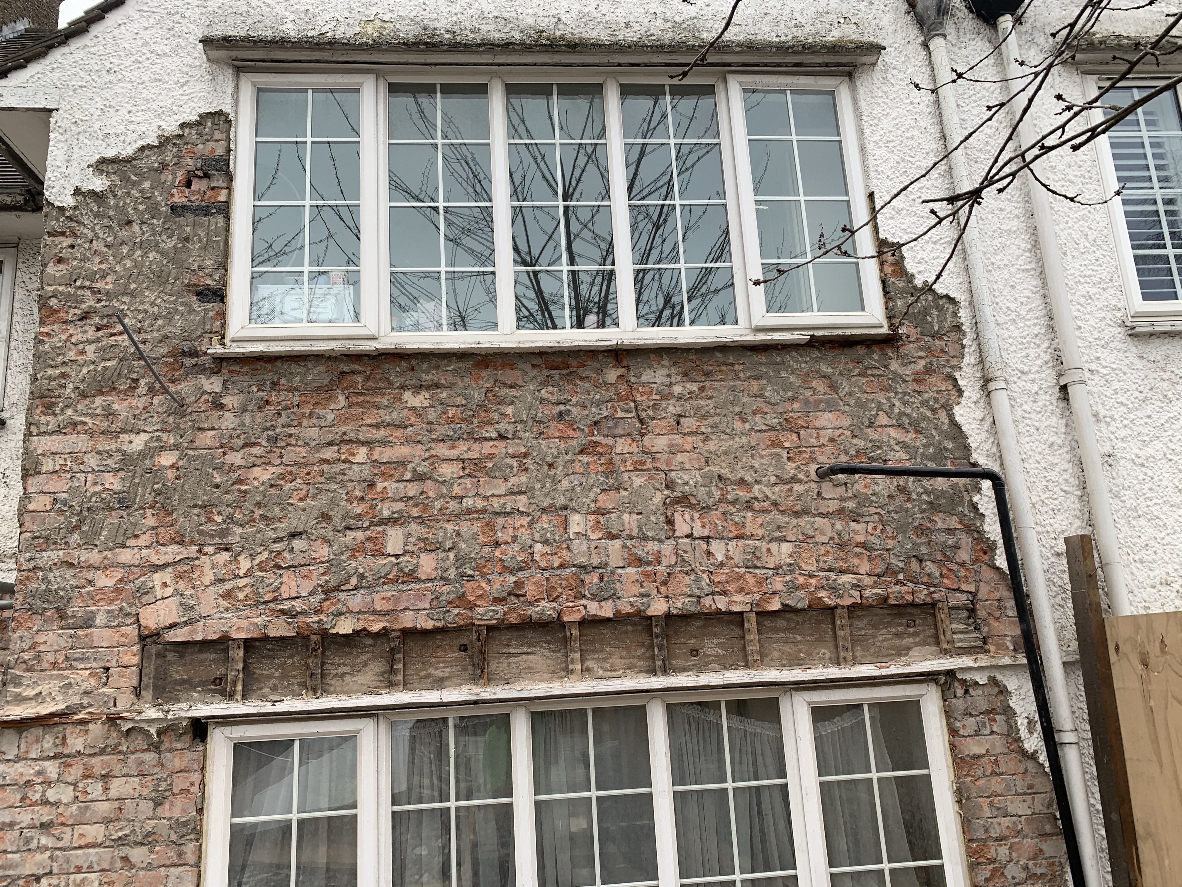

I discovered something similar after we removed the pebbledash from our 1930s semi in preparation for upgrading the thickness of the wall with insulation and render (part of the pebbledash was also damp):
if you zoom in, you will see there is cracking above the wooden (!) lintel. My SE recommended we use helifix to stitch the cracked bricks together. In your case, maybe you can do something similar.
Well, at least the wooden lintel made it easy to fix curtain poles?!!
Goodness, yours does look very similar indeed.  Similar windows too!!
Did you go for the Helifix in the end? And what did you end up doing to the rest of the wall?

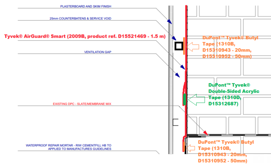

We did the helifix helibar stitching to the bricks and then grouted as recommended by the SE.
For the wall upgrade we had to tackle damp under the ground floor window. A RICS surveyor designed a solution for us with assistance from the Dupont technical dept. This is basically what we did:
It allowed the wall to dry from the inside, whilst staying impermeable to the elements on the outside. Outside was:

A shallow arch like that is unlikely to be the main load bearing element - as in the SE's email, much more likely to be a relieving arch. That is, a shallow arch working in combination with a beam below. The beam can be made smaller thanks to the arch distributing the load away from the centre of the beam.
The infill appears to be mortar. I would chip a bit away and see if there is a beam still there. The mortar may have led to timber rot, or some other remediation work was done in the past already.
Crack stitching I agree with - on jobs I default to 'manufacturer's recommendations' but I have had some success on my own buildings with bedding the stainless steel rods in lime mortar. I figure it doesn't create such a hard spot and is more akin to new-build bed joint reinforcement rather than using the 100% rigidity of the resin. However... this would be 'at risk' and I hope one day helifix will do research on this approach.

Re the infill - it's a LOT harder than the mortar used around the bricks, and to me seems similar to the Quoins that I've uncovered around the edges of the wall.
Sounds like though the key thing is to work out whether there is a anything within the infill or not given the views so far. I have to say I'm a little bit worried to go at this heavy with an SDS drill to try to find out but maybe I need to drill a few holes this weekend and see what I hit...

Although it's not a close up, it looks like trowel marks in the infill, which would suggest it's mortar. A 3:! mix can be nearly as strong as stone!
I'd get a masonry hammer (wear safety glasses) to chip away rather than an SDS.

Just to update/bring this full circle. I managed to find a local builder who uses "Thor" Helical bars and they have (I hope) sorted this with two long helical bars above the whole window and eight separate bits coming up through the arch. Felt I'd reached the limit of what I was comfortable doing myself and pleased/reassured we've had it done. Next job working out what we put on top. Hugely appreciate the advice on here.
