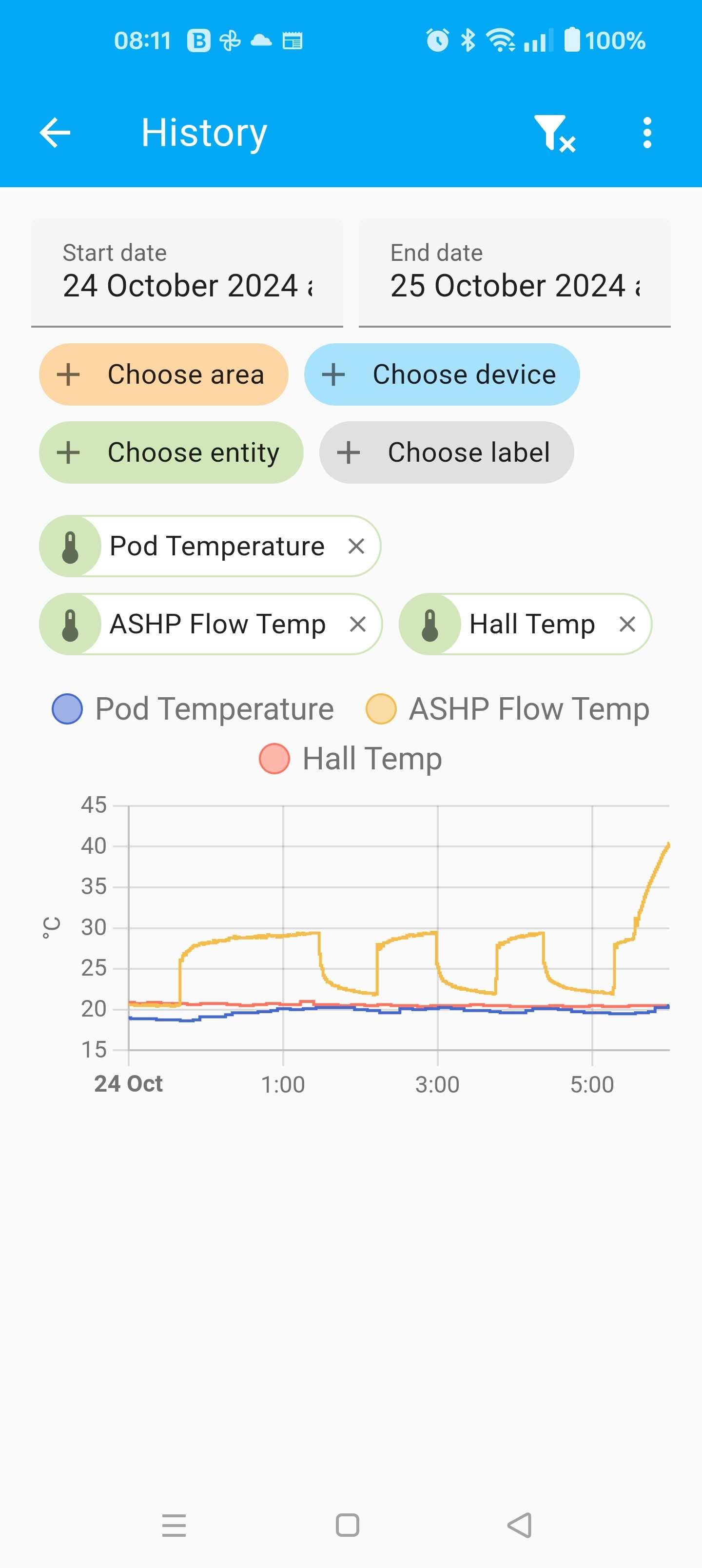

ringi Posted October 24, 2024 Posted October 24, 2024 (edited) Remember with large thermal mass UFH the thermal mass behaves as a buffer so it as if the UFH contained a lot more water then it does. So cycling of heatpumps that have directly connected always open UFH will be less of an issue then with radiators. Personally I would use fan converter radiators upstairs rather then having a mixer/pump to reduce UFH flow temperature so the complete system runs at the same flow temperature with a single pump. Use the flow temperature to control the heat output from the UFH, with balancing flow rates to control individual rooms and the thermostat controled fans on upstairs fan convectors to control bedroom temperature. Edited October 24, 2024 by ringi
JohnMo Posted October 25, 2024 Posted October 25, 2024 8 hours ago, ringi said: Personally I would use fan converter radiators upstairs rather then having a mixer/pump to reduce UFH flow temperature so the complete system runs at the same flow temperature with a single pump. Use the flow temperature to control the heat output from the UFH, with balancing flow rates to control individual rooms and the thermostat controled fans on upstairs fan convectors to control bedroom temperature. An example of how it looks, we have a fan coil in a heated summer house, with very different heating and heat loss profile to the house. Flow one flow temp, no mixers. This is overnight, orange line is the supply temp from the heat pump. The other two lines are temperature in the house and summer house. Outside temp dropped to 5 degs. The spike in the orange is starting to do DHW.
