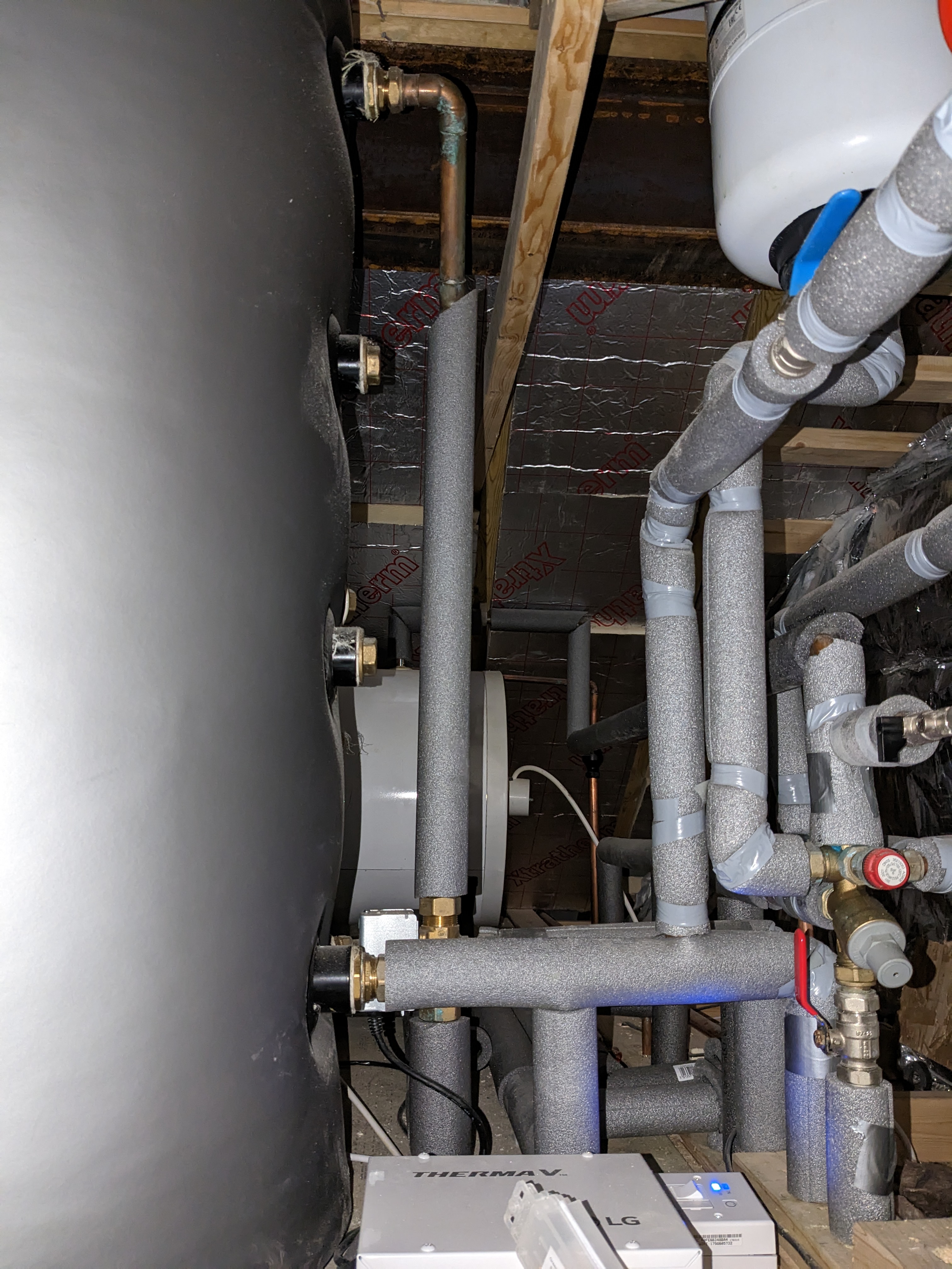

markocosic Posted March 7, 2023 Share Posted March 7, 2023 A 16 kW OUTPUT heat pump will never draw 16 kW electrical input. I'm surprised that you're seeing 10-12 kW during DHW production. Are you running an immersion at all? If the heat pump is not reaching the design output in space heading mode I would be looking at what the system flow rates are. Primaries to top up that buffet vessel that all is fed off may be too small. If you're using a time clock for the heat pump then stop. The poor thing will not be able to keep up with the buffer vessel demand because you're sucking it dry by trying to reheat a giant concrete slab from cold each time. I would ditch all mixers; set the maximum heat pump flow temperature to the maximum that your floor can dissipate without damaging it (e.g 35C); set the weather compensation on the heat pump so that flow temperature reduces to say 23C at 15C external; and allow it to run 24/7. A 16 kW unit won't work with a 13 kW design heat loss if you're trying to run only a couple of hours a day. It's not crazy to try to do that and to rely on charging a big slab on the cheap rate electricity; but it will only work if your best losses are low enough that the slab can keep the whole house warm (yours is to unbalanced) and if your heat pump is oversized enough to deliver 13*24hrs of heat in say 8 hours. 1ph 16 kW > 3ph 40 kW would be needed to do that. Link to comment Share on other sites More sharing options...
ReedRichards Posted March 7, 2023 Share Posted March 7, 2023 48 minutes ago, markocosic said: If you're using a time clock for the heat pump then stop. The poor thing will not be able to keep up with the buffer vessel demand because you're sucking it dry by trying to reheat a giant concrete slab from cold each time. On 16/12/2022 at 14:28, Rupe30 said: We have underfloor heating but only a thin layer of screed (6mm I believe) so the temps need to be fairly high to get any heat into the rooms. Doesn't "a thin layer of screed" indicate that @Rupe30is not trying to heat a giant concrete slab but actually quite a small one? Link to comment Share on other sites More sharing options...

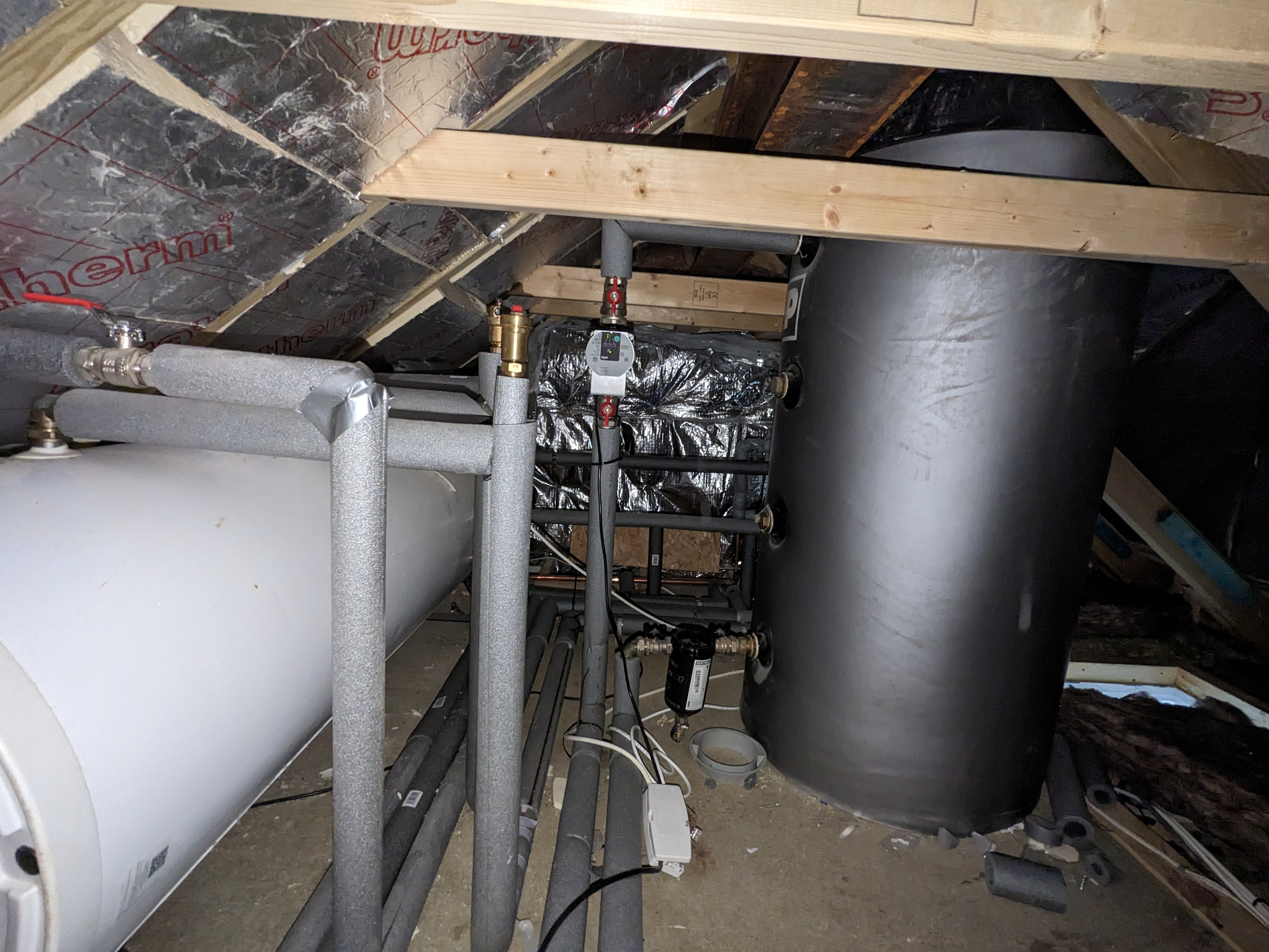

markocosic Posted March 7, 2023 Share Posted March 7, 2023 My read: Downstairs is a hulking great slab that's rinsing the buffer vessel. Upstairs has almost nothing. Link to comment Share on other sites More sharing options...
Rupe30 Posted March 7, 2023 Author Share Posted March 7, 2023 Yes it's when downstairs comes on that the flow rate drops and doesn't recover. The odd thing is downstairs doesn't take long to heat up so I'm surprised it's cooling the buffer tank down so much. Today downstairs was up to temp within an hour, my thermostats do keep heating on for a while even when target temp has been reached, so I've turned the thermostats off manually to allow upstairs to get to 50 which will allow it to heat. If I set the whole system to 35 upstairs will lose too much temperature, where as downstairs would probably be fine at that. Would turning the mixer down on the downstairs manifold take any pressure off the buffer tank? I basically can't heat upstairs and downstairs at the same time. Perhaps I should heat downstairs 24/7 on low flow temp then switch downstairs off and just in heat upstairs at a higher flow temp during the cheap rate hours. Although in I don't think I can't schedule flow temp changes on my LG controller. couple pictures below to see inputs and outputs into buffer tank. Link to comment Share on other sites More sharing options...

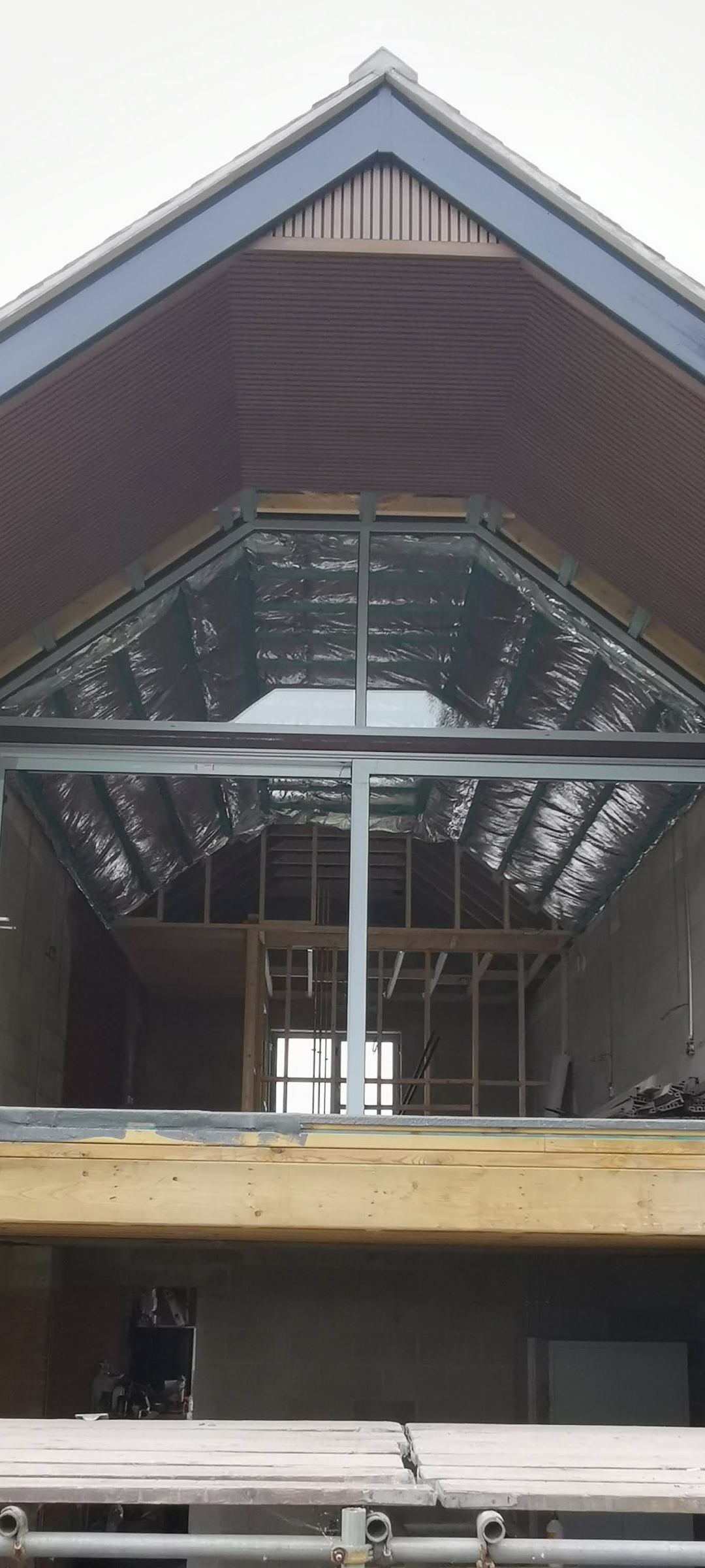

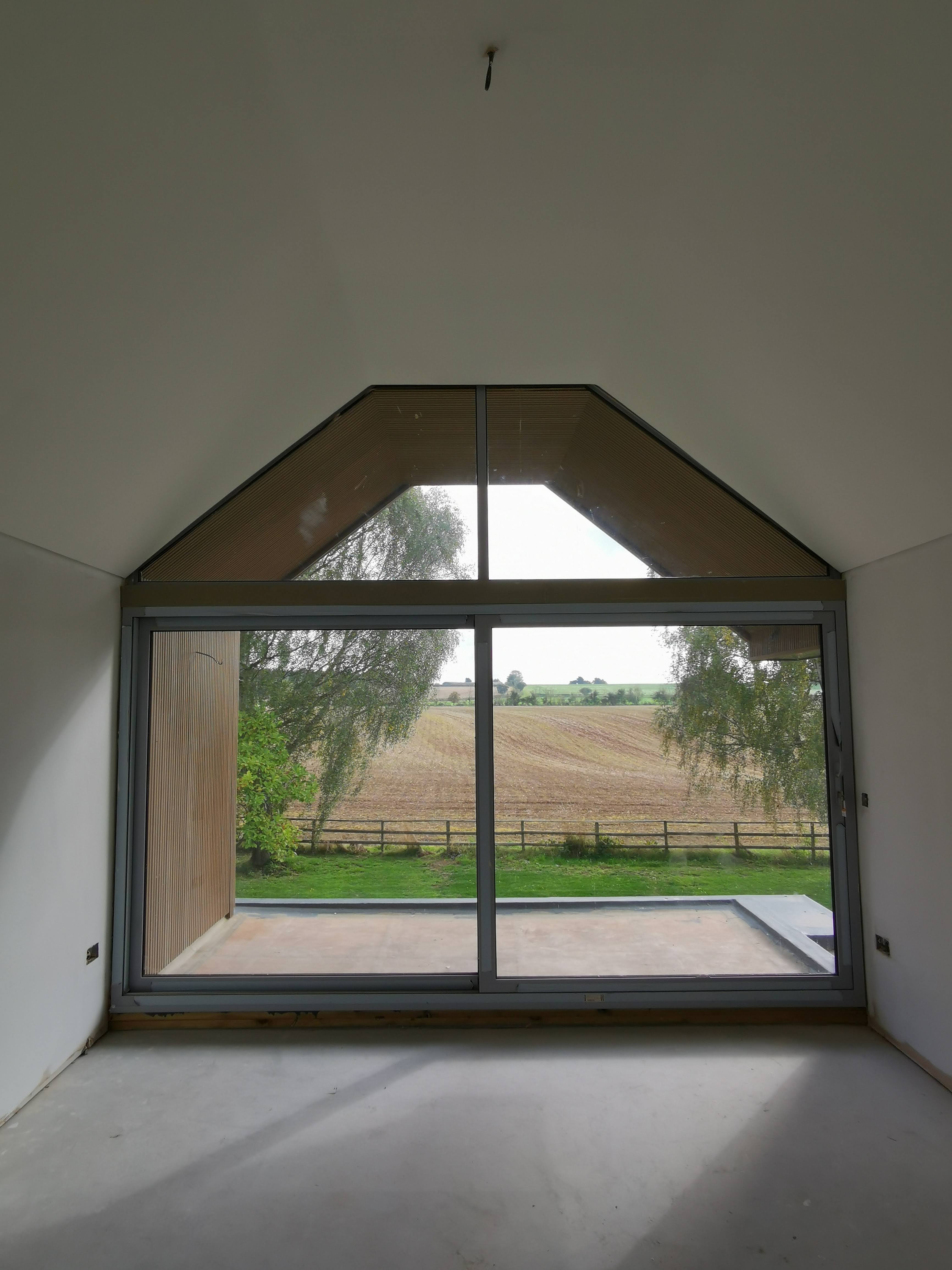

Rupe30 Posted March 7, 2023 Author Share Posted March 7, 2023 Thanks @markocosic really useful info. The attic space pictured is really poorly insulated. The rest is done properly with superquilt over the top, Shame they didn't just carry this insulation on into the attic but at the time it was just going to be empty attic space. The glass gable has a pretty hefty heat loss though which is a little tricky to get around. I used to run the heating 24/7, tried a few weather compensation modes, but our landing and master bedroom (pictured) would lose temperature. I have recently had cavity wall insulation pumped in the landing wall and external wall insulation put on the majority of the house. I've also insulated the ceiling of the master bedroom which links to the poorly insulated attic. So I'm going to try again with the weather comp mode with the settings mentioned previously. I've set the thermostats to stay at one temperature so we'll see in the morning if the landing and master have been able to hold temp. If not I'll increase the weather comp temperatures and turn the mixer down on downstairs' manifold and go from there. The system was designed by the company that did our thermodynamic report, which was organised by the company that installed our heatpump (who are no longer in business). It was designed to operate at 50 degrees flow temp which I now realise is a poor design. Link to comment Share on other sites More sharing options...
