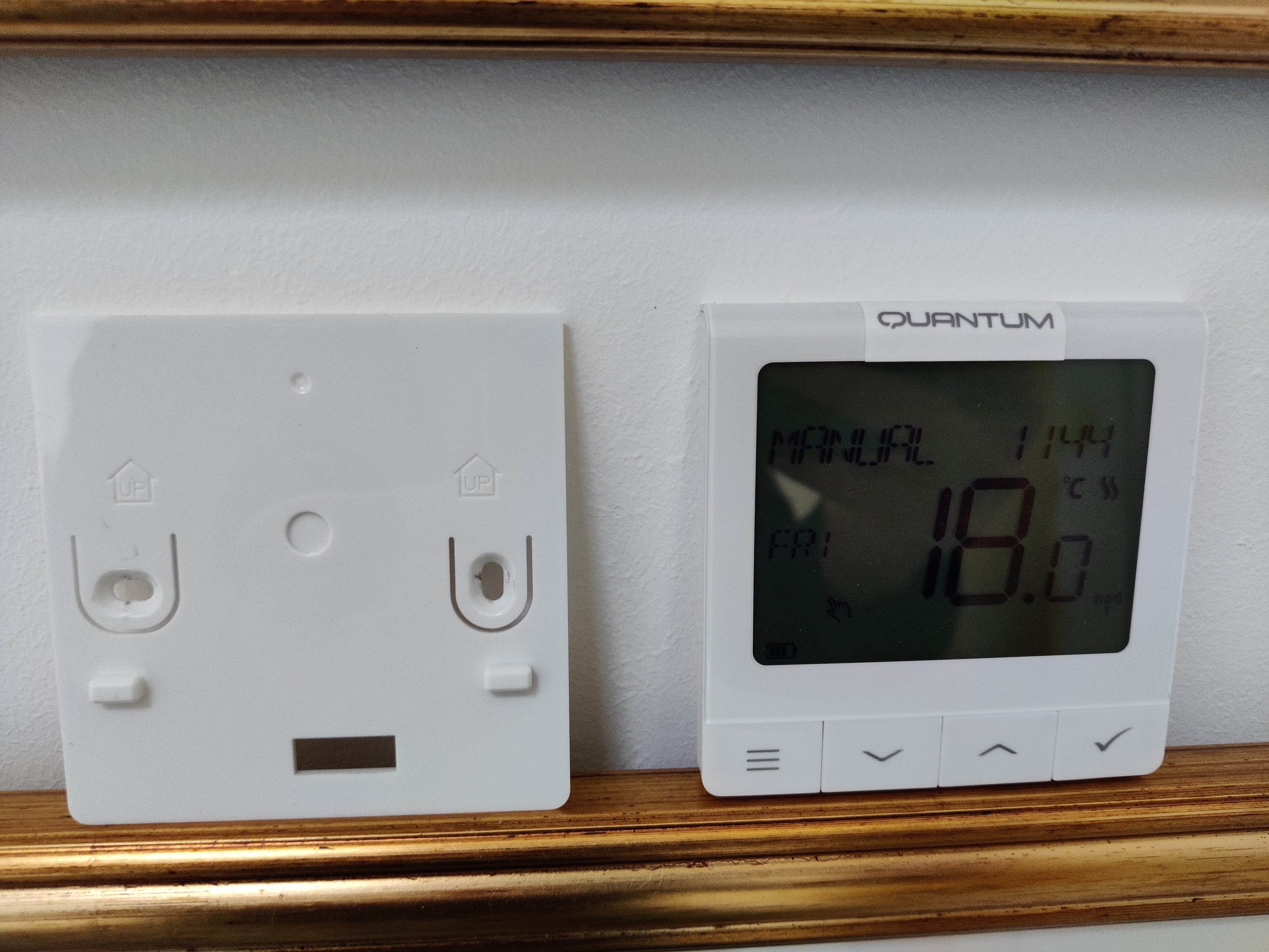

These are the best I've seen for hysterisis.
Q7RF-Manual-EN.pdf
