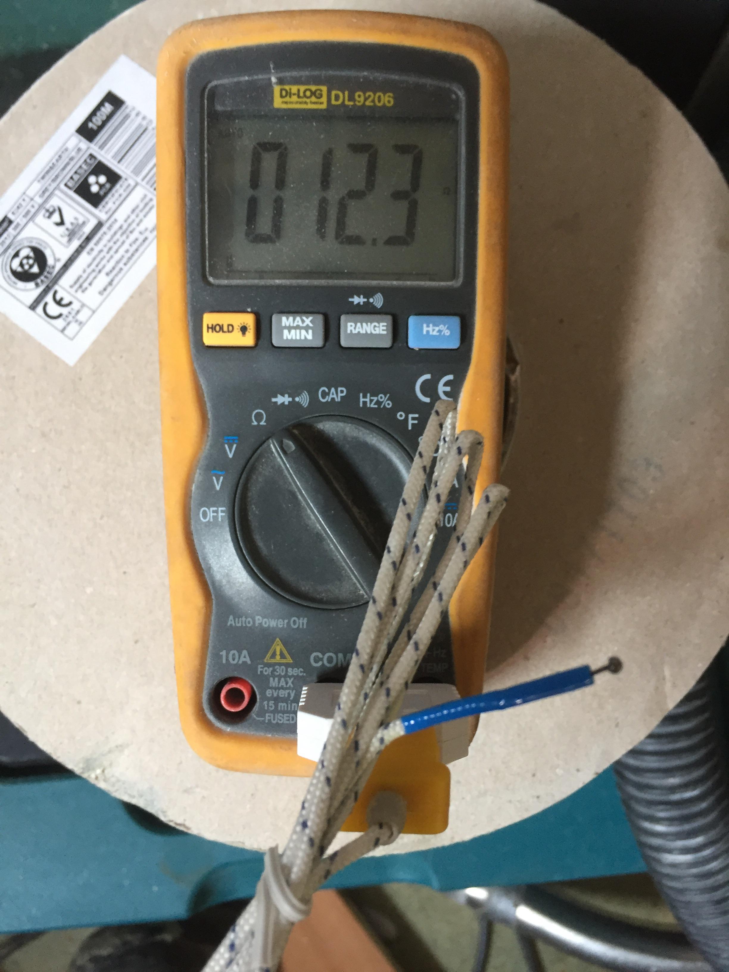

Nickfromwales Posted July 7, 2017 Author Posted July 7, 2017 What about the thermistor that's in with my multimeter for the temp range? Can I nick that and use it just to save any delays? If I can that would be the jam in my jelly roll .
Onoff Posted July 7, 2017 Posted July 7, 2017 (edited) There's an RS Components in Pontypridd. Should have a selection of 10K thermistors: https://uk.rs-online.com/mobile/search.html?searchTerm=Thermistor+10k Stick your multimeter probes across the thermistor to measure it's resistance. Where are you working/easy to get to? Swansea is it? Edited July 7, 2017 by Onoff

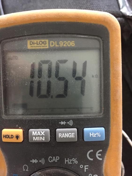

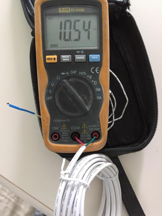

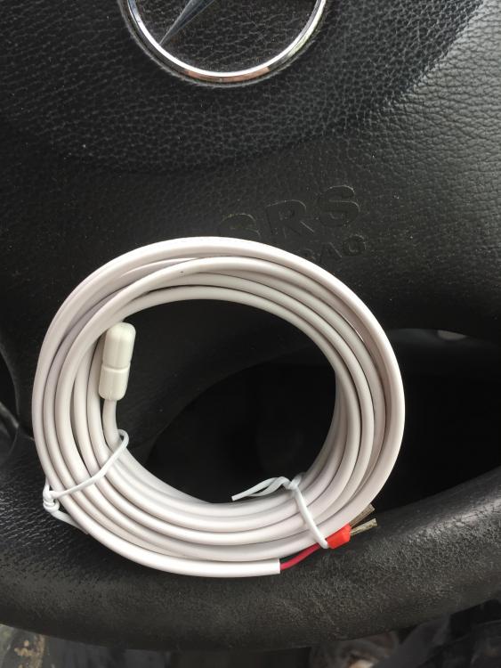

Nickfromwales Posted July 7, 2017 Author Posted July 7, 2017 41 minutes ago, Onoff said: Would decent pvc tape last to attach it? As in would it go brittle? Maybe, yes. Just a thought. Maybe better to bond it for heatvteansfer, and use the pvc tape to hold it until the bond has cured ? How's that 12 ohms ( taken @18oC ambient ). I'd really like to just whack that in right now as it's stopping me plasterboarding. ?
Nickfromwales Posted July 7, 2017 Author Posted July 7, 2017 44 minutes ago, Onoff said: Boiler thermistor if really stuck? Cant see the woods for the trees sometimes. Cracking idea as they're off the shelf at P.Ctr. ?
Onoff Posted July 7, 2017 Posted July 7, 2017 (edited) 21 minutes ago, Nickfromwales said: Yes, Swansea. I that ohms or k.ohms? If a 10K one there, in a room slightly below ambient you'd get a higher value. A cleverer person will be along shortly! EDIT: Ohms I think from zooming in? EDIT 2: I'm an IDIOT, just read you said it's ohms! So that's pretty low, does it make it a PTC thermistor? If so, no good as you want NTC, Edited July 7, 2017 by Onoff
Nickfromwales Posted July 7, 2017 Author Posted July 7, 2017 Maplin have a 15kohm one ( cpc one in stock ).
Temp Posted July 7, 2017 Posted July 7, 2017 (edited) Just back from searching a wheat field in 27 degree heat for the Samsung one of my kids dropped on a sponsored walk so just a bit knackered but... 3 hours ago, Nickfromwales said: What about the thermistor that's in with my multimeter for the temp range? Can I nick that and use it just to save any delays? If I can that would be the jam in my jelly roll . Not sure what that is. Perhaps a thermocouple rather than a thermistor? Differently beasts. If you are going to use the I-108 it needs to be 10k not 15k or the temperature settings will be around 20C out. It might be possible to change a resistor or two on the I-108 to correct for this but the data sheet doesn't have a circuit diagram. Edited July 7, 2017 by Temp
