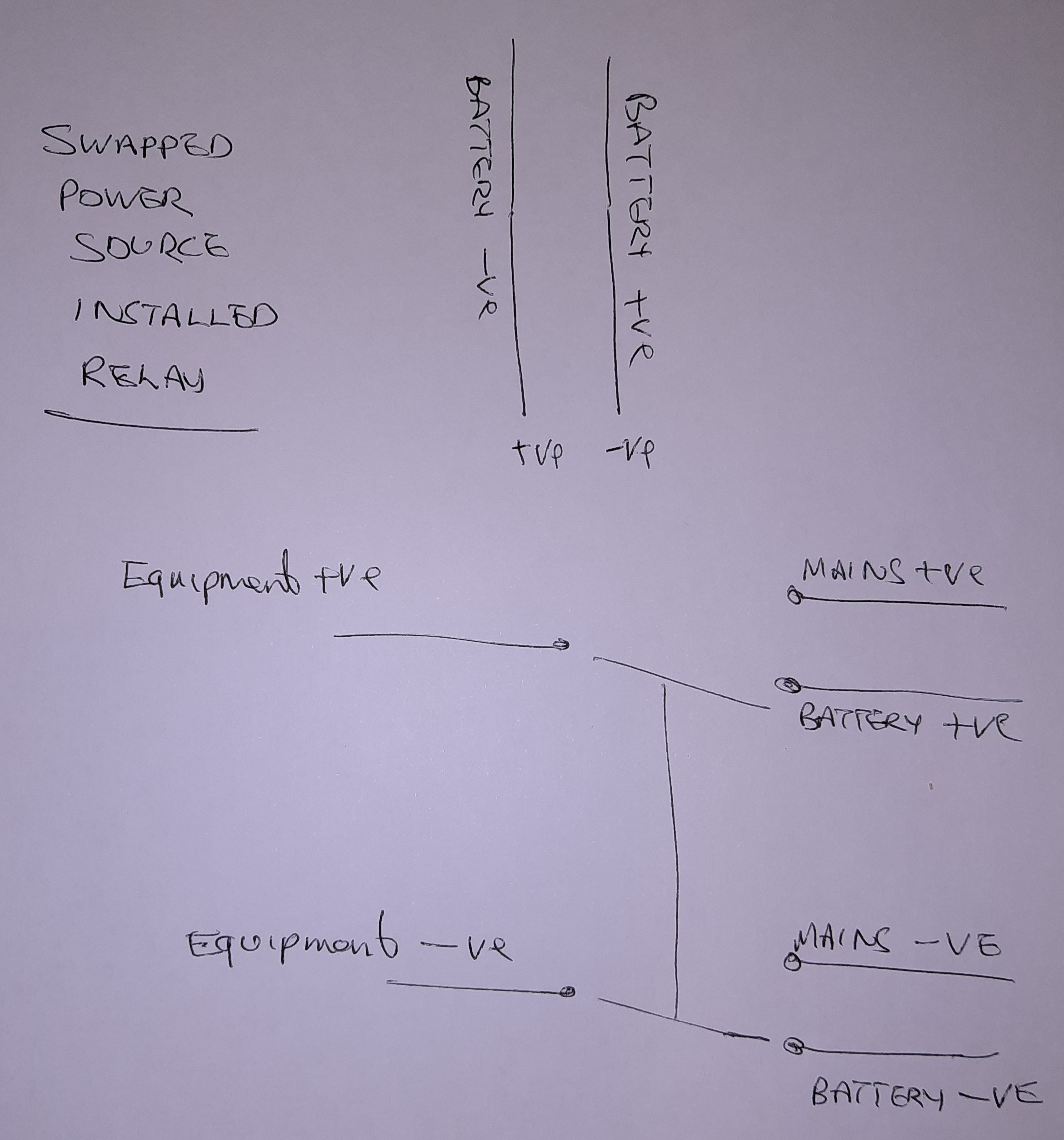

Marvin Posted December 18, 2022 Share Posted December 18, 2022 (edited) On 13/12/2022 at 08:00, joth said: There is a way, in effect by taking your house (or a subset of loads) off grid and powering them only from the battery. But this is more expensive and less flexible than doing the DNO permission. What about a split power supply using a relay? battery supply inverted to 240v Edited December 18, 2022 by Marvin Link to comment Share on other sites More sharing options...
joth Posted December 18, 2022 Share Posted December 18, 2022 6 hours ago, Marvin said: What about a split power supply using a relay? battery supply inverted to 240v Yes That's what I mean by "a sunset of loads". 1 Link to comment Share on other sites More sharing options...
Nick Thomas Posted December 18, 2022 Share Posted December 18, 2022 Sounds like the "level 3 manual whole-house backup" in https://www.deegesolar.co.uk/eps_for_solar/ (I found this link very useful when trying to understand my own options). Another possibility when you have two inverters is to make the PV inverter's output a dedicated input to the battery inverter. Then, you only have the battery inverter's capacity to worry about for G98/G99 purposes. They need to be compatible with each other, though - there's a standard involving frequency shifting that the battery inverter can use to tell the PV inverter to reduce its output,and that's quite important. I didn't keep notes but I do remember concluding that a https://www.victronenergy.com/inverters-chargers/multiplus-ii combined with a Solax X1 Boost G3 would work. Expensive, though. A single inverter with both batteries and panels DC-side is so much better for me. 1 Link to comment Share on other sites More sharing options...
Marvin Posted December 19, 2022 Share Posted December 19, 2022 8 hours ago, Nick Thomas said: Sounds like the "level 3 manual whole-house backup" in https://www.deegesolar.co.uk/eps_for_solar/ (I found this link very useful when trying to understand my own options). Another possibility when you have two inverters is to make the PV inverter's output a dedicated input to the battery inverter. Then, you only have the battery inverter's capacity to worry about for G98/G99 purposes. They need to be compatible with each other, though - there's a standard involving frequency shifting that the battery inverter can use to tell the PV inverter to reduce its output,and that's quite important. I didn't keep notes but I do remember concluding that a https://www.victronenergy.com/inverters-chargers/multiplus-ii combined with a Solax X1 Boost G3 would work. Expensive, though. A single inverter with both batteries and panels DC-side is so much better for me. Hi @Nick Thomas Thanks the info. Very interesting. Our setup using excess PV power is slightly different: Dedicated EPS sockets for use only in a power cut. Level zero type system? ( can be used for a small heater assuming a short scheduled power cut) A level 2 type system for battery power for overnight use of lighting, MVHR, Fridge Freezer. A combination of both the above for use in a power cut. (Assuming a short scheduled power cut) We have calculated and monitored our PV excess power produced in the summer days and are aiming to use about 5kWh a night about 200 days of the year. This will be completely isolated from the mains and we hope to have the system up and running once we get on and install it. Link to comment Share on other sites More sharing options...
