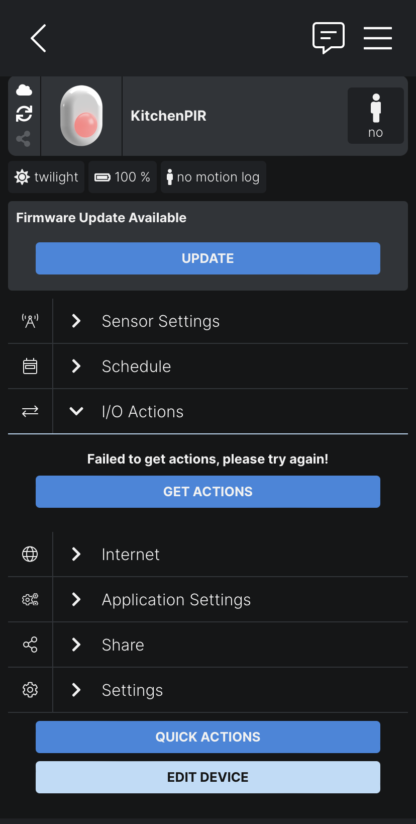

MJNewton Posted November 30, 2022 Share Posted November 30, 2022 It looks daunting but I promise it's quite straightforward... If you go in to the Shelly app and select a sensor you should be able to configure it, one setting of which will be a menu related to actions or something similar like the following: Link to comment Share on other sites More sharing options...

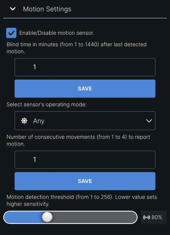

Adsibob Posted November 30, 2022 Author Share Posted November 30, 2022 Thanks @MJNewton but I’m still struggling. This is the list of menu options I see for my sensor: if I click “get actions” I get the “failed to get actions, please try again!” Message. If I click sensor settings, I get this screen: I’m really at a loss… shelly came back to me with some instructions which made no sense: “please open the motion sensor in the app, scroll to the bottom and press quick actions. From there yo can follow through the options to set up the link.” I went back to them to explain that the message "no devices found" appears on the "quick actions" page and they responded: “You may have your 1PM set up as a relay, not a light. So please select relay instead of light.” No idea what they are talking about. Where do I select relay instead of light? Link to comment Share on other sites More sharing options...

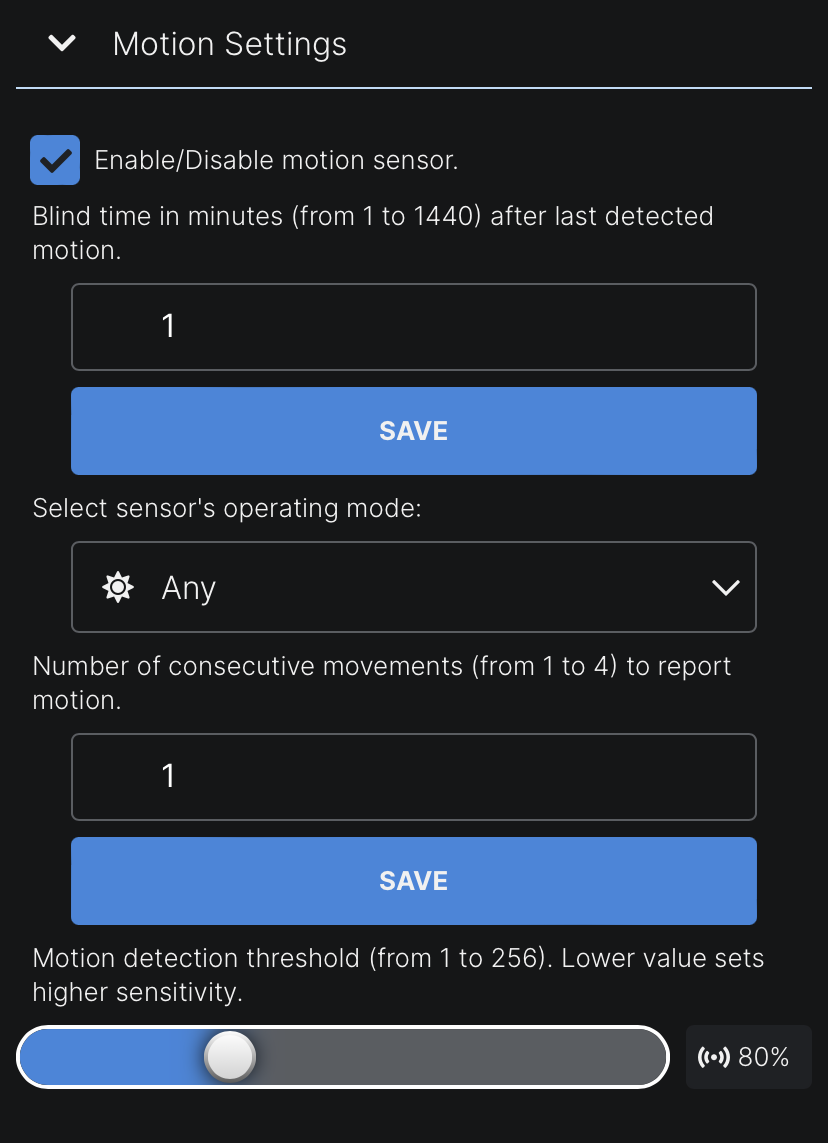

Adsibob Posted November 30, 2022 Author Share Posted November 30, 2022 Okay, i think i have it working now. Shelly customer support thought that some of the messages I was reporting suggested an app issue so they asked me to reboot the app. When that didn't work I rebooted my phone and that fixed the issue. So it's now running and appears to work quite well. I had to increase the secondary loop pump speed from 1 to 2 which ups the power consumption from 37W to 50W, but I will live with that. I also had to increase the sensitivity of some of the sensors. Will report back in a couple of days. 2 Link to comment Share on other sites More sharing options...
