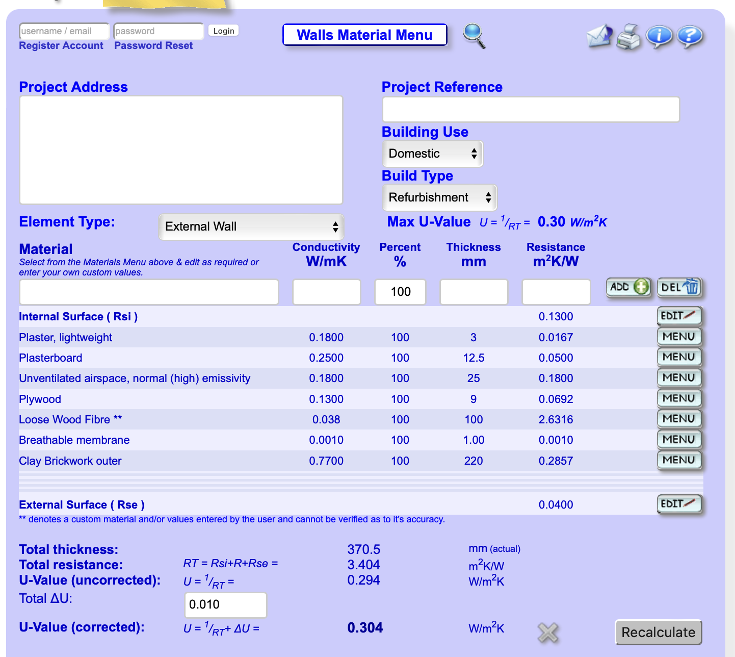

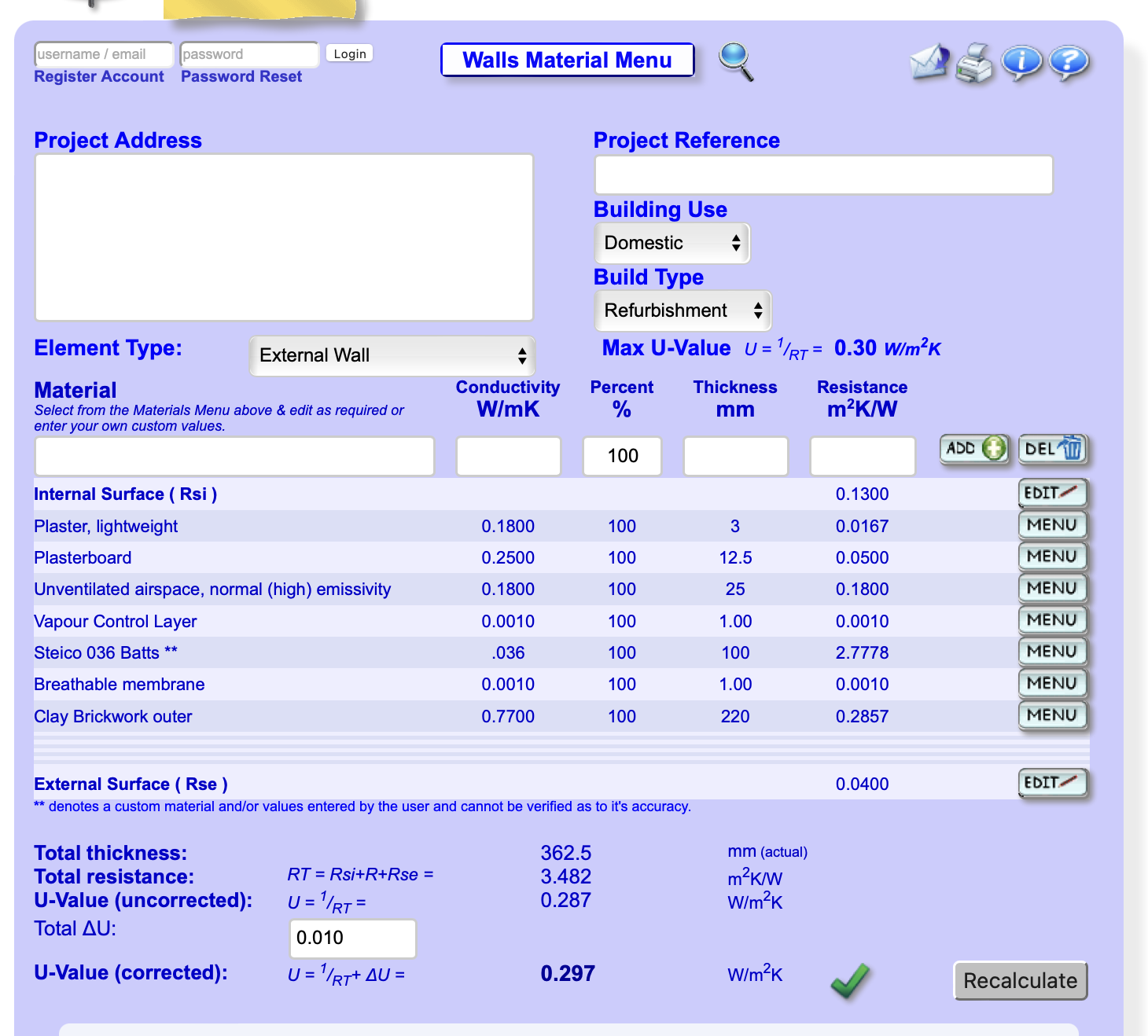

jayc89 Posted December 1, 2022 Author Share Posted December 1, 2022 Looking into Wood Fibre some more. Initially I considered; - External Brick - Breather Membrane - Battens - 50mm Wood Fibre - Cross Battens - 50mm Wood Fibre - AVCL - 25mm Service Cavity - PB This would result in a u-value of 0.297 and cost approx £28.11/m2 in materials. I came across loose-fill wood fibre which is significantly cheaper than batts, and I assume an AVCL alone isn't enough to support loose fill insulation behind it, so I then considered; - External Brick - Breather Membrane - Battens - Cross Battens - 100mm Loose Wood Fibre - 9mm Ply (joints taped - acting as an AVCL) - 25mm Service Cavity - PB This is slightly wider (9mm ply...) and slightly higher u-value at 0.304 but works out at approx. £25/m2 in materials, so is saving me around £1000 in total on the job. I quite like the idea of #2, it's just short of building a TF house inside the existing, however I'm worried about 1) blowing the insulation into the newly created cavity void blind (i.e. ensuring good coverage) and 2) the loose insulation sagging over time (again, causing cold spots towards the top of rooms) What do y'all think? Link to comment Share on other sites More sharing options...

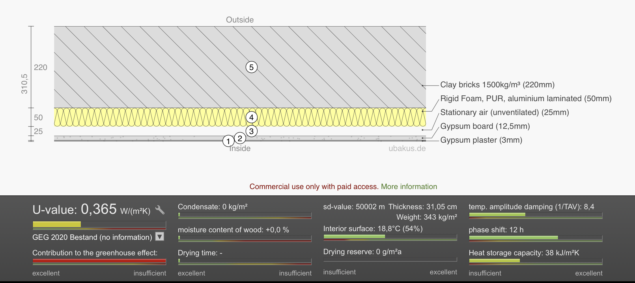

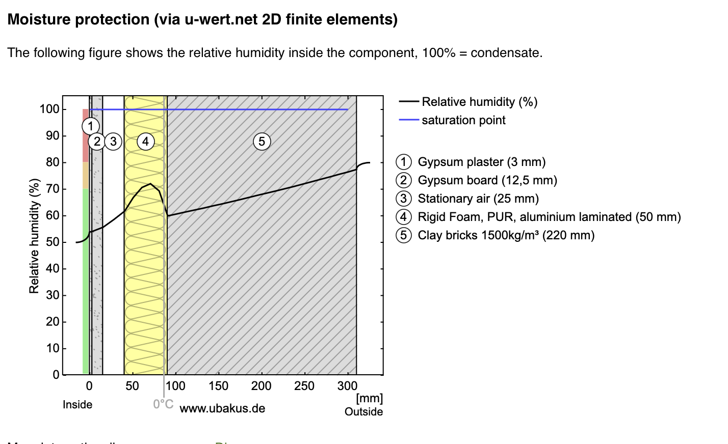

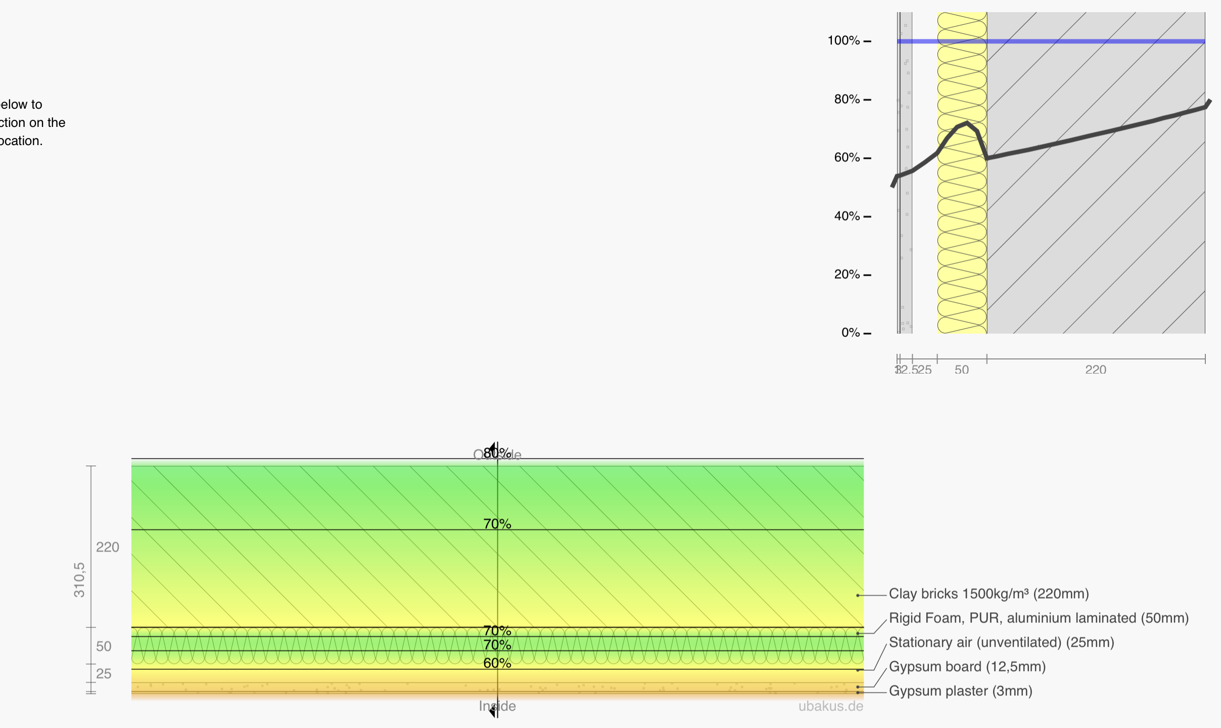

jayc89 Posted December 1, 2022 Author Share Posted December 1, 2022 Thanks for the info. Not sure I follow the Ubakus calcs. According to it PIR boards would work just fine; Which would support my original plan (see initial post), but would go against other beliefs. Link to comment Share on other sites More sharing options...
jayc89 Posted December 2, 2022 Author Share Posted December 2, 2022 (edited) Also, without the breather membrane, regardless of the insulation used (Wood Fibre Batts/Loose or PIR), that modelling shows condensation becoming a problem between the cold side of the insulation and the wall without a breather membrane. I'd also suspect the breather membrane to maintain the efficiencies of the insulation by preventing the wind reaching it. (i.e. wind tight on the cold side, airtight on the warm side) Edited December 2, 2022 by jayc89 Link to comment Share on other sites More sharing options...
