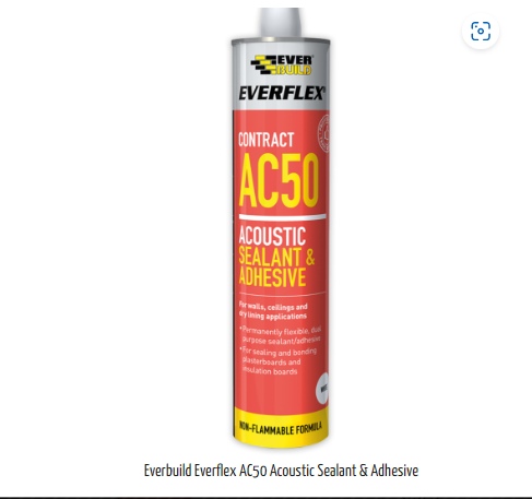

Iceverge Posted November 26, 2022 Share Posted November 26, 2022 @MK_Anthony I assume it's the urban soundscape of MK that's causing the issues. Those sliding sash windows are probably the main culprits. Secondary glazing would be a good improvement. Other than than the ceilings are lightly not great. I suspect 12.5mm plasterboard with lots of holes for light fittings etc and a lightweight glass wool over the top. If you can have a look in the attic and see what's in there. If you could just loose lay and drop say a 15mm layer of plasterboard on top of the current plasterboard and then 300mm of rockwool you'd have a good improvement. Top it off with some acoustic sealant to any and every hole in the ceiling. Link to comment Share on other sites More sharing options...
