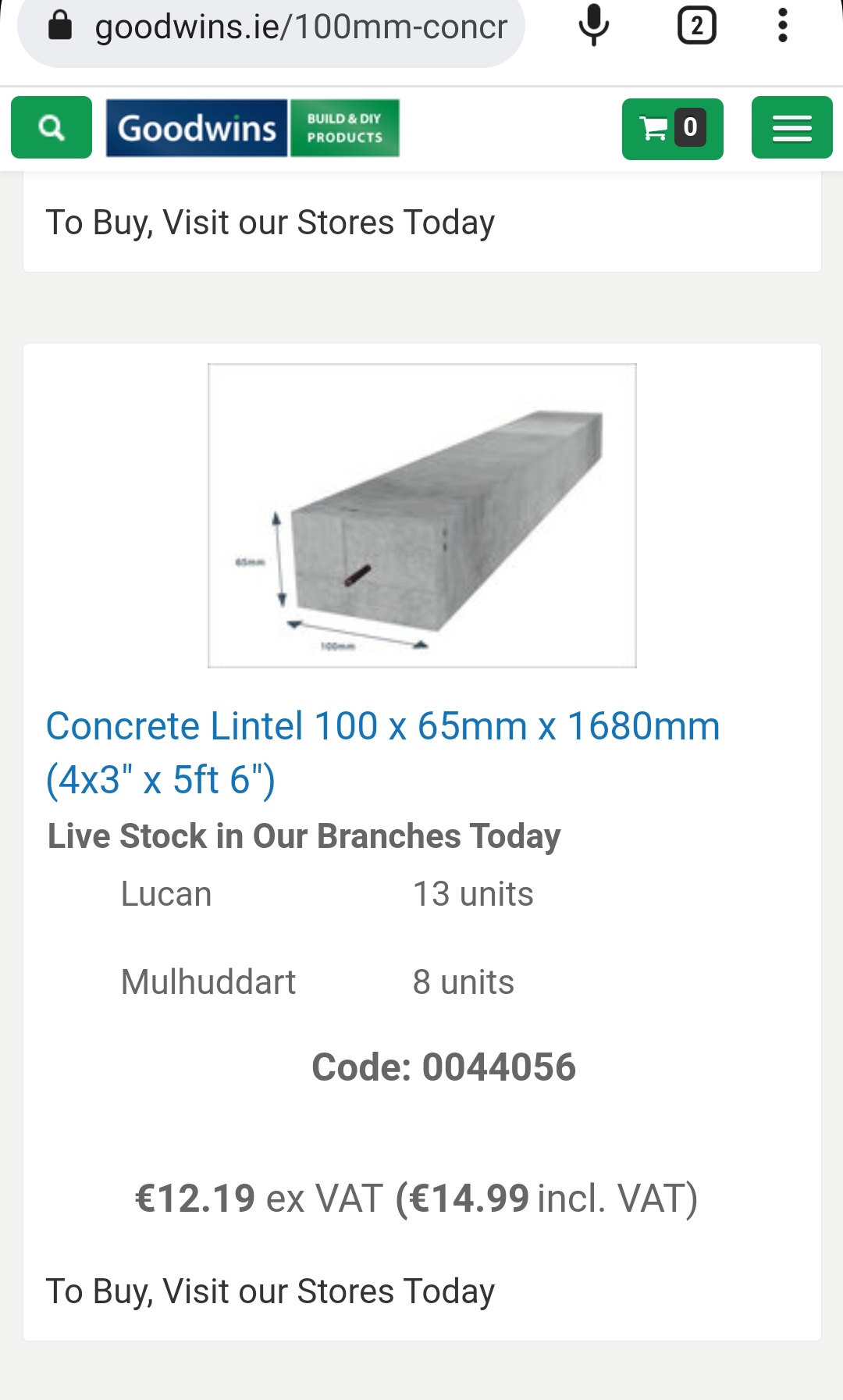

Can you not buy precast lintels off the shelf in the UK?
They're ubiquitous and really cheap here. One for the internal leaf and one for the external.

That's ludicrously cheap. They're at least double, from what I can see, here. And not much more than an L-angled Catnic.
Posted
It's just some rebar and concrete. I can't see where the cost goes.
