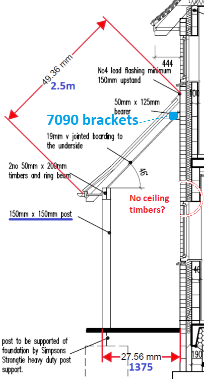

Ok lets go back to my earlier post.

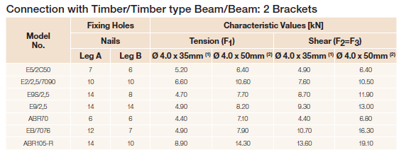

On 17/11/2022 at 00:27, Gus Potter said:
2.39 * 1.375 / 2 = 1.64 kN/m. In other words the "DESIGN" load on the ledger is 1.64 kN per metre run of the ledger.
Say the rafters are spaced at 600mm centres. Thus the shear load at the top end of each rafter is 1.64 * 0.6 (spacing) = 0.98 kN.
Below is an extract from the Simpson brochure for the 7090 brackets.
I have not copied it all but the bracket capacity changes depending the grade of timber and nails you use so please check this yourself. The main thing to take away from this is how you read the table. This table is based on Eurocode design and the value we are interested in is the characteristic value. In the previous post I showed how we worked out the DESIGN loads.. we worked out the loads and then applied safety factors. BUT we also need to apply safety factors to the Characteristic loads for resistance as we are using limit state codes.. which in this case is the brackets. Generally for simple timber design we apply a material factor of safety of 1.3.
Thus you can see for the 7090 bracket the characteristic shear load with 35mm nails is 7.6 kN. We divide 7.6 / 1.3 = 5.84 kN which is well above the 0.98 kN. Caution.. read the fine print as the values are based on two brackets.. one each side!
Now that seems overkill in terms of holding the roof up.. but
On 14/11/2022 at 14:00, MortarThePoint said:
I'm trying to finalise my thoughts around this loggia
What you do here is pile up logs and inevitably they will end up pushing the vertical columns (timber posts) outwards. The 7090 bracket also work in tension that have a declared value. The brackets can take tension where as joist hangers commonly can't.
Earlier we looked at the resin fixings.. these to can take a bit of tension..
For all if you are trying to get you head round this sort of thing try and work out what forces you have and follow where they go.
On 21/11/2022 at 19:09, MortarThePoint said:
Would it be possible to use hidden woodscrews like below?
Will have a go at this but not tonight as screws into the end grain of timber are not.. "that good".. I would try and avoid any end grain screw that is subject to a tensile force.

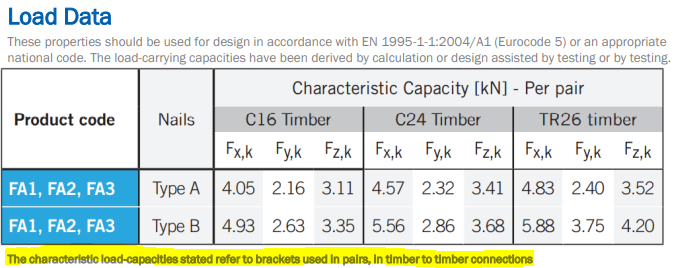

That was the loading on the top (ridge) ledger wasn't it so not near the ceiling ties. In the US Simpson do a nice Face-Fix Rafter Hanger (LRUZ) but it isn't available in the UK unfortunately. They have an SPR product, but that's for 6x2 and pretty expensive.
Frame anchors are pretty discrete. I'm not sure which directions Fx,k , Fy,k and Fz,k are but if you pick the lowest one it's a characteristic capacity of 2.16kN for C24. Dividing byt the 1.3 safety factor that gives 1.66kN which is greater than the 0.98kN requirement so should work (?). They also specify use in pairs.
I like how these look if using Simpson Strongtie CSA screws which have an axial pull out strength of 1.28kN for the smallest type (CSA4.0x30). I expect they would improve the numbers of the table above. Following the load and comparing this to the tensional Design Capacity of the lower ledger (ceiling level) which was around 1.14kN per fixing I think, so these frame anchors would be stronger than the ledger fixing if the ceiling ties were on the same c/c as the ceiling ledger fixings. If the ceiling ties were 1200mm c/c then there would be two ledger fixings per ceiling tie and their strengths would become comparable (2*1.14kN vs 1.66kN) though the ledger fixings would win (based on the FA's table).
Is there any way the tensional load on the ceiling tie can exceed the shear load on the top ledger (which we know to be 1.64kN/m Design Load)? I can only think wind uplift might do that but it would need to overcome the weight of the tiles by that point and I suspect the roof would be in tatters at that point in a nuclear blast. Would it be the load of things resting on the pillars that are of concern?

Hi Mortar.
Have not checked you figures as kind of off duty here.
These brackets look like a Simpson AE35. You have to wrap the top tab over.
Your train of thought is good. You mention wind.. probably won't govern unless it gets close to a mansard type roof which you don't have.
It's the practical side of things.. on a loggia folk will pile stuff up and use the posts to hold it all still.. that is where the risky horizontal loading comes from.
I would stick to the 7090 brackets.

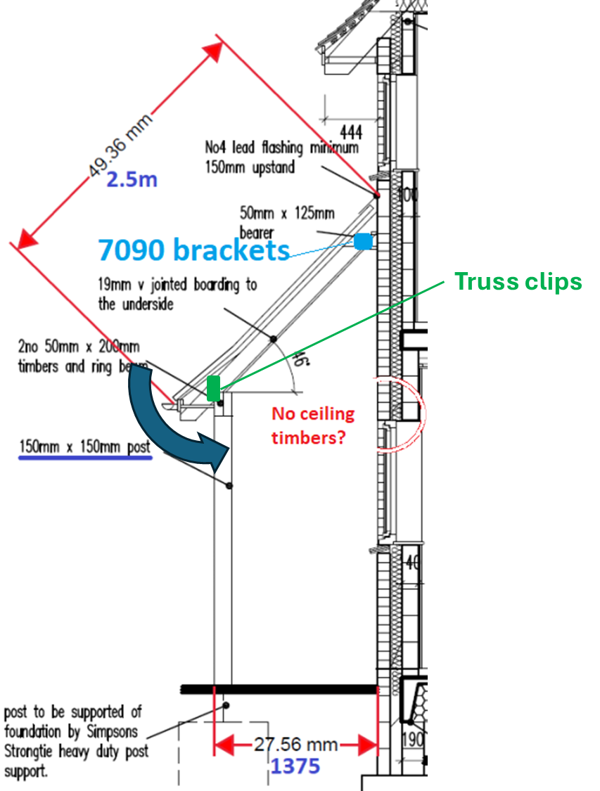

Ah, I think I may have misunderstood you. Are you saying that just having 7090 brackets at the top is sufficient and then there wouldn't need to be any ceiling ties at all? So like this:

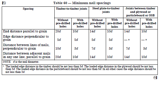

No you also need something at the bottom to stop rafter uplift. The birds mouth needs to be held in close contact with the wall head / lintel.
You could maybe use a truss clip but on the outside face of the lintels. Will be nicely hidden here, but you need to fix them before the sarking / tiles.
If you want to go for a "sturdy" job use the 7090's all over.. but some of the nails will be to close to the joint between the double lintels.. nail edge distance.
You best bet is to assemble is and do a trial fit with the 7090 brackets.. use common sense.. do they look right if not try a truss clip.
Generally a truss clip has 6 nails into the lintel / head binder and 6 into the rafters all with at least 19 mm edge distance for the nail in the loaded direction of the force if using a 3.75mm diameter nail... 5* 3.75 = 18.75mm ish..
Now that is quite hard to get right on site when you have angled timbers resting on a say a head binder. Have copied a table from BS 5268 for reference. But if you fit say truss clips on the outside the problem often "goes away"

Finally gearing up to build some of this after a long delay.

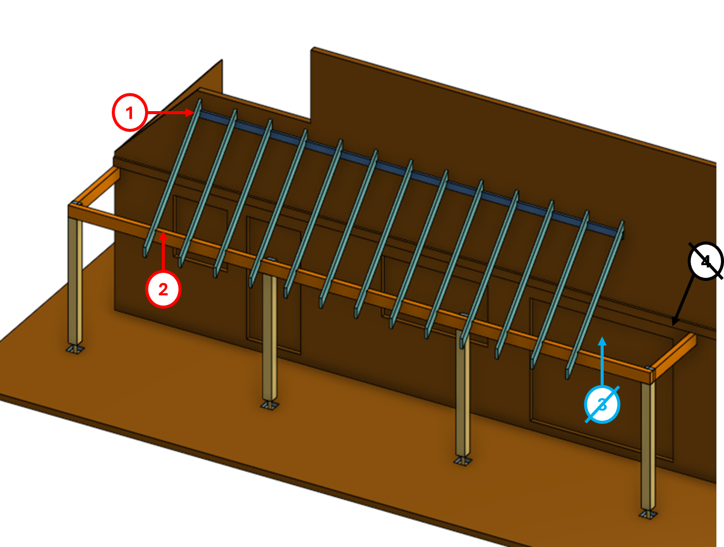

I'm happy using 7090's both sides at the top of each rafter to connect them to the ledger board (labelled 1 in the images below). It occurs to me that truss clips could be an option here too, but I would want something to constrain the rafters horizontally at their top connection to the ledger. If using 7090's there, I would need to raise the ledger so there is a better interface rather than resting the rafter on the ledger using a birds mouth. That would be easy enough.
Truss clips on the outside of the lintel beam (labelled 2) feels natural and they would get hidden but the soffit there.

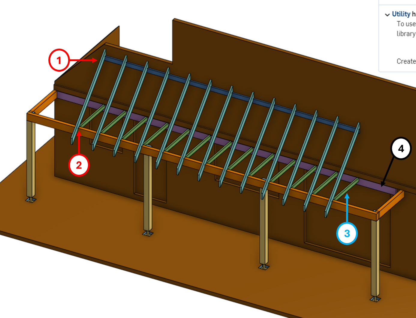

I'm still a bit unclear as to whether you think there needs to be horizontal bracing of the posts and lintel by timber "ceiling ties". I have shown two options below, one with and one without. The timber ceiling ties are coloured green and labelled 3, whilst the ledger that terminates them against brickwork is coloured purple and labelled 4. I can appreciate that the lintel would need to be displaced downwards to allow the movement shown in the third image below, so is that why ceiling level ties could be omitted?
With timber "ceiling ties":
Without timber "ceiling ties":

I am inclined to use sheathing to stop the whole structure racking. I was going to have v-groove cladding, but could install OSB or plywood sheets over the top as sheathing. I prefer that to using braces as the braces will sit in the eyeline looking out of the window.
The main unknow for me is still whether I should go with ceiling level ties (timbers going from the ring beam back to the house. With and without images in the post just before this one.
