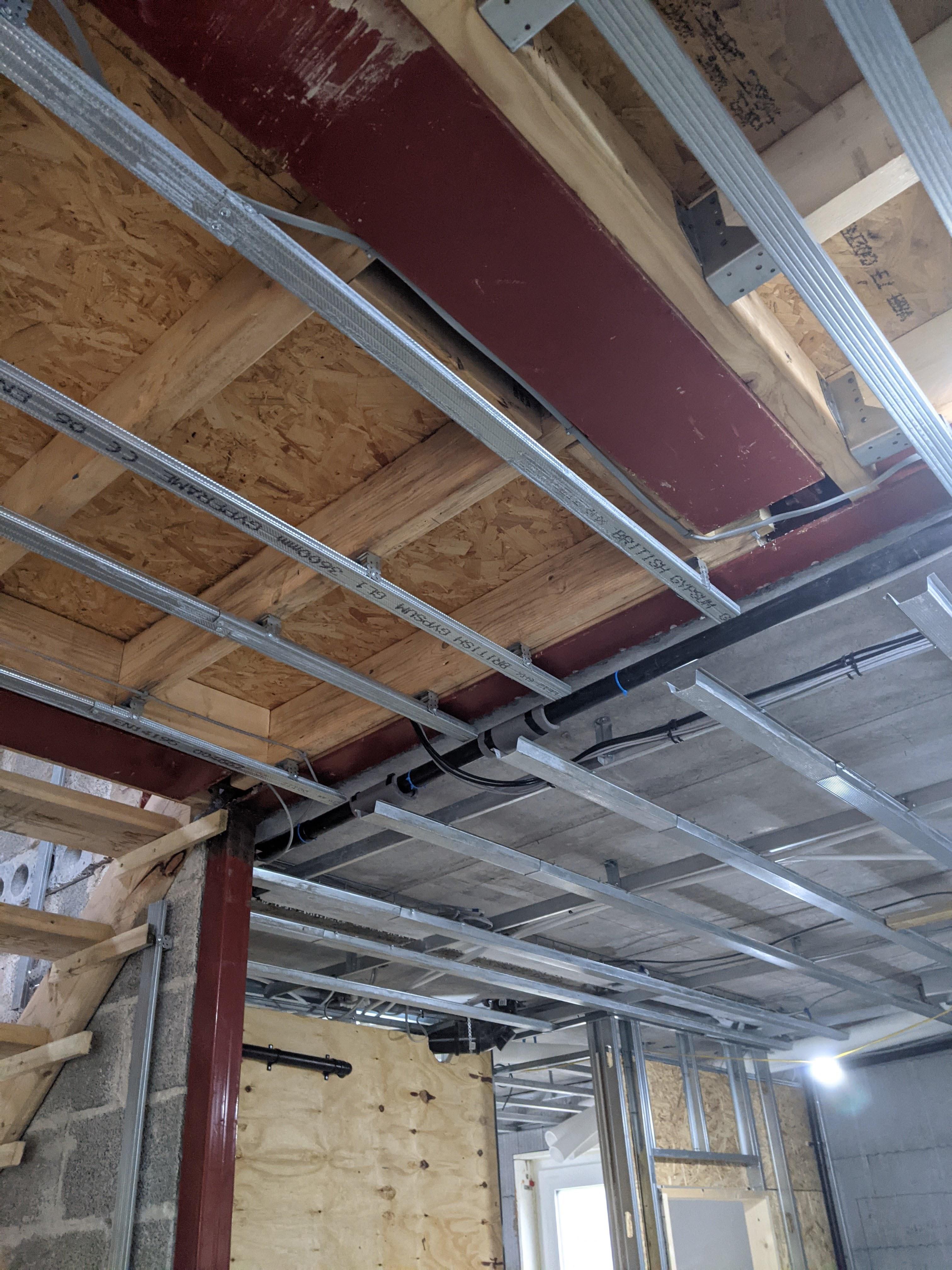

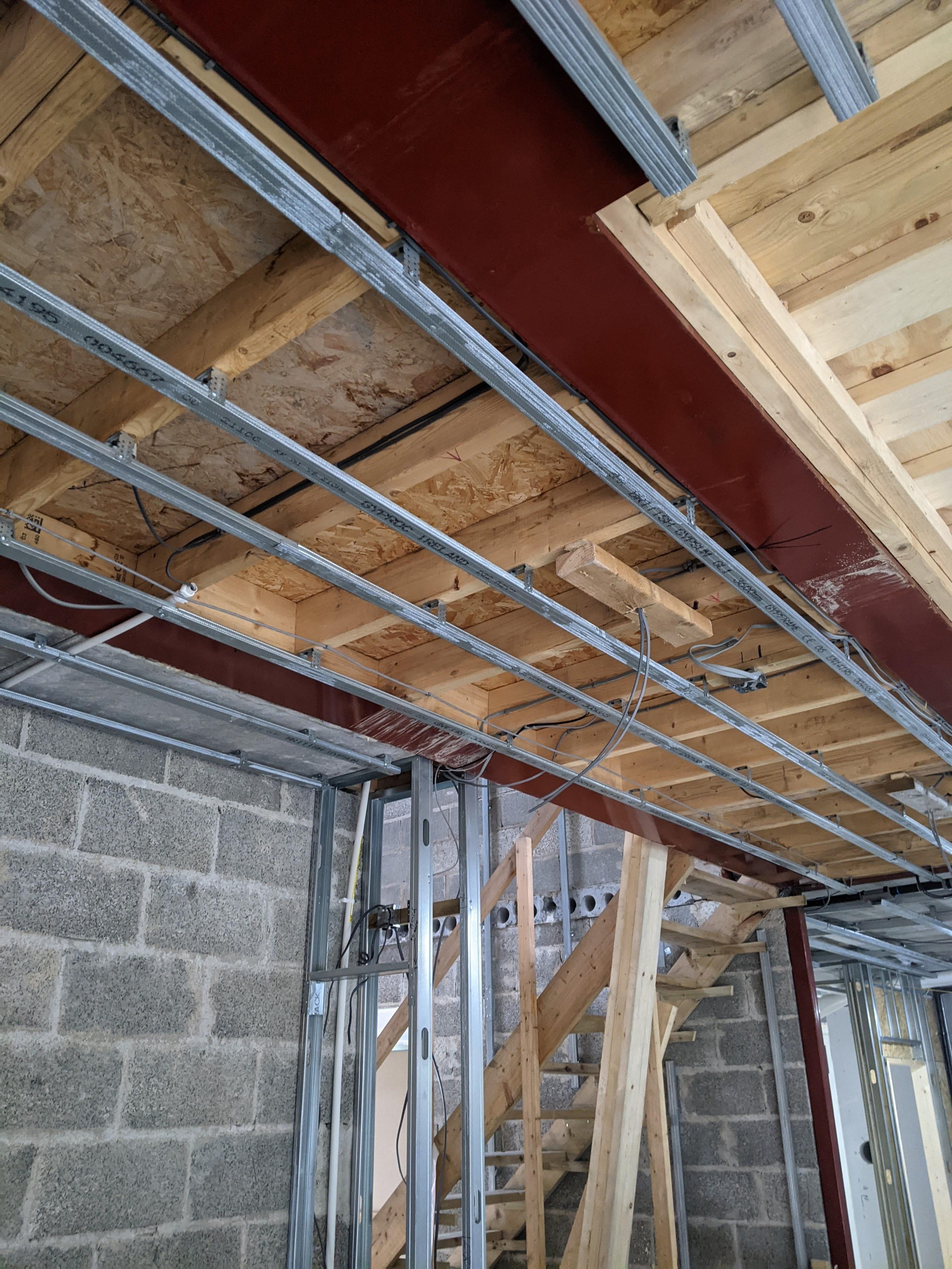

Conor Posted November 10, 2022 Share Posted November 10, 2022 Best sound proofing for ceilings is to hang a suspended metal ceiling frame and fill the void with 50mm accoustic insulation. Same for walls, metal studs with 50mm insulation. We did that throughout with standard palsterboard and there's virtually no sound transmission between rooms. You've probably no accounted for that in your design by the sounds of it, so next best thing is use gyprails or other resilient bars fixed to the underside of the floor joists. Like the below. Link to comment Share on other sites More sharing options...

Conor Posted November 10, 2022 Share Posted November 10, 2022 In the last pic there the drop is only 50mm, but could be less if needed. The bars will always perform better than boars directly on joists as you are dramatically reducing the solid transfer path for sound. Can't give you any figures to back that up tho. Link to comment Share on other sites More sharing options...

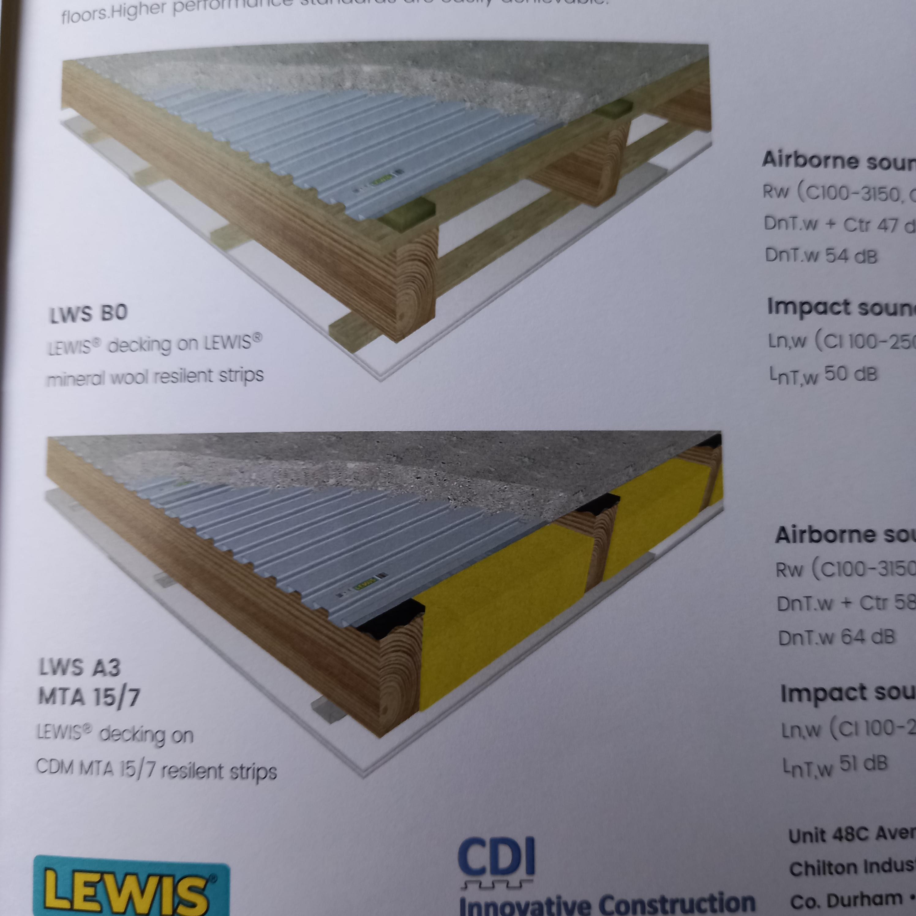

twice round the block Posted November 10, 2022 Share Posted November 10, 2022 Add a metal deck by www.CDI-ICM.co.uk. No more creaking floor or noise pollution. Link to comment Share on other sites More sharing options...
