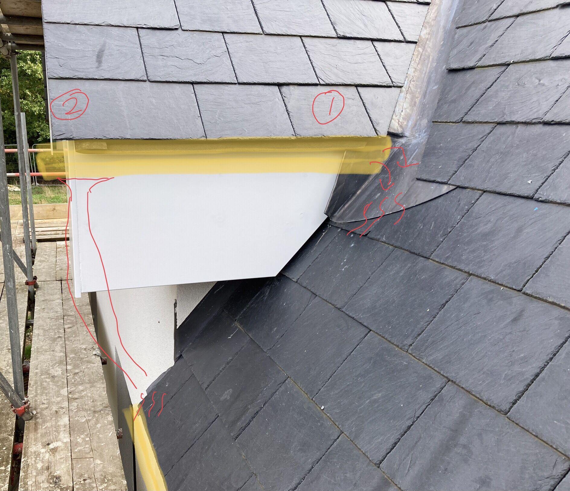

Nick Laslett Posted October 30, 2022 Posted October 30, 2022 I have 2 short sections of roof where I’m not sure if I even need a gutter. See photo, yellow lines are the gutters, red lines my solutions. My first thought is to let the water run out of an open ended gutter onto the lead valley. Number 1 on drawings. Or put a downpipe to take the water to the gutter on the roof below. Number 2 on the drawing. Or no gutter at all, as 90% of the roof falls onto the roof below. Any thoughts appreciated.

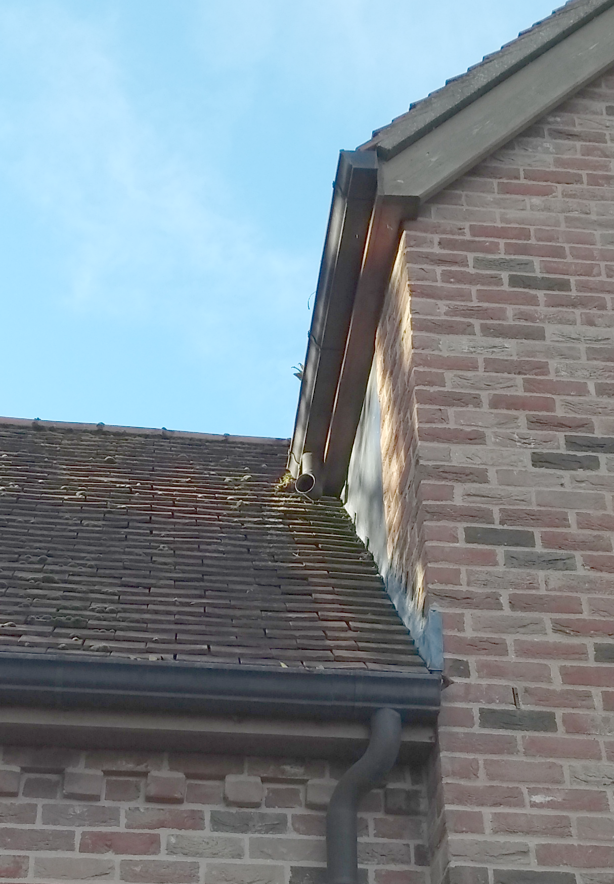

PeterW Posted October 30, 2022 Posted October 30, 2022 Yes you need a gutter …! and don’t direct onto the lead, it looks messy … This is how we tend to do it with dormers - this is Brett Martin deep flow and the shoe is pushed tight on to the outlet spigot (sorry about crap photo !!) 1

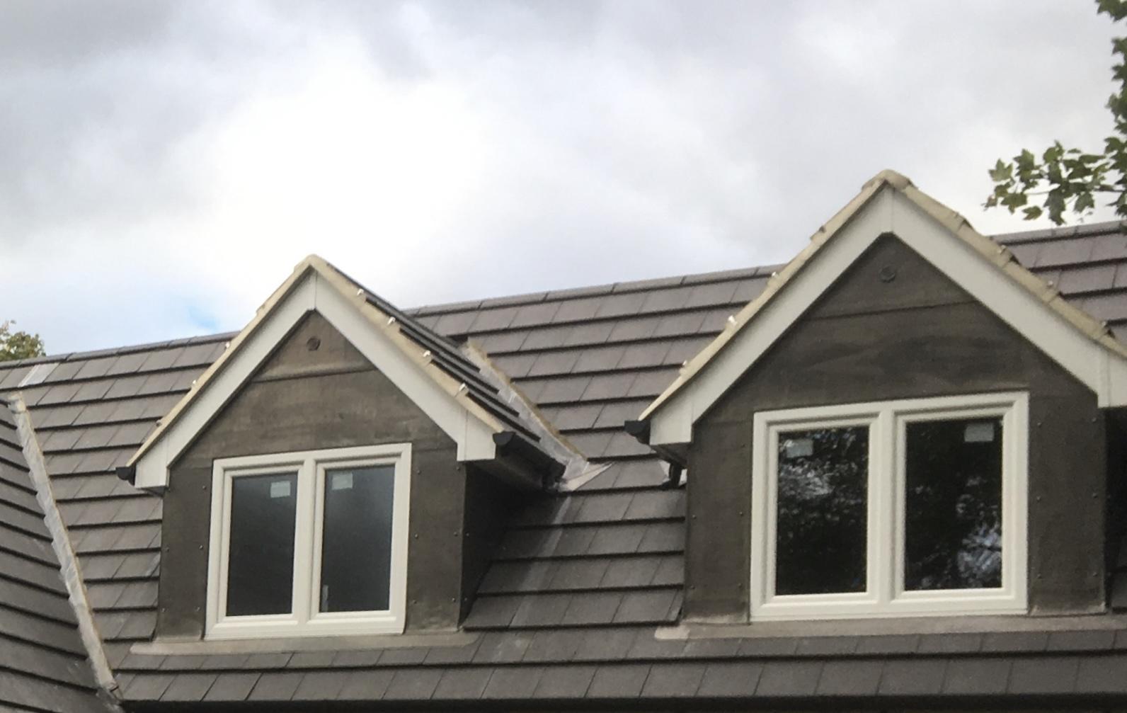

PeterW Posted November 1, 2022 Posted November 1, 2022 @Nick Laslett like this ..? Better shot These are full lead dormers as a row of 3 in the roofline, all have dual gutter with the shoe on the outlet 1
Nick Laslett Posted November 1, 2022 Author Posted November 1, 2022 39 minutes ago, PeterW said: @Nick Laslett like this ..? Better shot These are full lead dormers as a row of 3 in the roofline, all have dual gutter with the shoe on the outlet Yes, like this, but not full lead. Thank you.

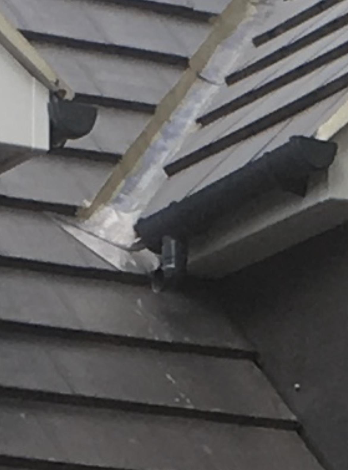

Redoctober Posted November 1, 2022 Posted November 1, 2022 @Nick Laslett just in support of what @PeterW has suggested - a photo of our set up - 1
Nick Laslett Posted November 1, 2022 Author Posted November 1, 2022 (edited) 2 hours ago, Redoctober said: @Nick Laslett just in support of what @PeterW has suggested - a photo of our set up - @Redoctober thanks. Hard to tell in the photo, but it looks like the dormer window gutters are emptying into the lead valley. Is that the correct? Edited November 1, 2022 by Nick Laslett
Redoctober Posted November 1, 2022 Posted November 1, 2022 1 hour ago, Nick Laslett said: @Redoctober thanks. Hard to tell in the photo, but it looks like the dormer window gutters are emptying into the lead valley. Is that the correct? I'm not sure if that is considered to be the correct / best practice, but I do see on @PeterW photo, his have a short downpipe. That said, I have not experienced any problems with this approach so it may just be a case of either or?
Temp Posted November 1, 2022 Posted November 1, 2022 On 30/10/2022 at 09:41, Nick Laslett said: I have 2 short sections of roof where I’m not sure if I even need a gutter. See photo, yellow lines are the gutters, red lines my solutions. My first thought is to let the water run out of an open ended gutter onto the lead valley. Number 1 on drawings. Or put a downpipe to take the water to the gutter on the roof below. Number 2 on the drawing. Or no gutter at all, as 90% of the roof falls onto the roof below. Any thoughts appreciated. We have just about every combination on our house. Some dormers the rain just runs off the tiles onto the roof below but the larger ones have a gutter that runs it from left to right (in your picture) then has a short down pipe that deflects it out across the roof..
