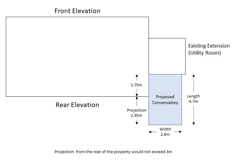

Jonathan M Posted October 25, 2022 Posted October 25, 2022 Hi, I've submitted a planning request for a lawful certificate to build a conservatory under permitted development to my local Council. The conservatory will be built alongside an existing extension and will not exceed the width of the extension but will protrude beyond the rear elevation by 2.95m so within the limits. However, as it is, in total, 4.7m from the rear wall of the extension it is being rejected as too long and I need to submit the next level of planning. So I can extend up to 3m from the rear elevation of the main house but seemingly not from a recessed extension. It is a semi-detached bungalow. I don't understand the decision but at the point of conceding and just raising the next level request but wanted to check first. Any advice and thanks in advance?

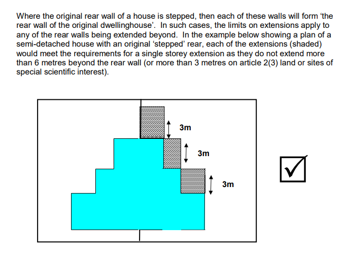

Jonathan M Posted October 25, 2022 Author Posted October 25, 2022 This is for a property in Norfolk, England. To be honest, it hasn't yet been fully rejected but the Council are stating that they cannot issue the certificate as the size is too long and I need to go to the next level of planning (more time and money). The latest comment was: "The measurement on the drawing that measures 4.7m in length, this measurement needs to be 3m to apply for an LDP." Thank you Ian for that link. I've have just found this which I believe definitively answers my question:

andyscotland Posted October 25, 2022 Posted October 25, 2022 So in that case it seems the key question is whether the stepped line of the extension follows a line of some pre-existing part of the original house, or whether the extension was on "new" land. "Original house" is I'm fairly sure a defined term in planning law, it means as first built or as it was at some specific date in the past (1948?) if the house is older than that.

DevilDamo Posted November 22, 2022 Posted November 22, 2022 (edited) Sorry @Ferdinand, haven’t long seen this. Under PD, original is how the house stood on 1st July 1948. @Jonathan M If that bit on the side is original/has been there since 1948, then what you are proposing would require Planning because one part exceeds 4m deep. If that bit on the side is not original/built after 1948, then what you’re proposing what constitute PD. The latter is referred to on Page 20 of the Technical Guidance. Edited November 22, 2022 by DevilDamo
