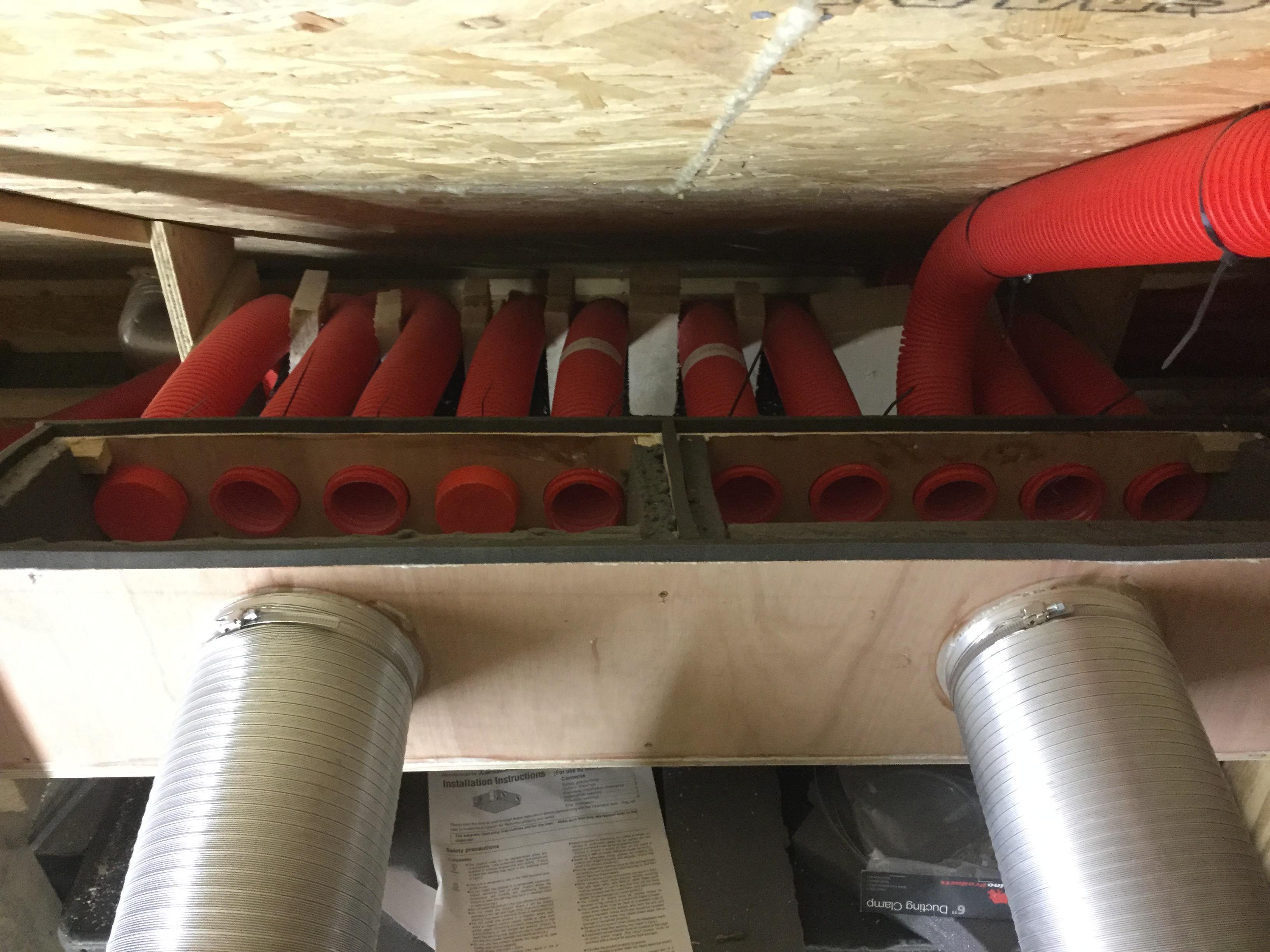

Well I made mine and it works great, ply box lined with acoustic foam. I had heard that noise can be generated by the room terminals so I made my “throttling” within the distribution box and unless on boost completely quiet and only just able to hear it on boost.
Thanks @joe90 couple of questions on this if I may.
1 ) Presume that's one side for supply and one side for extract?
2 ) Did you build it to a specific design size or literally make a simple airtight ply box lined with acoustic foam? If so is bigger or smaller better?
3 ) How did you attach the big (125mm) ducting this side and the 75mm radial ducting the other side?
Thanks very much.
1/ yes
2/ I built it purely to accommodate the various pipes.
3/ MVHR came with adapters to fix the 125mm pipes to the ply, the 75mm was simply a tight and silicone .
