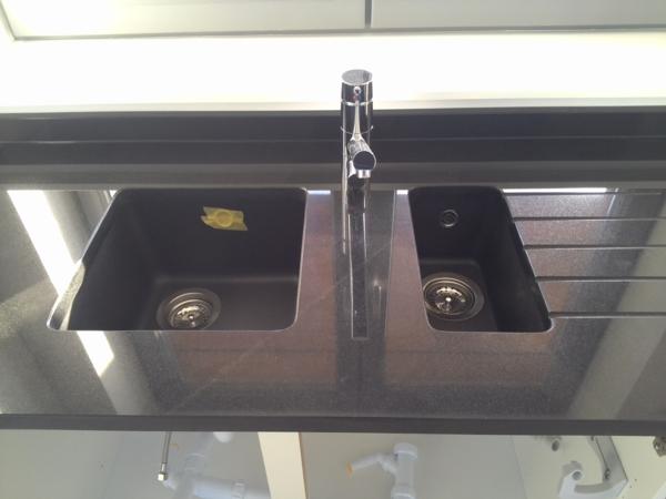

Gone West Posted October 18, 2022 Share Posted October 18, 2022 At our last house we also fitted Schock sinks which were undermount in a black granite worktop. We also had hard water so we had a water softener and didn't have any problems. Link to comment Share on other sites More sharing options...

Gone West Posted October 19, 2022 Share Posted October 19, 2022 15 hours ago, Bob77 said: Aren't the main kitchen taps normally left unsoftened for drinking, or did you have a separate drinking water tap? The tap in the picture is a three way tap with a dedicated filtered drinking water supply. Link to comment Share on other sites More sharing options...
