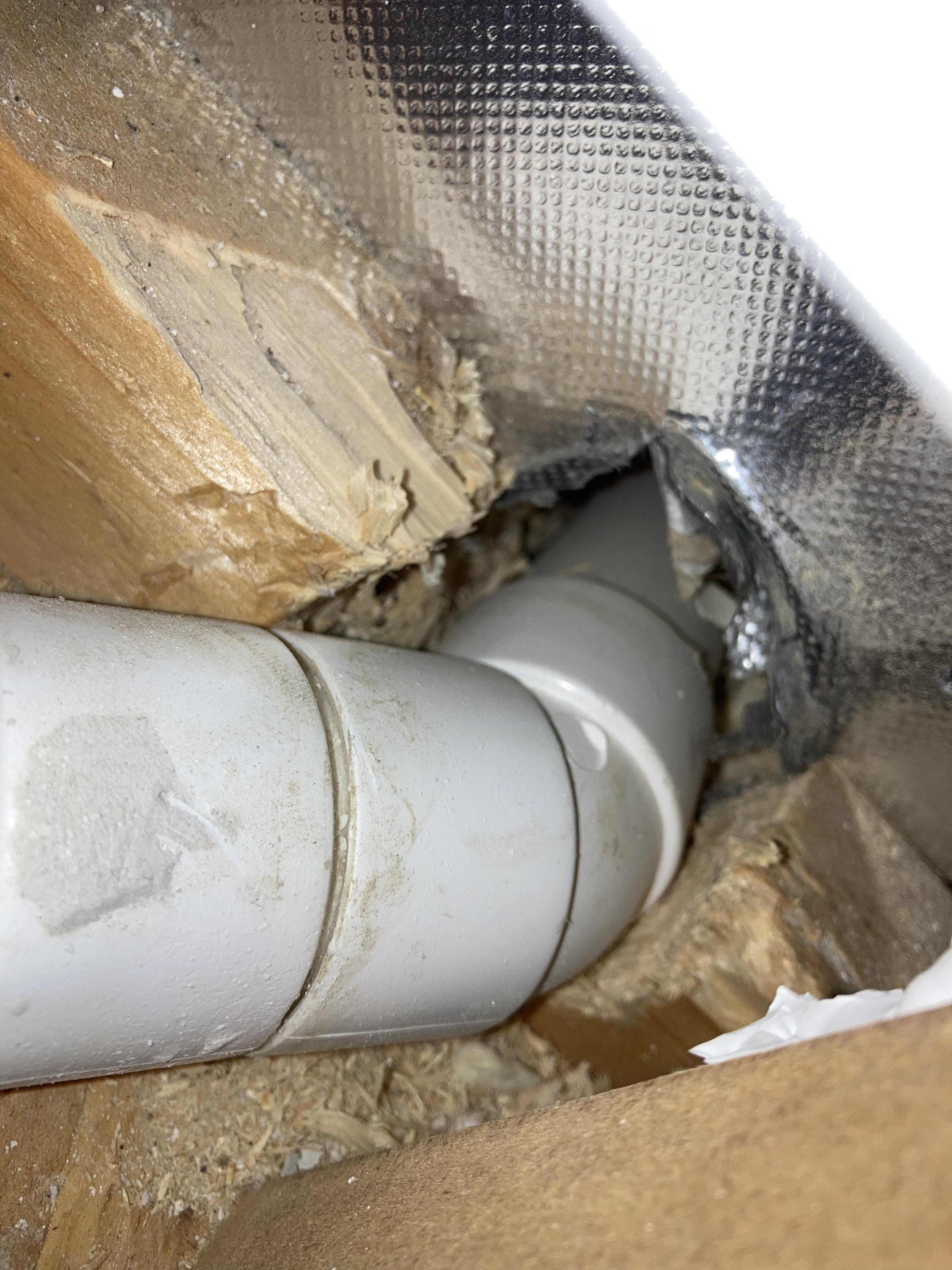

Alwayslearning22 Posted October 12, 2022 Posted October 12, 2022 Any ideas on how I could seal up this penetration on my vapour barrier? I Don’t think I can tape it up?
Roundtuit Posted October 12, 2022 Posted October 12, 2022 Expanding foam, trim level and tape over with your tape of choice?
Alwayslearning22 Posted October 12, 2022 Author Posted October 12, 2022 Thanks. I was just thinking it could be difficult to seal properly for long term the tape would be awkward to use around the batton maybe
PeterW Posted October 12, 2022 Posted October 12, 2022 I would chop the fingers off the person who “cut” (gnawed.?? Hacked..?) the timber first.. then it would be Low Expansion foam, cut flush and shaped and then tape over the lot - decent tape won’t come off. 1
Alwayslearning22 Posted October 12, 2022 Author Posted October 12, 2022 I know it’s awful I wonder the point in having a vapour barrier when you have a tradesmen ripping it apart so they can get there pipes through.
