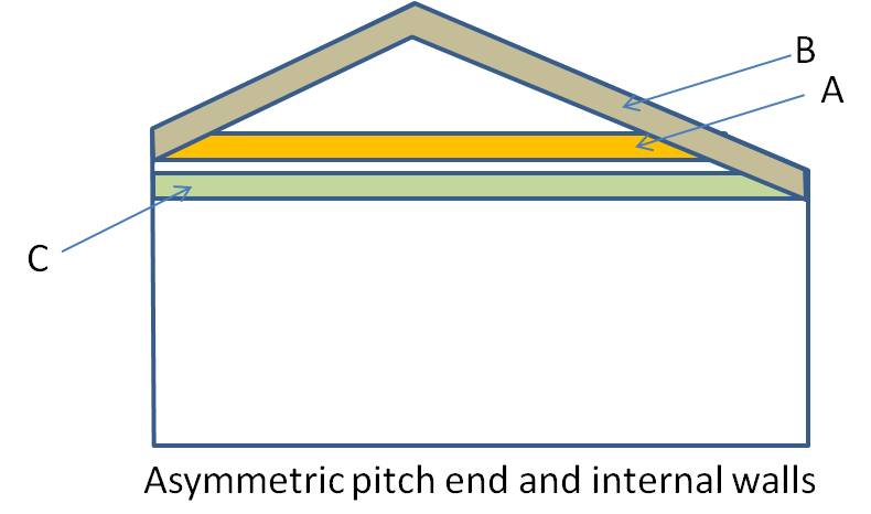

MikeSharp01 Posted June 21, 2017 Posted June 21, 2017 Hit a small problem today that I am struggling to find the answer to; Our Garden Room has walls that extend all the way up to the vaulted ceiling and the ceiling has an axisymmetric pitch so I am wondering where the wiring safe zone is, is it A or B or C or some combination of all three / any two? Any definitive ideas anyone?
ProDave Posted June 21, 2017 Posted June 21, 2017 I have always assumed B if there is no conventional ceiling.
MikeSharp01 Posted June 21, 2017 Author Posted June 21, 2017 Thanks Dave, I guess that is my preferred. I can find nothing from IET.
