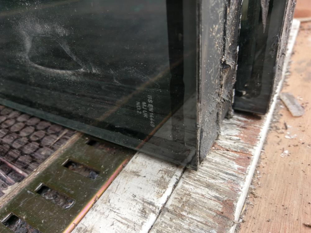

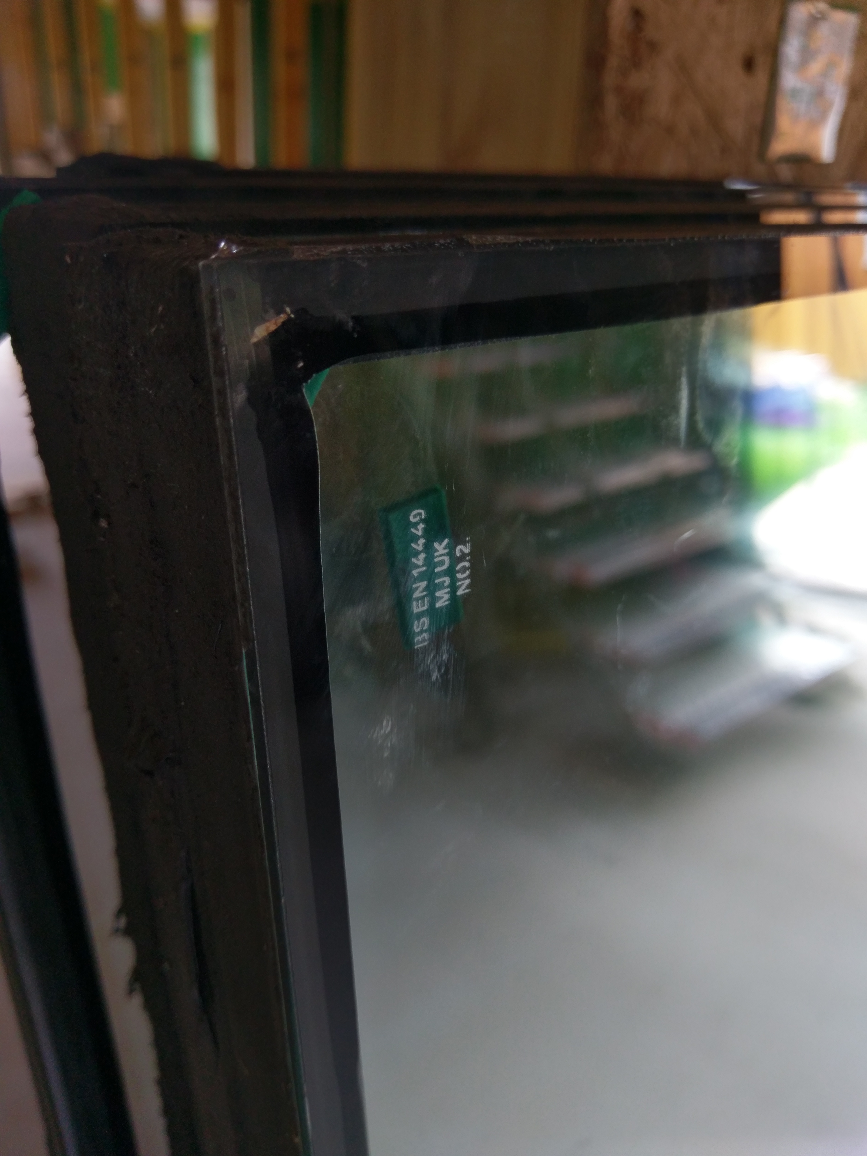

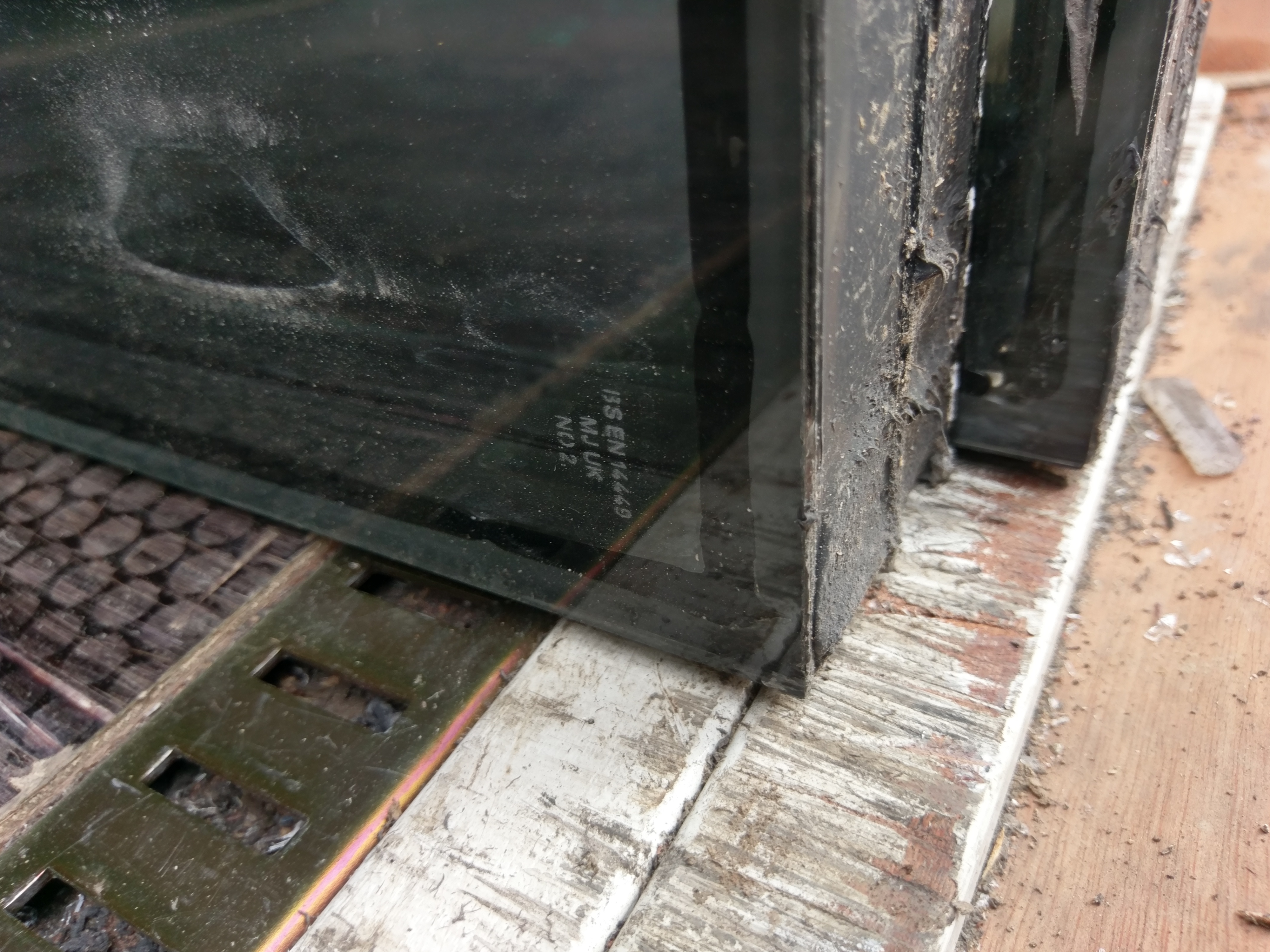

dogman Posted July 21, 2017 Author Posted July 21, 2017 So, the new glazing panels turned up today. 7 large triple glazed panels for the sliders. I knew it would not go well ( i expect it )and one was broken whist being transported. We had agreed soft coat x2 toughened and laminated solar reflective outer pane with krypton Trouble is how do you tell if we are being conned. They have put it in writing but there is nothing to say its either Krypton or solar reflective glass. In fact the glass they took away was exactly the same. Ok it is sort of reflective when stood outside but the glass looks the same as the glass doors and fixed pane windows. It even has a number printed on it that is exactly the same as the number on the glass taken away( we took photos) Anyone got solar glass and does it have any identification on it?
craig Posted July 21, 2017 Posted July 21, 2017 (edited) The glass will have a marking, depends on where the glass was made to be honest. If UK, usually a kite mark, if EU it will usually have the EN number etched into the glass or spacer. Thats to do with the toughening/lamination of the glass. The gas filling isn't marked anywhere and it's a case of believing the written documentation supplied. The solar coating will have a slightly different tint to it but it's difficult to tell. Edited July 21, 2017 by craig

dogman Posted July 22, 2017 Author Posted July 22, 2017 These are the new units markings And these are the old units The marks are on the outer pane of glass
Jeremy Harris Posted July 22, 2017 Posted July 22, 2017 That's just the marking to show that the glass is laminated/safety glass, it doesn't indicate any coating. The coating type isn't usually marked on the glass, AFAIK, but only on any sticky labels there may be on the glazing units (our glazing units all had sticky labels on giving the spec, not sure if this is common practice or not).
dogman Posted July 22, 2017 Author Posted July 22, 2017 18 minutes ago, JSHarris said: our glazing units all had sticky labels on giving the spe so did ours they said Argon gas. When pointed out they were removed and went missing but i did get photos. The company were challenged and confirmed again in writing they had Krypton and the stickers are the standard stickers as they don't have krypton labels in the factory. If i can prove there is no coating then i have them over a barrel. To be honest if that's the case it amounts to a deliberate deception so will go to trading standards, and seek a prosecution.
