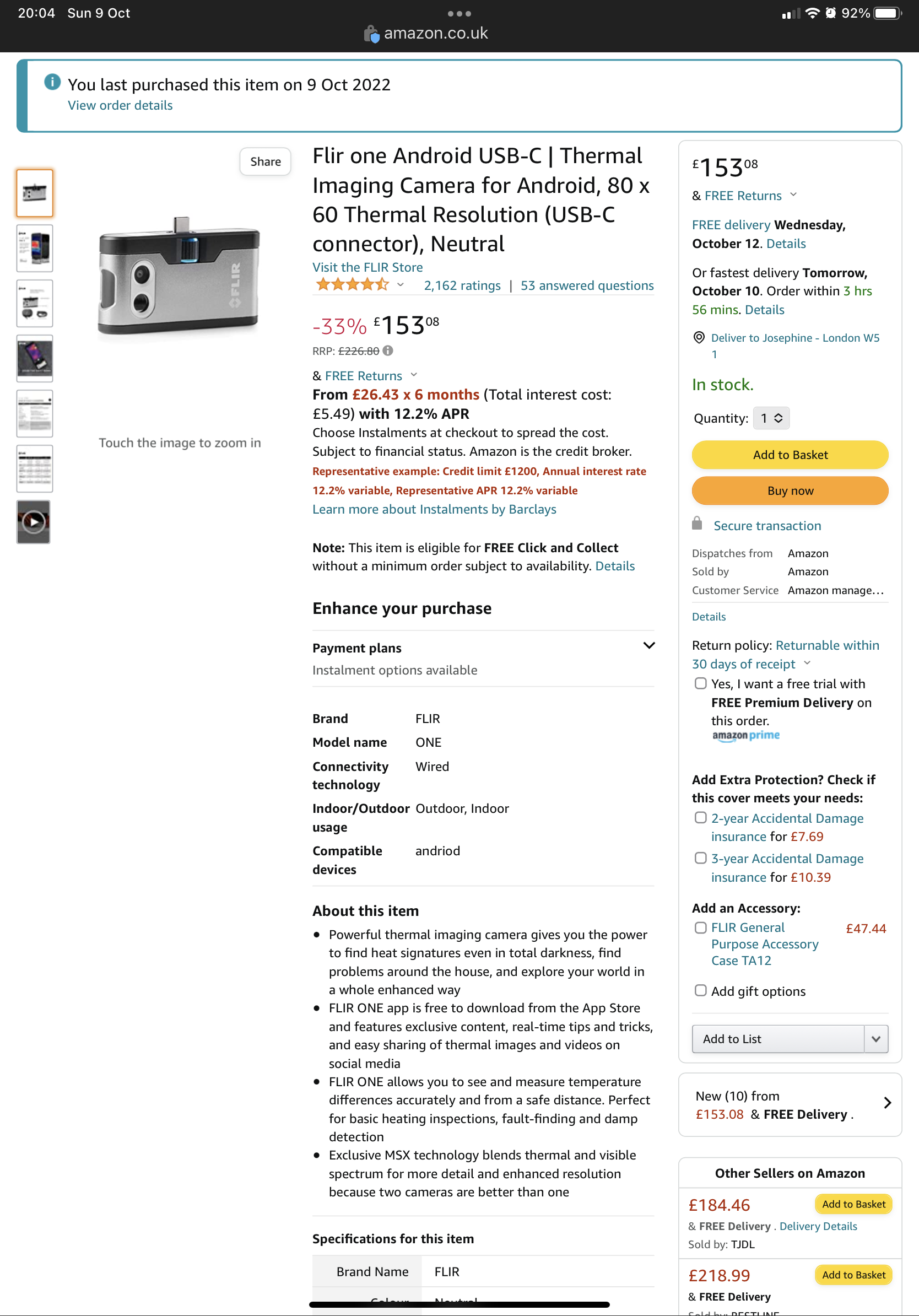

Iceverge Posted October 9, 2022 Share Posted October 9, 2022 As per the title. The price seems low so I jumped at it. Pretty small resolution but hopefully good enough for DIY. 1 Link to comment Share on other sites More sharing options...
twice round the block Posted October 9, 2022 Share Posted October 9, 2022 Not sure what your intended use is but I've been using thermal for a number of years and I think you maybe very disappointed with your purchase, especially if your trying to pin point heat loss areas. You may get a faint heat signature if it's freezing outside. Link to comment Share on other sites More sharing options...
CalvinHobbes Posted October 9, 2022 Share Posted October 9, 2022 Twice, what would you recommend for a self builder? Link to comment Share on other sites More sharing options...
LA3222 Posted October 10, 2022 Share Posted October 10, 2022 I used one to find some ufh pipes in my house. Not an industrial/professional bit of kit but definitely works and has its uses. Link to comment Share on other sites More sharing options...
twice round the block Posted October 12, 2022 Share Posted October 12, 2022 On 10/10/2022 at 00:46, CalvinHobbes said: Twice, what would you recommend for a self builder? Hire one I use them for my work as pest controller, both my units were in the thousands. Even a cheap spotter / viewer around the £800 mark, still doesn't give very good detailed definition. 1 Link to comment Share on other sites More sharing options...
