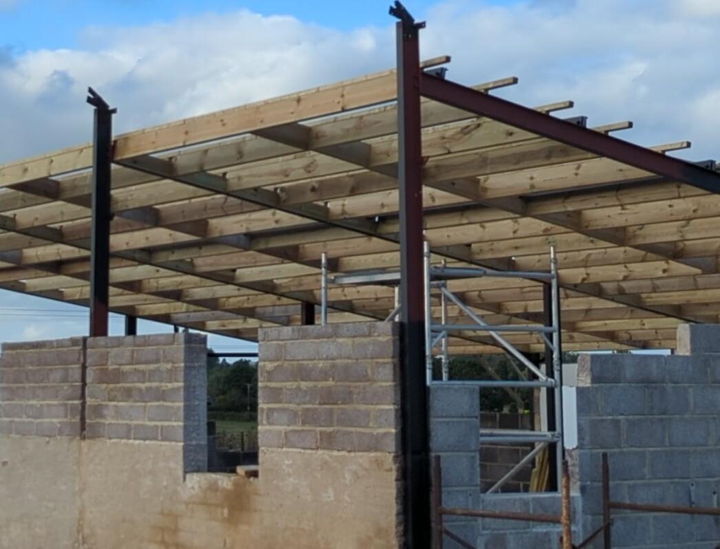

Am about to build timber frame on top of masonry wall. Have already put purlins in between steels. I need to put restraint straps from head plate and studs in wall to purlins -spanning three with noggins in place to prevent them bowing.
Question- as it is a pitched roof most straps seem to be right angles or straight  I have seen twist straps but not sure they are applicable. Ceiling will be vaulted so don't want to have to come down off it unnecessarily.
Do I self bend a suitable restraint strap to get the angle or is there a product suitable off the shelf. Presume a lot must deal with pitched roofs? May well be missing something. Thanks!
Nothing wrong with bending your own straps. 90 degree ones are usually used up a wall and over wall plate, twisted are up wall and onto side of rafters or bottom cords of trusses
Can't comment on your specific question, but its easier to bend a 90degree strap to 30degrees or whatever than it is a straight strap.
Thanks for the reply Conor, only just seen, valuable info. Luckily enough I bought some straps this morning and they are 90 degrees. I have a vice so hopefully can bend them ok, they are substantial- a good thing so long as I can bend them! Thanks again.
Also thanks for the reply @markcsorry for not replying before, just liked your reply as it was exactly the info I was after. Ended up spending £220 on straps this morning. They are eyewateringly expensive for what they are!
