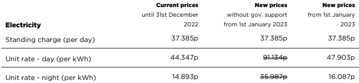

PhilT Posted October 10, 2022 Posted October 10, 2022 On 09/10/2022 at 08:45, JohnMo said: Gas at 10p is £1650, energy in to house 13200kWh HP at 3.5 CoP 1320/3.5 =3771kWh 3771kWh at 34p is £1282. Best part of £400 a year saving I reckon a SCOP of 4 to 5 is achievable for the latest models, well installed and set up. I just re-worked my numbers based on these latest costs (including daily fixed rates) and my ASHP is saving me £1,148 pa with no heat loss saving measures. Yes granted the old boiler was probably less than 80% (perhaps as low as 70%) efficient, but that is probably no different from the average uk household, still operating at crazy flow temps up in the 70s degC (the legal max is now 55degC). Even allowing for 70% efficiency I'm getting an implied SCOP of around 5. 1
MortarThePoint Posted October 10, 2022 Author Posted October 10, 2022 2 hours ago, PhilT said: I reckon a SCOP of 4 to 5 is achievable for the latest models, well installed and set up. I just re-worked my numbers based on these latest costs (including daily fixed rates) and my ASHP is saving me £1,148 pa with no heat loss saving measures. Yes granted the old boiler was probably less than 80% (perhaps as low as 70%) efficient, but that is probably no different from the average uk household, still operating at crazy flow temps up in the 70s degC (the legal max is now 55degC). Even allowing for 70% efficiency I'm getting an implied SCOP of around 5. What model ASHP do you have?

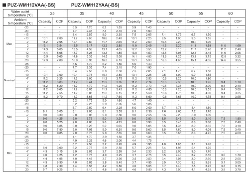

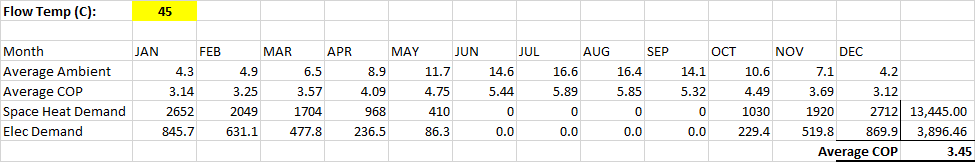

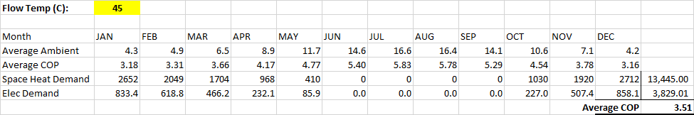

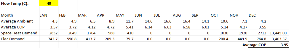

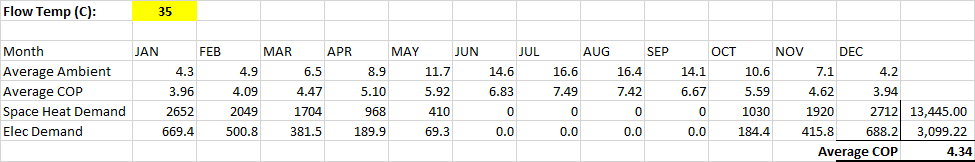

MortarThePoint Posted October 13, 2022 Author Posted October 13, 2022 I have found a databook from Mitsubishi Ecodan and here is some performance data for their 11.2kW unit: https://library.mitsubishielectric.co.uk/pdf/book/ATW_Databook_R32_2020#page-60-61 Based on my SAP and that data (nominal), I should achieve (my model) an average COP of 4.34 with a flow temp of 35C or 3.45 with a flow temp of 45C. Having put in UFH upstairs as well as downstairs, I will hopefully be able to use the lower flow temperature (UFH power output W/m2 data below). This all ignores domestic hot water, but I'm OK with working out the space heating needs as a priority. Modelling as linear above 2C ambient would have been fine. Here's UFH heat output vs flow temperature: data from link below except red which is from a good linear fit. https://www.tradingdepot.co.uk/info/plumbing/polypipe/underfloor-heating-heat-output-tables/

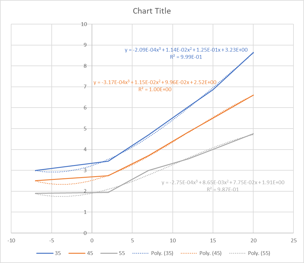

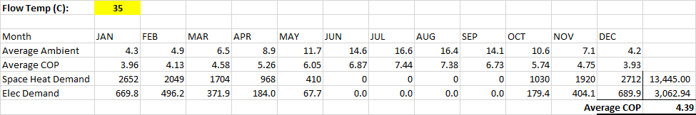

MortarThePoint Posted October 13, 2022 Author Posted October 13, 2022 (edited) A reasonable formula for the COP of the Ecodan 11.2kW is COP=(0.521 - 0.0068E*FT)*AT + (4.44 - 0.0485*FT) where AT is the ambient temperature and FT is the flow temperature, both in C. Using that I get my expected average COP based on the flow temperature with the assumption that the flow temperature stays constant throughout the heating season: COP = 7.47 - 0.088*FT That assumption feels reasonable given most of the demand is across 3 months with an ambient temperature within 1C (DEC-FEB) and the rest is mostly still within an ambient range of 2.8C (NOV - MAR). Edited October 13, 2022 by MortarThePoint

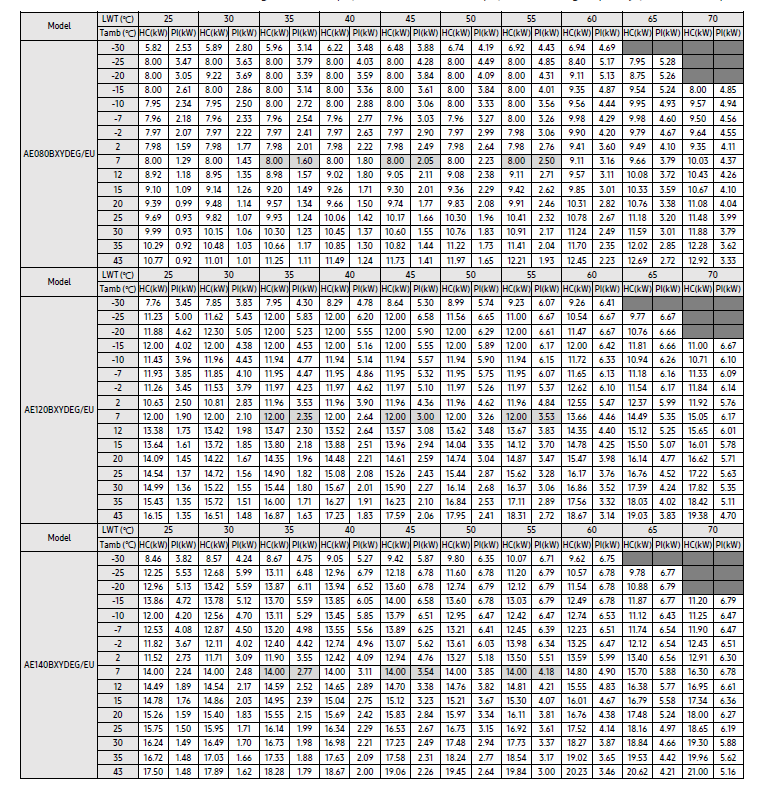

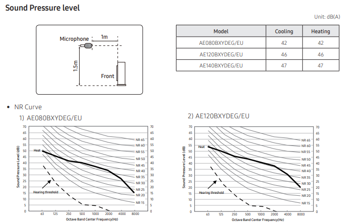

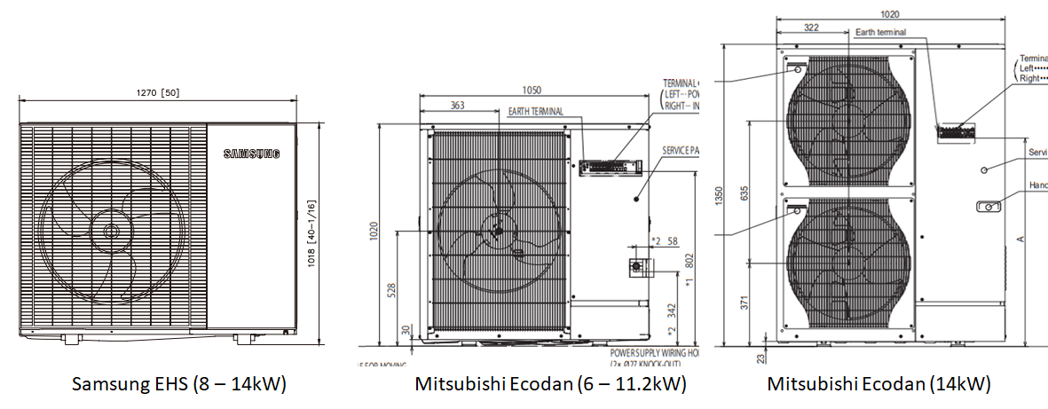

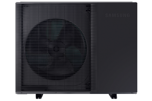

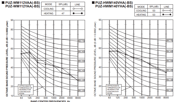

MortarThePoint Posted October 13, 2022 Author Posted October 13, 2022 (edited) Samsung have come out with an interesting looking new ASHP, EHS Mono HT Quiet, R32, Heat Pump, 12.0kW. Also available 8kW and 14kW. Available single and 3-phase. Unlike with Ecodan/Zubadan the 14kW unit is the more standard 1m height which could be a big win for people who need a little extra power. Prices look similar. Black in colour. They have a headline COP figure, but then give power out and power in data at varying FT and AT: On first inspection the COP looks worse, as at most ambient temperatures the resulting values are lower. However, at the key temperatures in the South of England, they have done a better job of optimising the design and get better numbers (suspicious?). Red is the better: 14kW model has similar COP numbers in the 2C to 12C range (1% worse than the 12kW model): The basic linear model makes for average COP values of 4.41 at FT=35C, 4.05 at FT=40C and 3.68 at FT=45C. That's about 2.4% better than the Ecodan figures, but the linear model doesn't fairly represent the improved better optimisation of the Samsung (e.g. 9% better COP at AT=7C). The Ecodans have been around for longer, so perhaps there are some optimisations not reflected in their data. There's more in field experience for the Ecodan which is a plus. Edited October 13, 2022 by MortarThePoint
MortarThePoint Posted October 13, 2022 Author Posted October 13, 2022 The 11.2kW/12kW units are very similar in quietness (47 vs 46), but the Samsung 14kW units are a fair bit quieter than the Ecodan units.

Kevm Posted October 14, 2022 Posted October 14, 2022 14 hours ago, MortarThePoint said: Samsung have come out with an interesting looking new ASHP, EHS Mono HT Quiet, R32, Heat Pump, 12.0kW. Also available 8kW and 14kW. Available single and 3-phase. Unlike with Ecodan/Zubadan the 14kW unit is the more standard 1m height which could be a big win for people who need a little extra power. Prices look similar. Black in colour. They have a headline COP figure, but then give power out and power in data at varying FT and AT: On first inspection the COP looks worse, as at most ambient temperatures the resulting values are lower. However, at the key temperatures in the South of England, they have done a better job of optimising the design and get better numbers (suspicious?). Red is the better: 14kW model has similar COP numbers in the 2C to 12C range (1% worse than the 12kW model): The basic linear model makes for average COP values of 4.41 at FT=35C, 4.05 at FT=40C and 3.68 at FT=45C. That's about 2.4% better than the Ecodan figures, but the linear model doesn't fairly represent the improved better optimisation of the Samsung (e.g. 9% better COP at AT=7C). The Ecodans have been around for longer, so perhaps there are some optimisations not reflected in their data. There's more in field experience for the Ecodan which is a plus. I've done a bit of similar modeling with my 14kW Ecodan. Using the databook data works for comparison but the actual figures achieved are always a bit less. The databook represents constant running and the Ecodan (and I'm sure other ASHPs) use a bit more power starting and stopping (i.e. cycling or temp set backs). You also need to be careful with defrosting. Some manufacturers include this in their numbers (Ecodan does but just the 2 degrees line in the table). Also the ASHP won't be running at its 'nominal' speed all the time and you can't control that. The Ecodan seems more efficient at its 'Mid' running and slightly less so at MIn and Max. I don't about other manufacturers.
MortarThePoint Posted October 14, 2022 Author Posted October 14, 2022 30 minutes ago, Kevm said: I've done a bit of similar modeling with my 14kW Ecodan. Using the databook data works for comparison but the actual figures achieved are always a bit less. The databook represents constant running and the Ecodan (and I'm sure other ASHPs) use a bit more power starting and stopping (i.e. cycling or temp set backs). You also need to be careful with defrosting. Some manufacturers include this in their numbers (Ecodan does but just the 2 degrees line in the table). Also the ASHP won't be running at its 'nominal' speed all the time and you can't control that. The Ecodan seems more efficient at its 'Mid' running and slightly less so at MIn and Max. I don't about other manufacturers. I think I'm more drawn towards the Ecodan due to its proven track record. If I needed 14kW it would be a different matter. My SAP shows a peak monthly heat demand of around 2700kWh in December with an average outside temp of 4.2C. that works out as about 90kWh/day so about 8 hours of 11.2kW (3.75kW average). That's with an indoor to outdoor dT=18.6-4.2=14.4C. If outside goes to -5C then dT=23.6C and that would make for 90*(23.6/14.4)=150kWh/day so about 13hours of 11.2kW (6.1kW average). There would be an additional hot water demand but pretty low (max. 300kg * 50C * 1Wh/kgC = 15kWh so about 1 - 2 hours worst case). Bear in mind that would have to be a day with average temp of -5C which where I live is unlikely.

Kevm Posted October 14, 2022 Posted October 14, 2022 4 hours ago, MortarThePoint said: Are Ecodans binary in power delivery? Full on or full off or can you get an 11.2kW to deliver 6kW of power? I presume the COP would be worse, but is there data on that? Look at the data book sheet you posted. It gives output and COP for Min, Med, Nominal and Max. Min is (I assume) the lowest continuous output.
