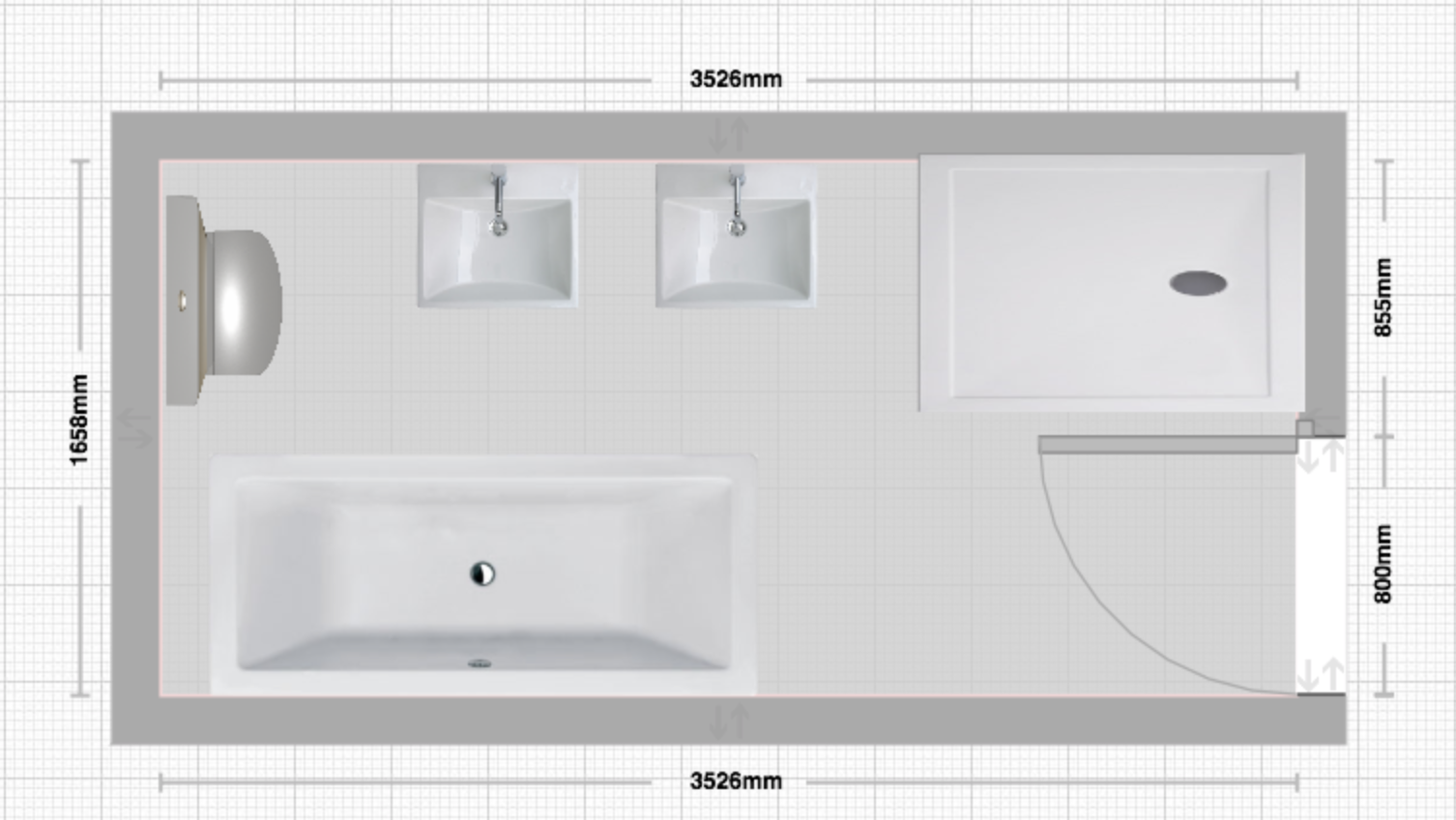

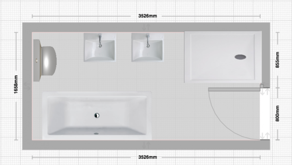

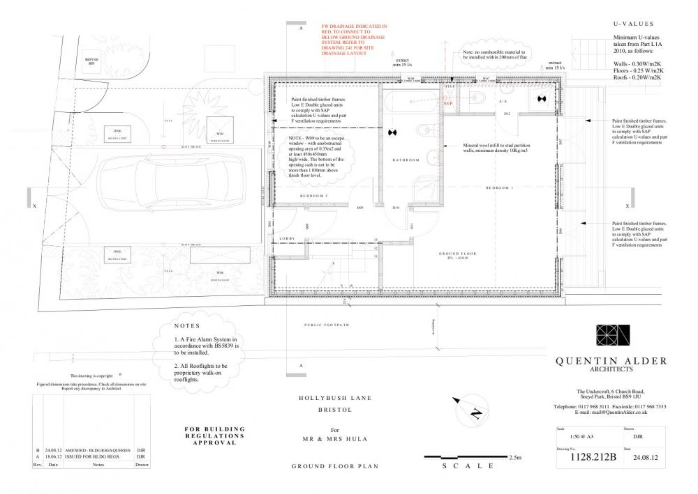

Pocster Posted June 19, 2017 Share Posted June 19, 2017 (edited) Hey all, Please see attached the original architects layout suggestion and also my *rough* alterations. Any suggestions or comments on better use of the space appreciated. The measurements are fairly accurate but I do have some concerns. Measurements are from *outside* of timber frame so don't allow for thickness of it; originally it was 100m now 140mm. This makes the ensuite shower very tight (originally a 80x80cm standard one); due to the walls thickening now maybe a 70cm wide one? . I can't increase the width of the ensuite as the french doors wouldn't line up with the doors beneath. The bath. The bath in our current house is 1.8m ; i realise now this is quite a long bath. In the new bathroom I don't want the bath tight against each wall - always looks 'squashed' too me. I could widen the bathroom or simply get maybe a 1.4m bath instead? Bathroom toilet. We plan on having a wall hung toilet. I understand that wall will need to be thicker to accommodate this; but how thick?. I have found a super slim wall cistern anyone installed one of these?? https://www.livinghouse.co.uk/acatalog/slim-concealed-toilet-cistern-and-frames.html We plan to add an external porch to make up for the removal of the architects solution. I'm planning all this ready for the timber frame. What width should I allow for a door fitting? 100cm?? (to allow for lining , fixing, packing etc.? Cheers Edited June 19, 2017 by pocster Link to comment Share on other sites More sharing options...
ProDave Posted June 19, 2017 Share Posted June 19, 2017 That en-suite is too squashed. Could it go the other side of the room. where you have "storage" taking in also the cupboard off the landing (which is where I would put the shower. Then the WC can go towards the left with the room stepping in if necessary or not going all the way to the windows so avoiding that constraint. Have your "storage" instead where the en-suite is presently shown. Link to comment Share on other sites More sharing options...
Pocster Posted June 19, 2017 Author Share Posted June 19, 2017 (edited) 24 minutes ago, ProDave said: That en-suite is too squashed. Could it go the other side of the room. where you have "storage" taking in also the cupboard off the landing (which is where I would put the shower. Then the WC can go towards the left with the room stepping in if necessary or not going all the way to the windows so avoiding that constraint. Have your "storage" instead where the en-suite is presently shown. Hey! Yeah the ensuite is a squash - TBH it's larger than our current ensuite. It could go the other side and replace the storage & cupboard. Bathroom and ensuite were all put on the same side because the sewer access is that side. Not sure there would be enough of a fall to run from one side to the other for waste etc. beam and block floor. I was concerned about 'stepping' on ensuite/storage not sure it would look right (hence why running right across) Certainly would make for a nice larger shower. But how do I get the waste across? also how does the wet underfloor heating pipes 'cross' the (presumably pumped) waste?. Or do I take the waste high ? (via the ceiling ) across then down? Edited June 19, 2017 by pocster Link to comment Share on other sites More sharing options...

Pocster Posted June 19, 2017 Author Share Posted June 19, 2017 Ensuite as it stands dimensions internally are (allowing for frame + plasterboard etc. ) 70cm x 330cm It won't be quite 330 because some boxing in must be allowed for the flue. So a 70cm shower tray would fit. But allowing for the shower door opening i.e. clearing the sink - might be tight - or might just be my imagination! Link to comment Share on other sites More sharing options...

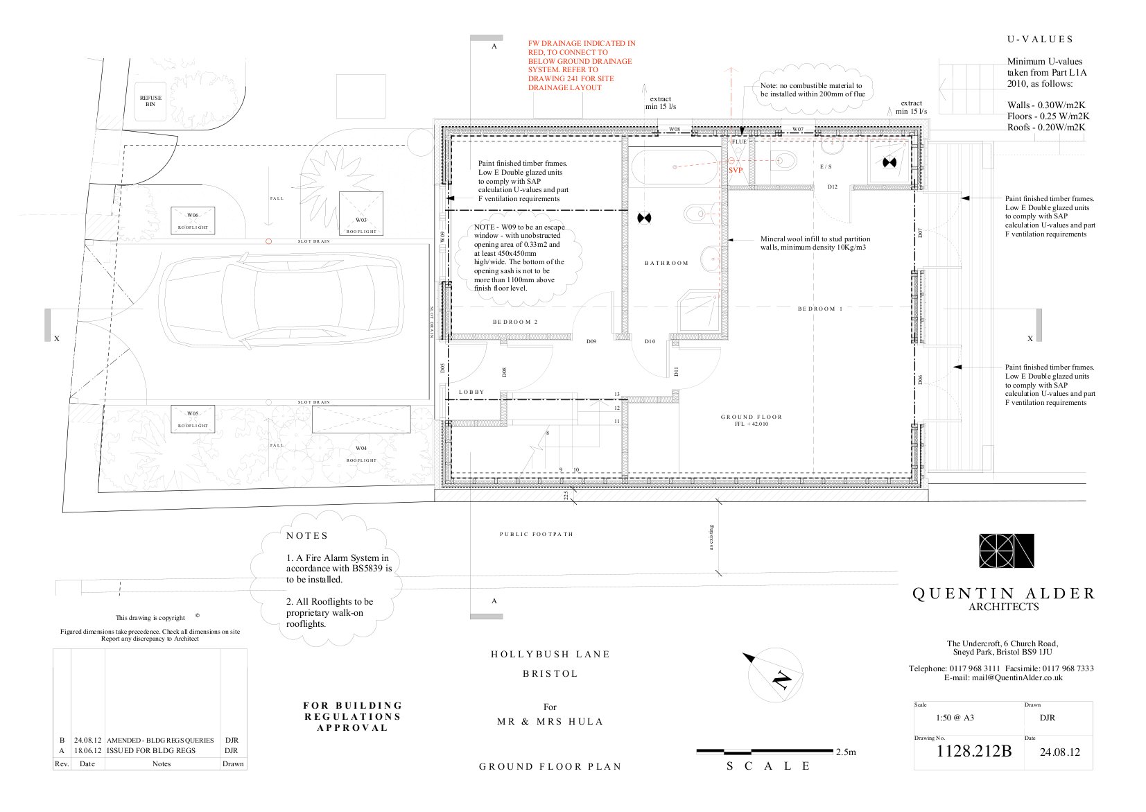

Pocster Posted June 19, 2017 Author Share Posted June 19, 2017 (edited) The architect actually did amend the plans (my fault) here's his final layout Edited June 19, 2017 by pocster Link to comment Share on other sites More sharing options...
ProDave Posted June 19, 2017 Share Posted June 19, 2017 My concern is a 70cm wide shower is tiny. If you re going to keep it that side, swap the shower and loo over, so the loo is in the narrow bit by the window, and the shower can be where the loo is shown, with the room from door stepped outwards. We had the same in the last house and that "limited" us to a 1200mm shower. Agree loo in main bathroom adjoining the bedroom will be an annoyance. Link to comment Share on other sites More sharing options...

Pocster Posted June 19, 2017 Author Share Posted June 19, 2017 1 hour ago, ProDave said: My concern is a 70cm wide shower is tiny. If you re going to keep it that side, swap the shower and loo over, so the loo is in the narrow bit by the window, and the shower can be where the loo is shown, with the room from door stepped outwards. We had the same in the last house and that "limited" us to a 1200mm shower. Agree loo in main bathroom adjoining the bedroom will be an annoyance. Yeah could do i agree 70cm is too tight . regarding loo against wall is there no sound proofing method I can use ?? Link to comment Share on other sites More sharing options...

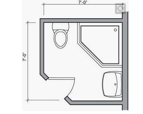

Ferdinand Posted June 19, 2017 Share Posted June 19, 2017 (edited) Here is one idea for something more towards the triangular - the corner could be chopped off more eg if you used a corner whb and a corner wc. I could see this gong down to say 1.7x1.7m. That is a big shower. I do not see the this shower meeting the "big enough for 3 people" test, however. Revolves around a quadrant shower. It comes beyond the french window line, but leaves a useful space in front If you google on things like "small ensuite designs" there are oodles of everything. Edited June 19, 2017 by Ferdinand Link to comment Share on other sites More sharing options...

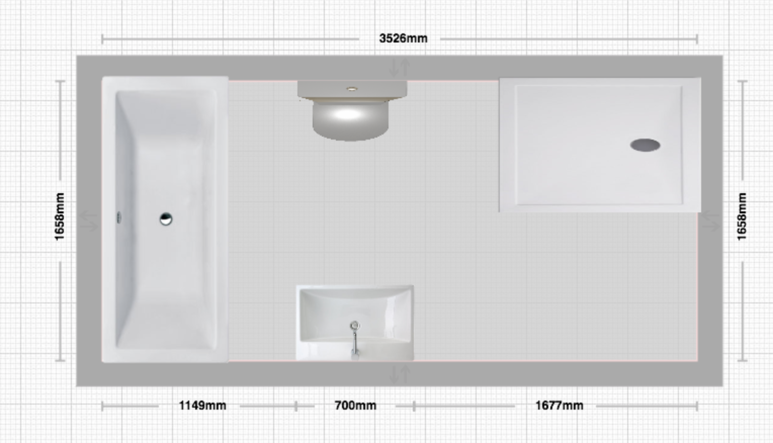

Pocster Posted June 19, 2017 Author Share Posted June 19, 2017 1 minute ago, Ferdinand said: Here is one idea for something more towards the triangular - the corner could be chopped off more eg if you used a corner whb and a corner wc. Revolves around a quadrant shower. It comes beyond the french window line, but leaves a useful space in front If you google on things like "small ensuite designs" there are oodles of everything. Hey! Now that's a neat solution for the ensuite!. The window positions aren't set in stone so could be moved to accommodate. Are you suggesting this arrangement goes 'flue' side? Here's the current bath room layout; and yes I agree with you all now that a toilet on a bedroom wall is a bad idea. This limits things a bit. Attached a suggestion; but is it too tight? (could wides the bathroom a bit to accommodate.... Thanks all! Link to comment Share on other sites More sharing options...
