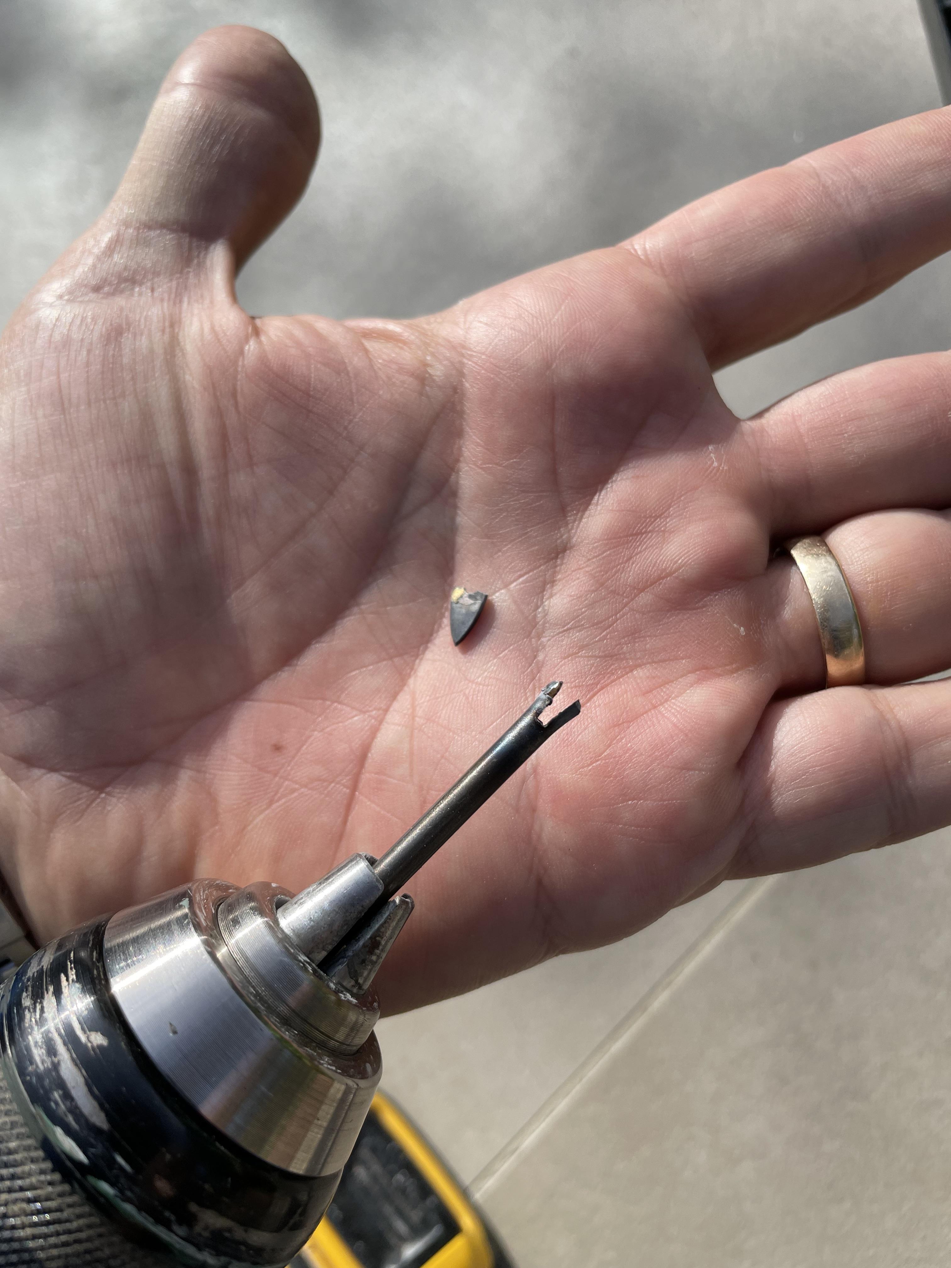

Adsibob Posted October 6, 2023 Author Posted October 6, 2023 So finally got around to trying this out with a spearhead drill bit made by “Universal Fit” bought from screwfix. I took it fairly slow but clearly not slow enough as I managed to break the spearhead off at first attempt: I had my DeWalt drill on the greater torque setting of 2 (out of only two options, 1 or 2) and the other setting on 7. Created a lot of heat and only managed a 6mm depth hole before it broke!
markc Posted October 6, 2023 Posted October 6, 2023 Looks like it overheated and melted the brazed joint. Spear point drills need to be kept cool either with water or compressed air (water is far better) and run slowly.

Adsibob Posted October 6, 2023 Author Posted October 6, 2023 3 hours ago, markc said: Looks like it overheated and melted the brazed joint. Spear point drills need to be kept cool either with water or compressed air (water is far better) and run slowly. Yes, managed to keep the others from melting by drilling partly underwater (was drilling holes into ceramic pots). Not sure how I’ll keep it wet enough when I come to drill the tiles. They are also three times as thick as the ceramic pots!!!
markc Posted October 6, 2023 Posted October 6, 2023 1 minute ago, Adsibob said: Yes, managed to keep the others from melting by drilling partly underwater (was drilling holes into ceramic pots). Not sure how I’ll keep it wet enough when I come to drill the tiles. They are also three times as thick as the ceramic pots!!! Sounds like you need to go for diamond core (or solid for small diameters) bits. Use a piece of ply or timber with a hole to start the diamond bit (they don’t have points or centres) and once started you can keep dipping the bit in water every 10-15 seconds to keep it cool, once you break the hard surface it’s much easier and faster cutting
