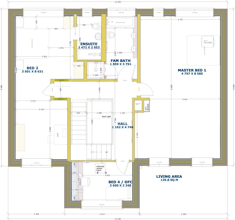

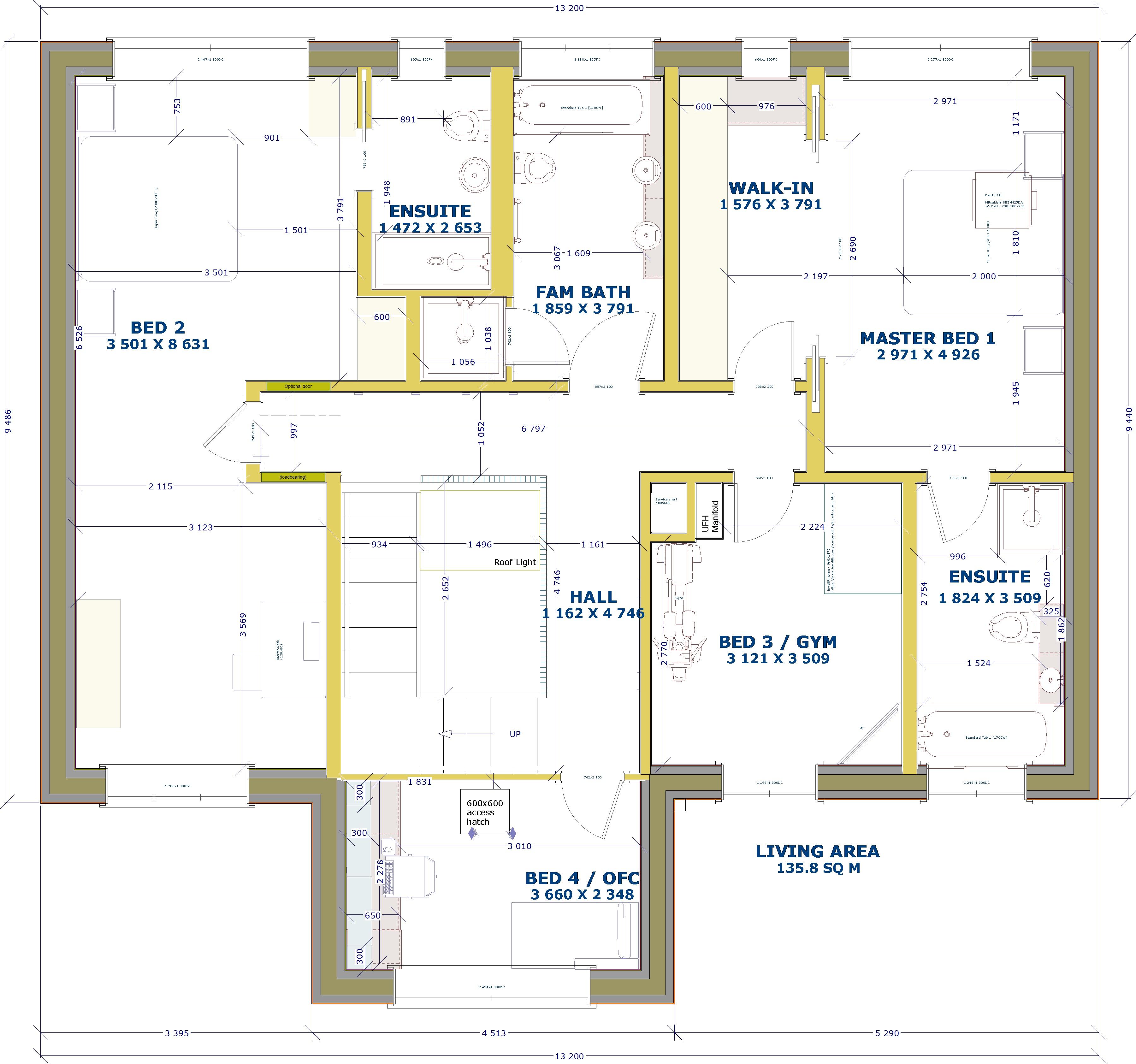

So looking at my Master bedroom suite, our builder is advising against our 'pocket door system' since it might be too noisy when people are sleeping.
Therefore, would love to have your thoughts on how you would fill in essentially a 8.5 x 5 wing, with the following requirements:
Main space
- Needs to fit a king size bed, FCU (aircon) in roof
- Core idea is that the 2 adults go to bed and wake up at different times, so sneaking out, getting dressed (whilst not disturbing with light/noise) is important. We figured the walkin would work but the doors might be too noisy? Or is there a telescopic (2-layer) pocket door system that is whisper quiet?
Walk-in closet (optional I suppose, but we like the idea)
- 600 deep, 550 works
- 3000 wide is sufficient
Gym
- Min size 2x3m
- Service shaft is fixed, manifold could be moved.
Ensuite
- Needs a bath
- shower semi-optional, could use the bath
Current design: as you can tell a roomy gym, and the pocket door makes the master feel large when opened whilst giving space to get dressed/undressed.

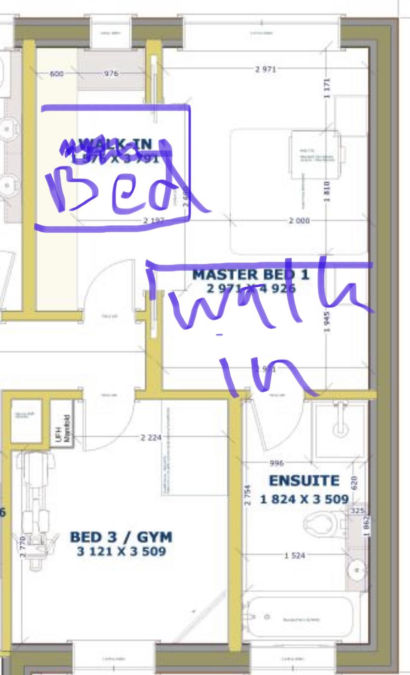

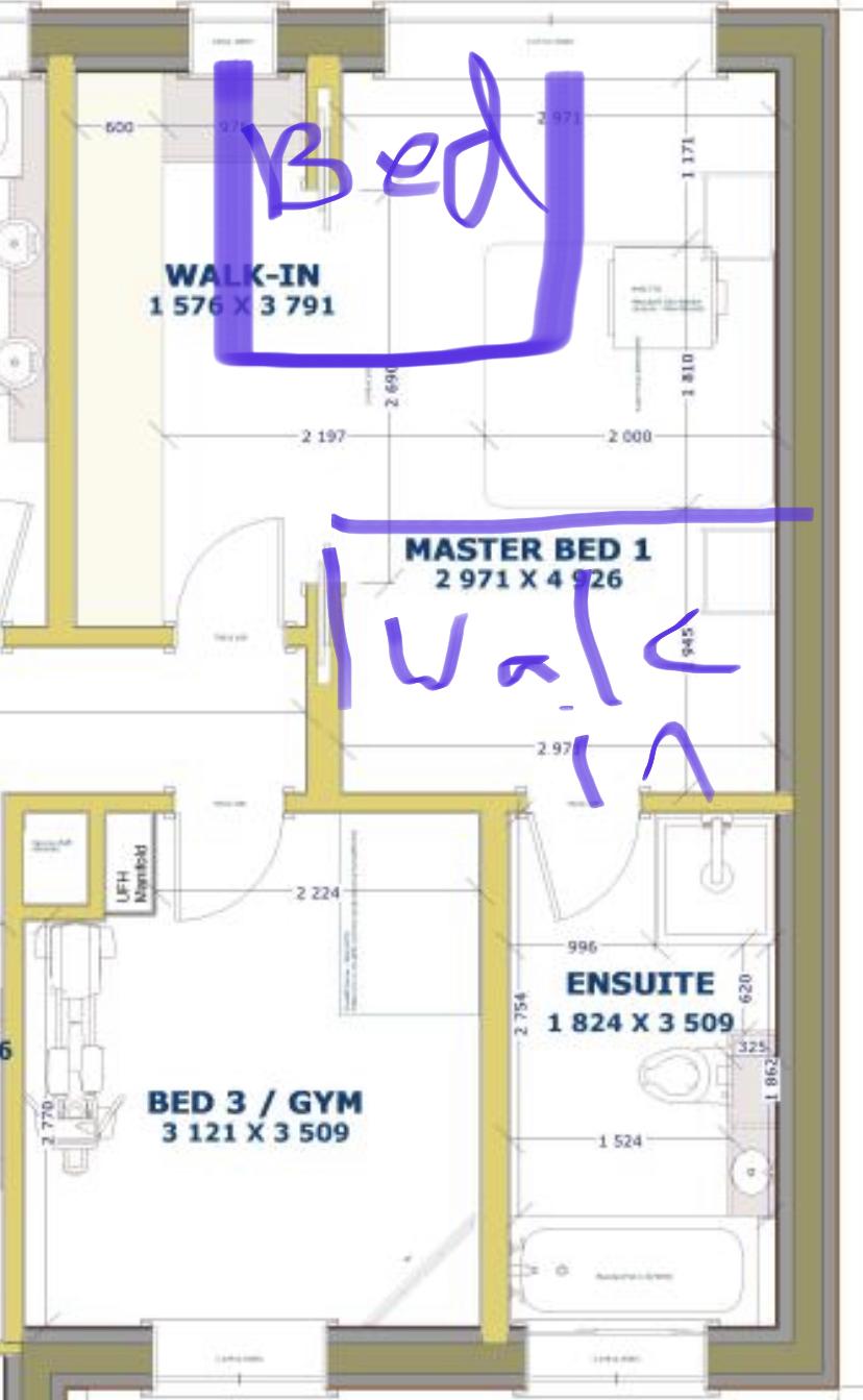

Posted
I have an idea, but I think it would only work if you can move your windows. Hear me out:
In my experience using the bathroom is noisier than the wardrobe, particularly if you can pick out tomorrow’s outfit when your partner is still awake. So I would place the walk in wardrobe in between the bathroom and the bedroom, to give the bathroom some extra noise insulation. I’m not sure you need a sliding pocket door for the walk in wardrobe. Just make it one communal walk in area with one regular (but fairly narrow) door.
The two options I can think of to achieve this are.
Option 1
Problem with Option 1 is that the location of the bed is really sub optimal. Walking into a bedroom and hitting the bed like that is just awkward. And it’s a bad use of space as the top right hand corner is wasted and the bed area is cramped.
 So Option 2 fixes these issues, but you would need to move the windows:

First, thank you! :)
I think we have some potential to move windows, we could consider it. Obviously (?) one of the reasons we positioned the walk in is to have daylight to judge clothing colors but it's not a huge deal
55 minutes ago, Adsibob said:
One question on your en-suite: the shower cubicle (if that is what is drawn in the top right hand corner of the bathroom) looks small. Does the gym need to be that big, or could it be smaller?
The point of the gym size is primarily to also allow a the provisional elevator gap. With your design #2 I guess that wall could move slightly
Do you need a separate shower cubicle, or could you make your bath bigger and combine it with the shower. Do you need a bath? Sometimes, less is more.
Bath is required, shower strongly preferred, yes.
I like your option 2, let me see if there's some options to do this.

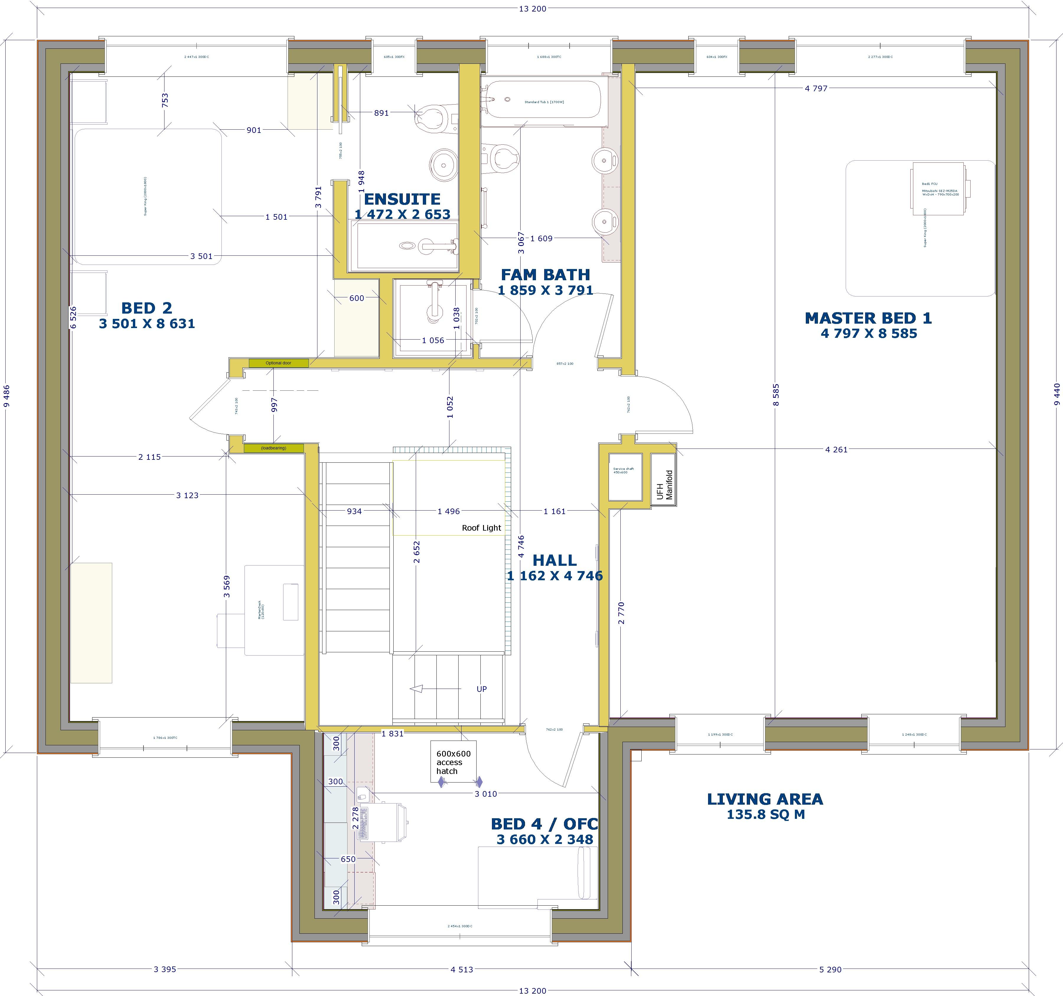

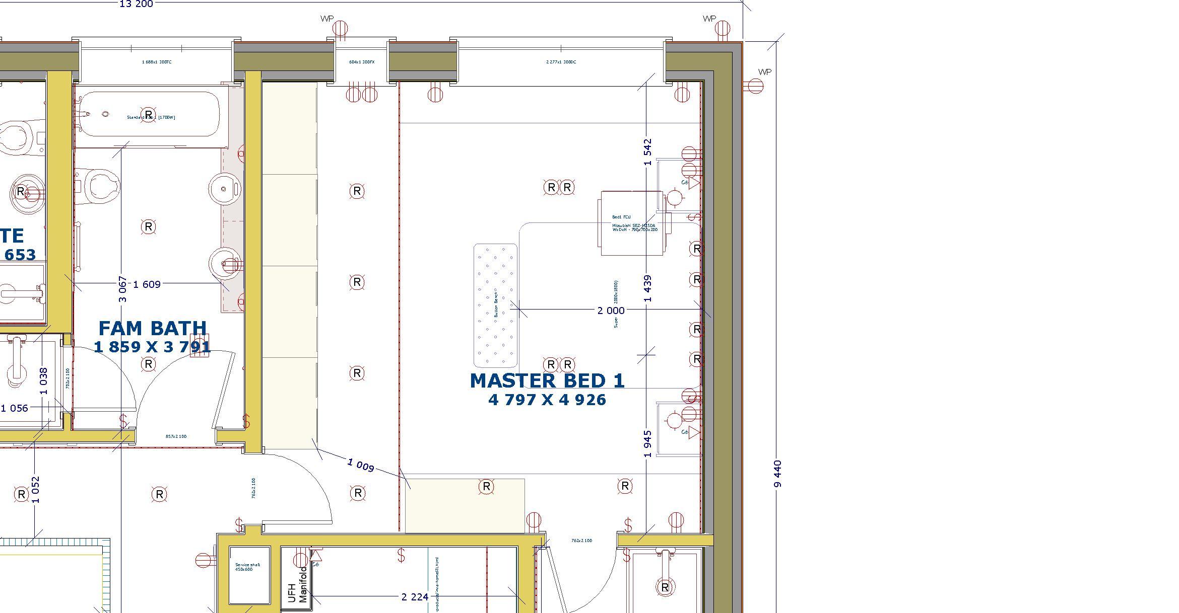

An update, I've updated my design somewhat to open up the space:
image.thumb.jpeg.4334f7b1f8967d741d06a52bb5d6677b.jpegimage.thumb.jpeg.8a77542f2ce7811c705c56d748b2fa28.jpeg
Obviously much more spacious, just a small worry around people barging into the room, perhaps I should build a separator in front of the door?
Posted
4 hours ago, dpmiller said:
put a lock on the door?
Absolutely.. but it's one of tho se human things where you still want to be "facing the door" or facing walls, and somehow a separator might improve things
