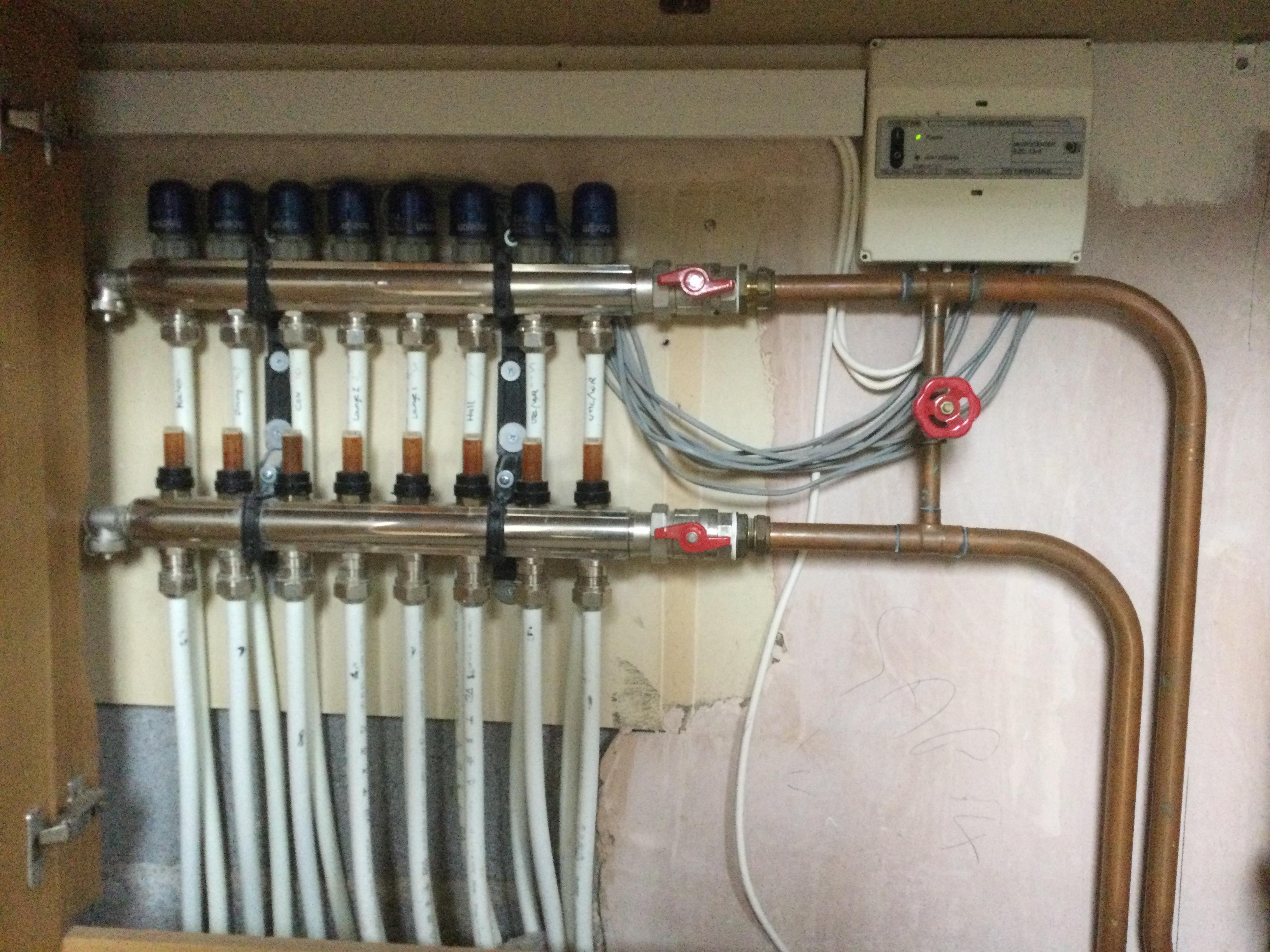

pacemaker1000 Posted September 30, 2022 Share Posted September 30, 2022 Sorry no pic yet but my manifold has no temperature gauges and only a manual stopcock between flow and return. so how do I know how to adjust the stopcock so the cooler return water ensures the correct temperature in the flow? considering a clip on thermometer and turning stopcock until it’s around 40 degrees? setting boiler at 40 degrees and turning stopcock off? thanks Link to comment Share on other sites More sharing options...
JohnMo Posted September 30, 2022 Share Posted September 30, 2022 Not sure what you mean by a stop cock. The manifold should have a mixer valve and pump, the flow loops each have manual valve or actuator and a flow meter. The mixer valve set that to the flow temp you need. The manual loop valve, open fully. Set the flow to the flow required for the loop length. If all room get too hot the mixer valve temp needs reducing, too cool increasing. Once these are set you can fine tune the room temperature. Increase flow will give a smaller difference between flow and return and increase heat transfer to room, reducing flow to opposite. Link to comment Share on other sites More sharing options...

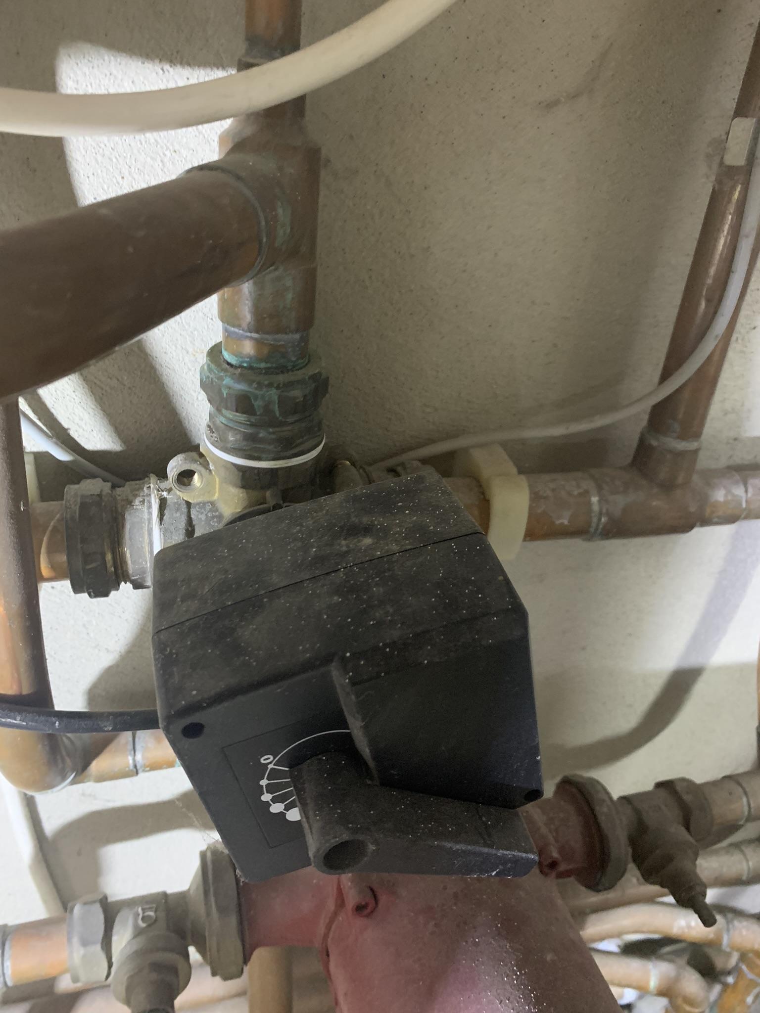

pacemaker1000 Posted September 30, 2022 Author Share Posted September 30, 2022 (edited) Hi guys, yes it’s a mixer valve no a stopcock sorry. Wrote that to better describe its physical appearance as can be seen in the new pic. pump is back by boiler not near manifold and as you can see no temperature or pressure gauges. So no way to know where to set the mixer.? Edited September 30, 2022 by pacemaker1000 Link to comment Share on other sites More sharing options...

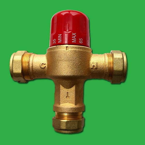

JohnMo Posted September 30, 2022 Share Posted September 30, 2022 That's not really a mixer valve, as a proper mixer valve modulates to maintain the flow temp. You would need something like this (first image I found). Your system is relying on the heat source controlled flow temp, so has no real protection from over temperature. Link to comment Share on other sites More sharing options...

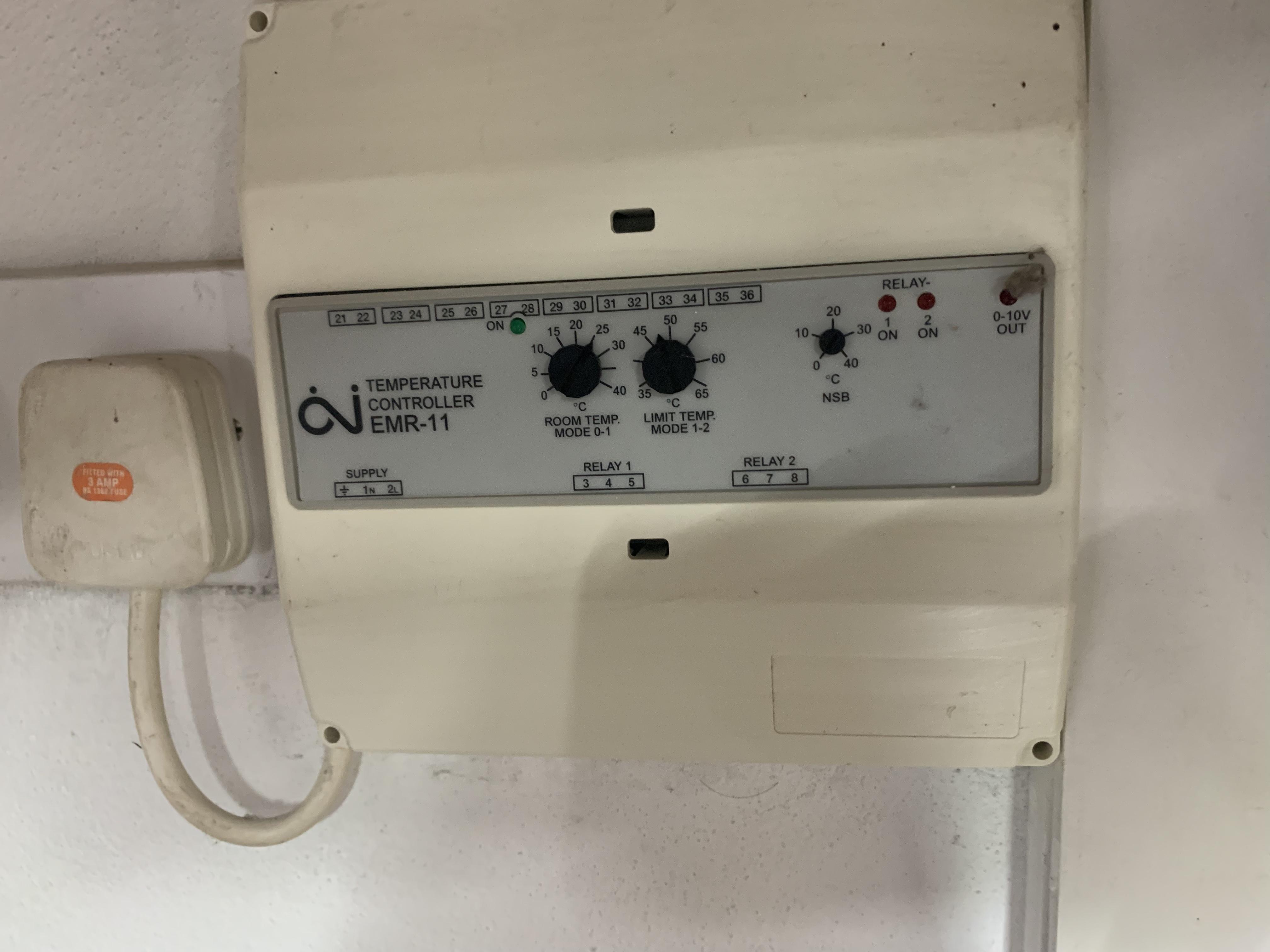

pacemaker1000 Posted September 30, 2022 Author Share Posted September 30, 2022 (edited) Ok it’s starting to make sense I think 🤔 back at the boiler there is a 4 way controller I assume is for temperature control see pic. It has five settings and is currently on '0' It connects to boiler flow, manifold pump, manifold return and boiler return there is also a temperature sensor zippa tied to the manifold flow. see pic of temperature control panel and please advise on setting. All my underfloor is in concrete! with this in mind my thought is the original post and pic of control valves on actual manifold , this is redundant and should be fully closed as it interferes with the 'proper' temperature control near boiler as it effectively cools the set temperature in the flow? I assume it’s located there as I have two manifolds , second one upstairs, and this is able to control both? would be nice to have a physical temperature gauge to check it is does g what it should. Maybe a clip on one somewhere thanks Edited September 30, 2022 by pacemaker1000 Link to comment Share on other sites More sharing options...
ProDave Posted September 30, 2022 Share Posted September 30, 2022 Total bodge. My opinion, you need a new plumber, one not wearing spurs. You didn't answer the context, has this just been put in in your house or is this a house you bought like this? That gate valve at the manifold needs replacing with an automatic bypass valve. Link to comment Share on other sites More sharing options...
pacemaker1000 Posted September 30, 2022 Author Share Posted September 30, 2022 (edited) This was in house on purchase. so does it work as I described? why would I need a gate valve or any valve on the manifold given the setup! looks like in theory setup is correct just that it’s at the boiler not the manifold to save having to do it twice for second floor. valves on manifold were a mistake control panel set to room temp of 25 which is about right also max of 40 makes sense for UFH? Edited September 30, 2022 by pacemaker1000 Link to comment Share on other sites More sharing options...
billt Posted September 30, 2022 Share Posted September 30, 2022 I wouldn't be so quick to condemn it. The black box above the pump is controlling a blending valve, so it might not be as bad as people are assuming. If the system is only UFH with no radiators then it's probably a perfectly acceptable system. These valves usually have a controller to set the temperature so I'd guess that the temperature sensor on the manifold flow does to a controller (presumably the off white box labelled EMR-1) and the controller sets the blending valve to the right temperature. Just because it doesn't look like a modern installation doesn't mean that it's defective. Link to comment Share on other sites More sharing options...
JohnMo Posted September 30, 2022 Share Posted September 30, 2022 Not sure I agree it's a total bodge. Just an older way of doing things. Here are a copy of the operation instructions emr-11.pdf 1 Link to comment Share on other sites More sharing options...
pacemaker1000 Posted September 30, 2022 Author Share Posted September 30, 2022 Cheers guys especially for the PDF diagram. This is exactly my setup! I do have two manifolds and both are in concrete so same temperatures. any ideas on settings for 'room temp' and 'limit' I thought the ideal temp was about 40 degrees so expected to see a dial to select that not room temp set to 25 degrees as that is the desired room temp controlled by individual stats in the rooms? also don’t see point in mixing valve on each manifold when both require the same temp from the boiler? if the flow is sending 40 degrees to each zone why would you want to cool that down with the return cool water?? cheers Link to comment Share on other sites More sharing options...
JohnMo Posted September 30, 2022 Share Posted September 30, 2022 Previous owner obviously liked a hot house. Room temp, set to what is comfortable to you. Let's say 19-20. Limit, set it low say 30-35 deg, if your room doesn't heat up after a about 6 hours add a little more heat. You want flow temp (limit), as low as possible to prevent temperature overshooting. Your flow temp depends on your insulation and general house insulation. The better the insulation the lower the flow temp. Leave the system as it is, your system does the the same as mixers on each manifold. Link to comment Share on other sites More sharing options...
pacemaker1000 Posted September 30, 2022 Author Share Posted September 30, 2022 So you saying 30-35 is the flow temp? any thoughts on the manifold mixers? Why would you use them if the flow temperature is already set correctly? Link to comment Share on other sites More sharing options...
JohnMo Posted October 1, 2022 Share Posted October 1, 2022 You don't have manifold mixers? Use what you have got. Link to comment Share on other sites More sharing options...
pacemaker1000 Posted October 1, 2022 Author Share Posted October 1, 2022 1 hour ago, JohnMo said: You don't have manifold mixers? Use what you have got. I do have them but turned them off as temperature already controlled by blending valve doesn’t make sense to cool down the controlled temperature with cold water 🤷🏼♂️ Link to comment Share on other sites More sharing options...
JohnMo Posted October 1, 2022 Share Posted October 1, 2022 The pdf I attached, states that it is a by pass valve, it's not a blending valve. It's there to give a min flow rate, so if one or more room thermostats have switched of the manifold actuators the pump still has a flow path. It would have been set during commissioning, so hope you recorded it's position before moving things about. It needs to be part open. 1 Link to comment Share on other sites More sharing options...
pacemaker1000 Posted October 1, 2022 Author Share Posted October 1, 2022 Both open just a quarter turn Link to comment Share on other sites More sharing options...
