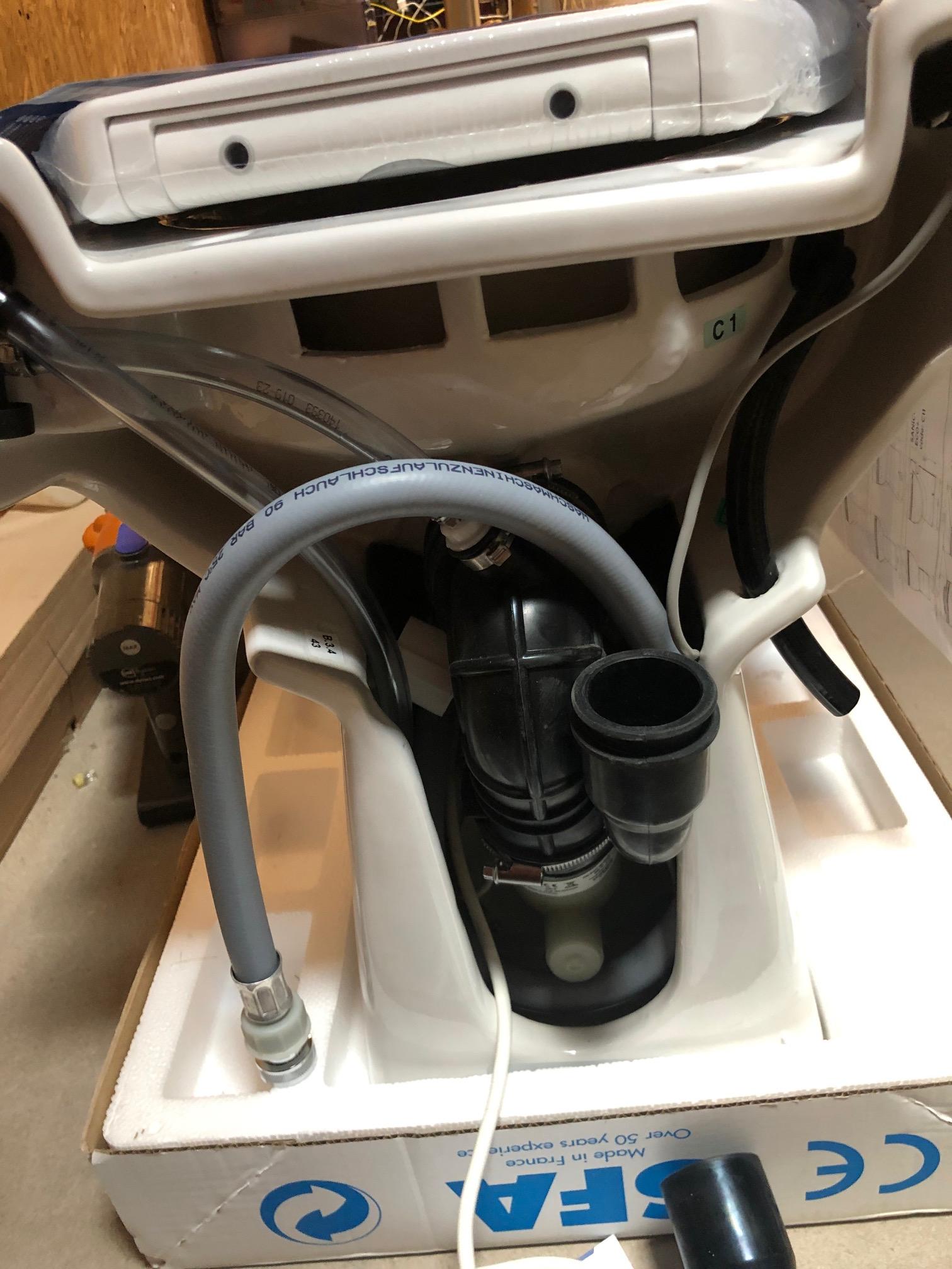

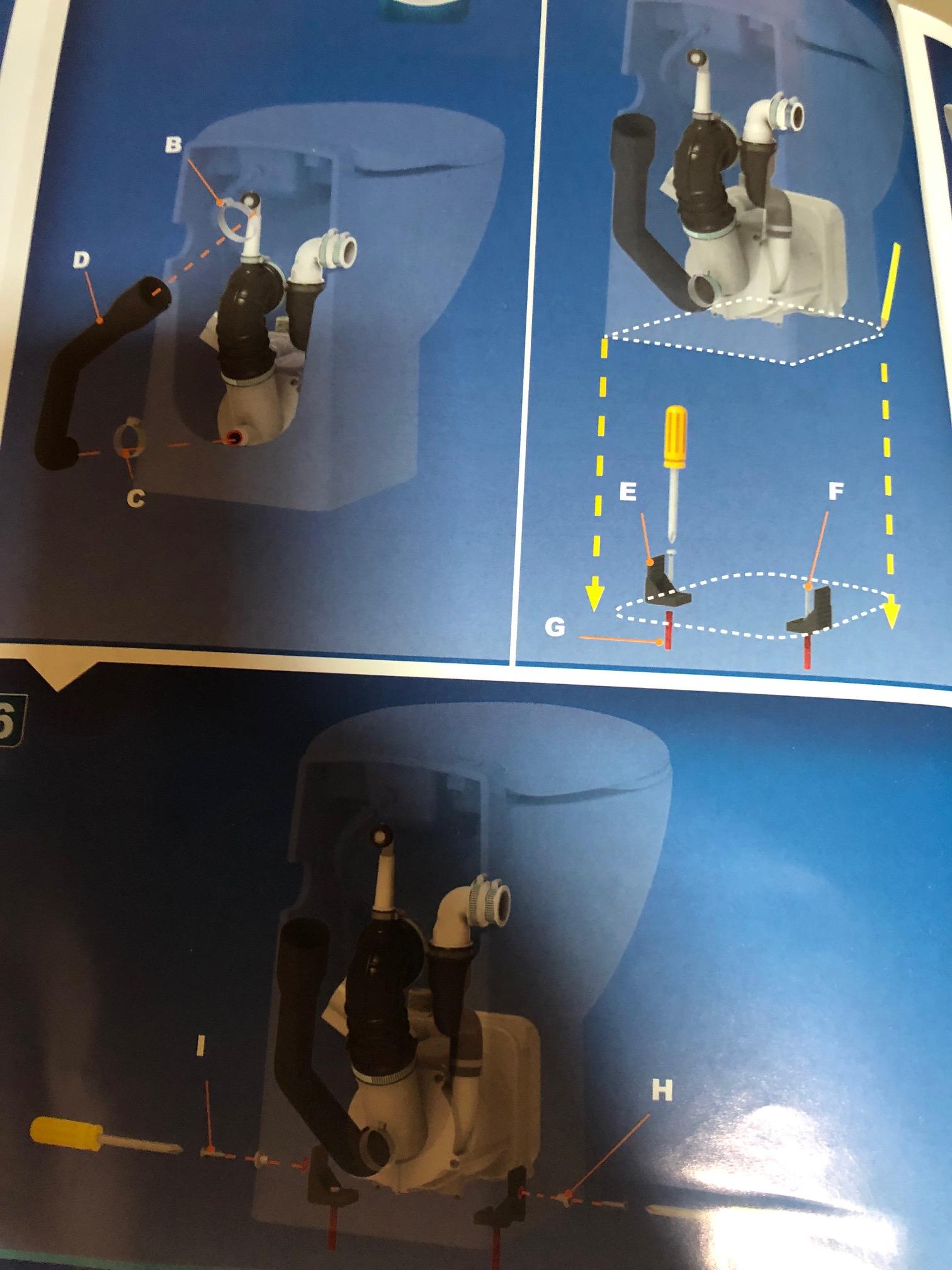

Pocster Posted September 28, 2022 Posted September 28, 2022 Looking at the instructions for this ( you know the type all piccy's no words) Looking at the back of the macerator there are clear pipes top left and a black pipe ( ducting?) top right - can't see any mention of them in the pic's - what are they for? Also this black pipe which they show somehow fitting to the base ; I don't get it. Water in easy, electrics in easy, waste out to the right easy. What's all this other stuff????
Pocster Posted September 28, 2022 Author Posted September 28, 2022 (edited) Decided to call saniflow.... Pipe at base is for a basin input Clear pipes top left are some sort of air admittance type valve i.e. leave alone Top right pipe is an overflow which in theory should never have anything coming out of it but can. Apparently reducing water pressure can reduce this 'drip' There - so we all learnt something today! Edited September 28, 2022 by pocster
