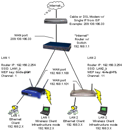

dogman Posted June 18, 2017 Author Share Posted June 18, 2017 Thanks for all the information everyone. looks like best option for me is two separate Lans Use whatever kit i get from Gigaclear as route to the internet. This will be in the Cloaks Cupboard. Take two links from the Gigaclear kit. one for home network and one for cctv below is not exactly what i will do but near enough. (Ignore all the addresses and keys as diagram is copied from internet) The Gigaclear kit has wireless and gigabit ports https://www.gigaclear.com/wp-content/uploads/DRG700-version-2-Quick-Installation-Guide-.pdf This is the standard kit, there is an upgrade. We were offered a business connection and you can choose the equipment to match your needs. From the Gigaclear kit i will take two links. (in both copper and fibre SPF compliant) One pair stays in the cupboard and is fed into a decent wireless router to provide wireless around the house. From the wireless router i would connect a port to a switch for the wired household Lan Switch does not need POE although if i can get one cheap to run phones etc ( if i use Voip) i will. 16 ports should be okay to start. Wire house with as many cables as i can fed back to cupboard into patch panel. Second pair to the plant room for cctv Use an old gigabit router as connection, fed to a 16 port POE+switch. CCTV dvr will connect to one of the router ports CCTV cameras will be fed into switch. It will only have 15 spare ports but can always add a second switch or bigger one if needed. DVR supports network storage so the router could also be used to link a NAS to the DVR. If i have understood this correctly. i should have two LANS totally isolated from each other. Both with internet access. Both with hardware firewalls provided by the Routers. Catx cables would be halved in each location making an easier install Link to comment Share on other sites More sharing options...
PeterW Posted June 18, 2017 Share Posted June 18, 2017 So unless there is some complex firewall / layering going off on that router, both of your LANs will be bridged and use the same DHCP range etc as the 4 ports on the router are connected. With most broadband suppliers the first two components in that stack are combined as a modem/router. Also look at VOIP PoE phones as they are so much easier to reposition and you don't need the horrid base stations with 12v wall warts everywhere ..! Link to comment Share on other sites More sharing options...
dogman Posted June 18, 2017 Author Share Posted June 18, 2017 @PeterW sorry to be thick, but does this mean the Lan's will not be separate. I do not really understand netwoking. I tend to search for a way of doing something try it and be pleased with myself when it works. I did this initially with DDWRT where i set up VLAN detached networks on a buffalo router. this fed two routers for two wifi hotspots one for us and one in the rental cottage. I followed instructions but did not really understand how i got it working. 1 Link to comment Share on other sites More sharing options...
PeterW Posted June 18, 2017 Share Posted June 18, 2017 Correct - DDRWT has been used for a long time in the Linux community to support layering in the likes of the older D-Link routers by flashing the firmware but it wouldn't be useable in this instance. You would have two physically segregated LAN segments as they would be on different physical infrastructure however at a logical level they would share DHCP, gateway and firewalls at the internet router unless there is something buried in the Genexys setup that allows you to stop traffic spanning across the router. What is neat is that it has USB port where you can put a USB storage drive - neat addition for a SoHo based unit. Link to comment Share on other sites More sharing options...

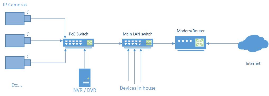

reddal Posted June 18, 2017 Share Posted June 18, 2017 You dont need the two LANs to be completely seperate - you don't even need different subnets - you just need to make sure that the camera traffic doesn't contend with the rest of the house - ie there is no bottleneck that all traffic has to go through. e.g. I'd imagine something like this : Here the main camera traffic will go from the cams to the NVR/DVR without ever bothering the rest of the network - however the PoE switch can still be connected to the rest of the network - but that will only be used if accessing the cameras setup page or accessing NVR over network etc - ie occational and lower bandwidth usage. - reddal Link to comment Share on other sites More sharing options...
PeterW Posted June 18, 2017 Share Posted June 18, 2017 @reddal because the PoE switch will unlikely have a set of routing tables you will have to use the modem as a DHCP server so all traffic has the potential to go via that first switch. If you had the two switches off the two gig ports on the router then it would work fine. It would still be a shared DHCP and gateway. Link to comment Share on other sites More sharing options...
reddal Posted June 18, 2017 Share Posted June 18, 2017 2 minutes ago, PeterW said: @reddal because the PoE switch will unlikely have a set of routing tables you will have to use the modem as a DHCP server so all traffic has the potential to go via that first switch. Why would it be a problem to use the modem as a DHCP server? The DHCP server would only be used when each device starts up - it doesn't affect ongoing traffic? The PoE switch won't have routing tables - but it will maintain an internal list of which MAC addresses are accessible via which ports - and push traffic to the correct port accordingly. If that didn't work then the traffic would never get to its target at all. Connecting the 2 switches via the router would work - but I don't see what it adds unless you want to do something extra like setup firewall rules about what traffic can go from one switch to another. Link to comment Share on other sites More sharing options...

reddal Posted June 18, 2017 Share Posted June 18, 2017 29 minutes ago, dogman said: So the issue is the Genexis modem router. If i understand correctly. The point where the traffic tries to access the internet is where the traffic mixes with the other LAN Yes - the router provides access to the internet and can do this for all parts of your LAN. I would just use it as this - ie the router provides ip addresses via DHCP to the whole network and therefore becomes the default gateway for all devices and any traffic with an address outside your local subnet will go to the router and then to the outside world. You can just have a single connection to the router to provide this - connected to your main LAN switch. Quote However as @reddal has suggested if his method allows the CCTV traffic to do its own thing up and to the point it access the internet and the Home Lan to do the same, do i really need to worry that if someone on the home lan wants to see the cctv by running client software other than at that point in time there maybe a bottleneck at the Genexis unit as it routes traffic between LANs Accessing the CCTV from the main network should be fine - its only a fraction of the raw camera traffic and only occational. I wouldn't use the Genexis unit to route traffic between LANs - in fact I wouldn't have different LANs at all - just a single LAN with a single subnet - but a direct route from cameras to DVR. Or maybe you want a seperate LAN so you can control security between them? ie prevent anything from the camera side of the LAN from accessing the rest of the house? If not I wouldn't bother doing anything complicated - and keep the router doing the basic task only. Link to comment Share on other sites More sharing options...
reddal Posted June 18, 2017 Share Posted June 18, 2017 (edited) By the way - I would probably setup the IP cameras with static IP addresses - so your security system isn't at the mercy of the router having a problem or some other DHCP issue. Your DVR might even require static IP addresses. If so set the default gateway to be the address of your router if you want the cameras to be able to access the outside world. Edited June 18, 2017 by reddal Link to comment Share on other sites More sharing options...
PeterW Posted June 18, 2017 Share Posted June 18, 2017 7 hours ago, reddal said: Why would it be a problem to use the modem as a DHCP server? The DHCP server would only be used when each device starts up - it doesn't affect ongoing traffic? The PoE switch won't have routing tables - but it will maintain an internal list of which MAC addresses are accessible via which ports - and push traffic to the correct port accordingly. If that didn't work then the traffic would never get to its target at all. Connecting the 2 switches via the router would work - but I don't see what it adds unless you want to do something extra like setup firewall rules about what traffic can go from one switch to another. I think that was the whole point - my query was probably why go through switch A to get to the PoE Switch B when the router has 4 ports so I probably wasn't clear ..! I can't see any fancy firewalls in that supplied unit spec so unless you're into managed switches etc then there doesn't seem any benefit to creating multiple vLans. Link to comment Share on other sites More sharing options...
dogman Posted June 19, 2017 Author Share Posted June 19, 2017 20 hours ago, reddal said: Again thanks for looking at this for me. I'll wire the house to set the system up as above. it addresses my issue of using two locations and keeping the cctv traffic away from the house network 1 Link to comment Share on other sites More sharing options...
