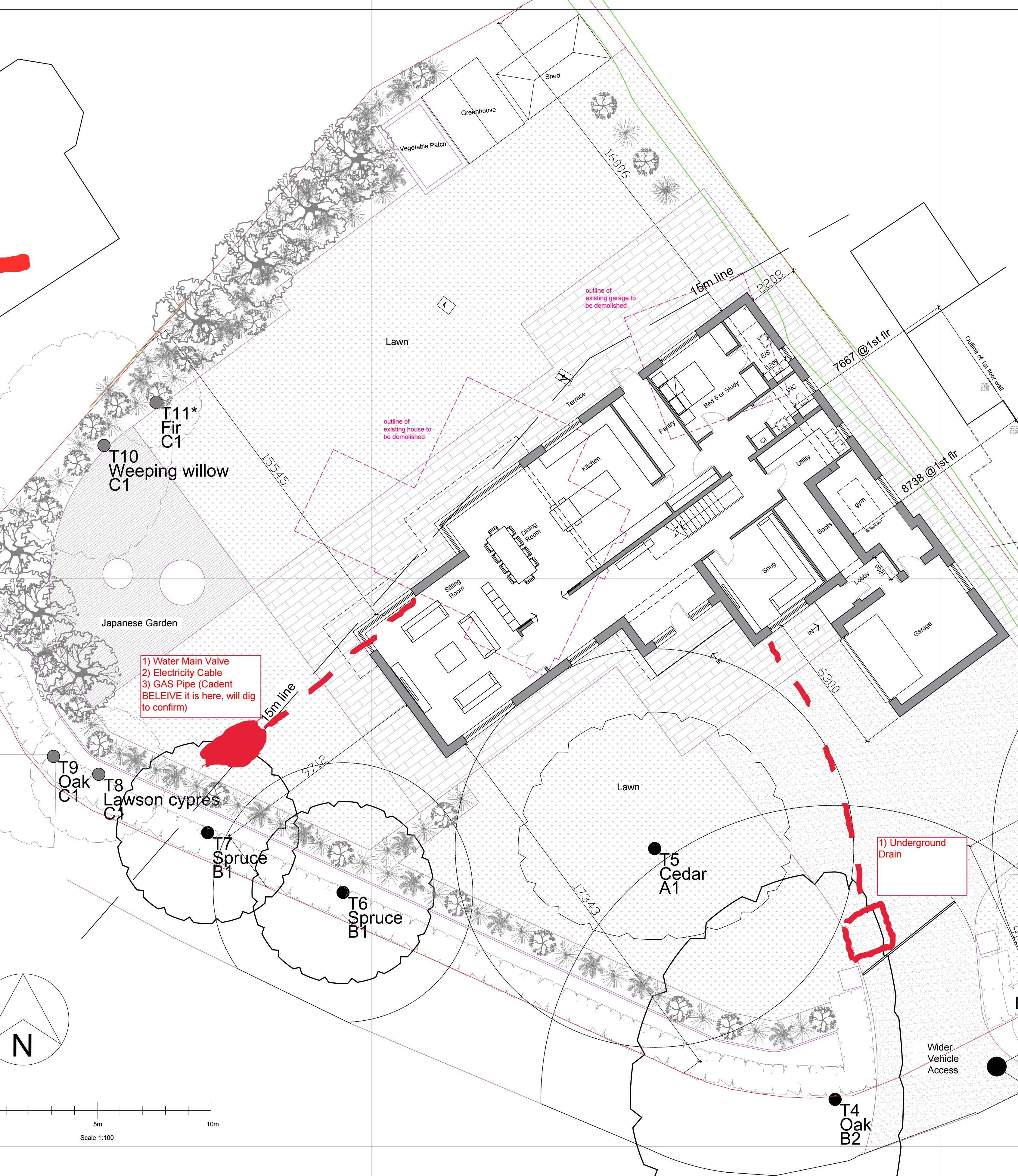

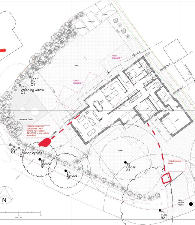

Renegade105 Posted September 26, 2022 Share Posted September 26, 2022 Hi, @PeterW @Thorfun Sorry for the hijack but in need of some insight here. We have the temporary external single-phase supply on the boundary for the build but will eventually change to a 3 phase as I will have an EV, and a very hungry ASHP plus a workshop so I will get close to the 100A easily. We will have an insulated foundation KORE with an ICF house. Can someone please help me in designing the underground services here? we don't have an M&E, we are relying on trades such as CVC for the design of the MVHR, ASHP etc, UFH is Wunda, Plumbing was by architect. I assume you guys would recommend on installing an external floor mounted kiosk somewhere near this temp site, what size would you advise for the 3Phase electric kiosk? I am happy mounting this to the outside of the house too as it will only be a few meters away from the temp site anyway (appx 4m). Does then the Gas meter get installed here in its own external kiosk too? For the house, I suppose everything internally can be run on single phase, but how would you suggest the setup for the ASHP and the garage and the EV. I can see us having 2 in the future (fund allowing). do you need a 100A TP&N isolator in the kiosk after the meter, and then a 5 core cable run underground in conduit and up and into the house at the utility, to another 100A TP&N isolator and then wire up a single phase to the CU? What about getting 3 phase to the garage etc? Here is my site plan and house, ALL of my plant room essentials will be in the Utility room. As ever, many thanks. Link to comment Share on other sites More sharing options...
PeterW Posted September 26, 2022 Share Posted September 26, 2022 31 minutes ago, Renegade105 said: 3 phase as I will have an EV, and a very hungry ASHP plus a workshop so I will get close to the 100A easily. Whats “very hungry”, who specced it and why are you going ASHP when you’ve got gas available ..?? Workshop - not on the plans, do you mean the garage..? 3Ph kit (mill / lathe etc) or just thinking you need a lot ..? 32 minutes ago, Renegade105 said: Can someone please help me in designing the underground services here? we don't have an M&E, we are relying on trades such as CVC for the design of the MVHR, ASHP etc, UFH is Wunda, Who’s plugging that lot together ..?? Is it you..? As…. It’s not that easy, and you need a decent plan on how it works - wired vs wireless for stats etc, multiple switch scenarios for heat and so on. 33 minutes ago, Renegade105 said: Plumbing was by architect. Would have been better asking the milkman, but let’s move on … 34 minutes ago, Renegade105 said: We will have an insulated foundation KORE with an ICF house. what’s your heat loss calculation as this doesn’t match with the ASHP requirements 35 minutes ago, Renegade105 said: do you need a 100A TP&N isolator in the kiosk after the meter, and then a 5 core cable run underground in conduit and up and into the house at the utility, to another 100A TP&N isolator and then wire up a single phase to the CU? What about getting 3 phase to the garage etc? ask your electrician - this is not something you need to make a mess of as it could / will be expensive to correct. Personally - and now seeing the plans - I would run a pair of phases to the side of the garage externally and then run the car chargers off a phase each. If you’re desperate to go 3Ph charging as you find the money for a Tesla that’s a different issue, but tbh I’m struggling to see how you’re above 100A on a phase here. 38 minutes ago, Renegade105 said: Does then the Gas meter get installed here in its own external kiosk too? Is this only for cooking..?? If so.. just go get an induction hob, and save yourself about £10k on install costs. Link to comment Share on other sites More sharing options...
Thorfun Posted September 27, 2022 Share Posted September 27, 2022 19 hours ago, PeterW said: 20 hours ago, Renegade105 said: Plumbing was by architect. Would have been better asking the milkman, but let’s move on … 😂 19 hours ago, PeterW said: 20 hours ago, Renegade105 said: do you need a 100A TP&N isolator in the kiosk after the meter, and then a 5 core cable run underground in conduit and up and into the house at the utility, to another 100A TP&N isolator and then wire up a single phase to the CU? What about getting 3 phase to the garage etc? ask your electrician - this is not something you need to make a mess of as it could / will be expensive to correct. +1 to this. my electrician told me what to buy and just came and fitted it. I wouldn't like to give advice that might be wrong on a subject like this! 20 hours ago, Renegade105 said: I assume you guys would recommend on installing an external floor mounted kiosk somewhere near this temp site, what size would you advise for the 3Phase electric kiosk? the DNO told me what size kiosk to buy and where to site it after discussions during the initial site survey. each DNO may have different requirements. but, I would suggest bigger is better as it seems to fill up pretty quickly especially if you do need a TP&N isolator as they're rather large! here's what we did (note: this is not a recommendation of what to do as it might not work for you!) we installed a W750xD400xH1250 kiosk and the DNO (UKPN) came and installed the 3-phase head. our groundworkers ran a 110mm twinwall duct from the cabinet to the plant room in the basement which we pulled through a 25mm 5-core cable (which is bloody heavy!). our electricity supplier then came and installed a single-phase smart meter to one of the phases at the head. our electrician then wired the tails and the 5-core 25mm cable in to our TP&N switched fused isolator in the kiosk. he then terminated that into another TP&N isolator in the comms room to allow for future expansion to run a 3-phase supply to the garage for EV charging (if required). he then took a single phase and terminated it in the CU. so we are running our whole house off a single phase but have the capability of 3-phase later on if required. e.g. if we ever built a pool house we could run a cable through the ducting I've installed to the comms room and tap in to the TP&N isolator there. or could run a 3-phase connection to the garage etc. my advice with underground work is to try and think where you might need power and/or network as it's a lot easier to run it at build stage rather than after. I know as I've just had to dig 50m of trench to fit 4 x 63mm ducts for power and network to the proposed chicken house and pool house! glad I did it now though rather than have to dig up the garden and patios etc to run it later. the pool house ducts will just be left underground and can be dug up if we ever need them. Link to comment Share on other sites More sharing options...
