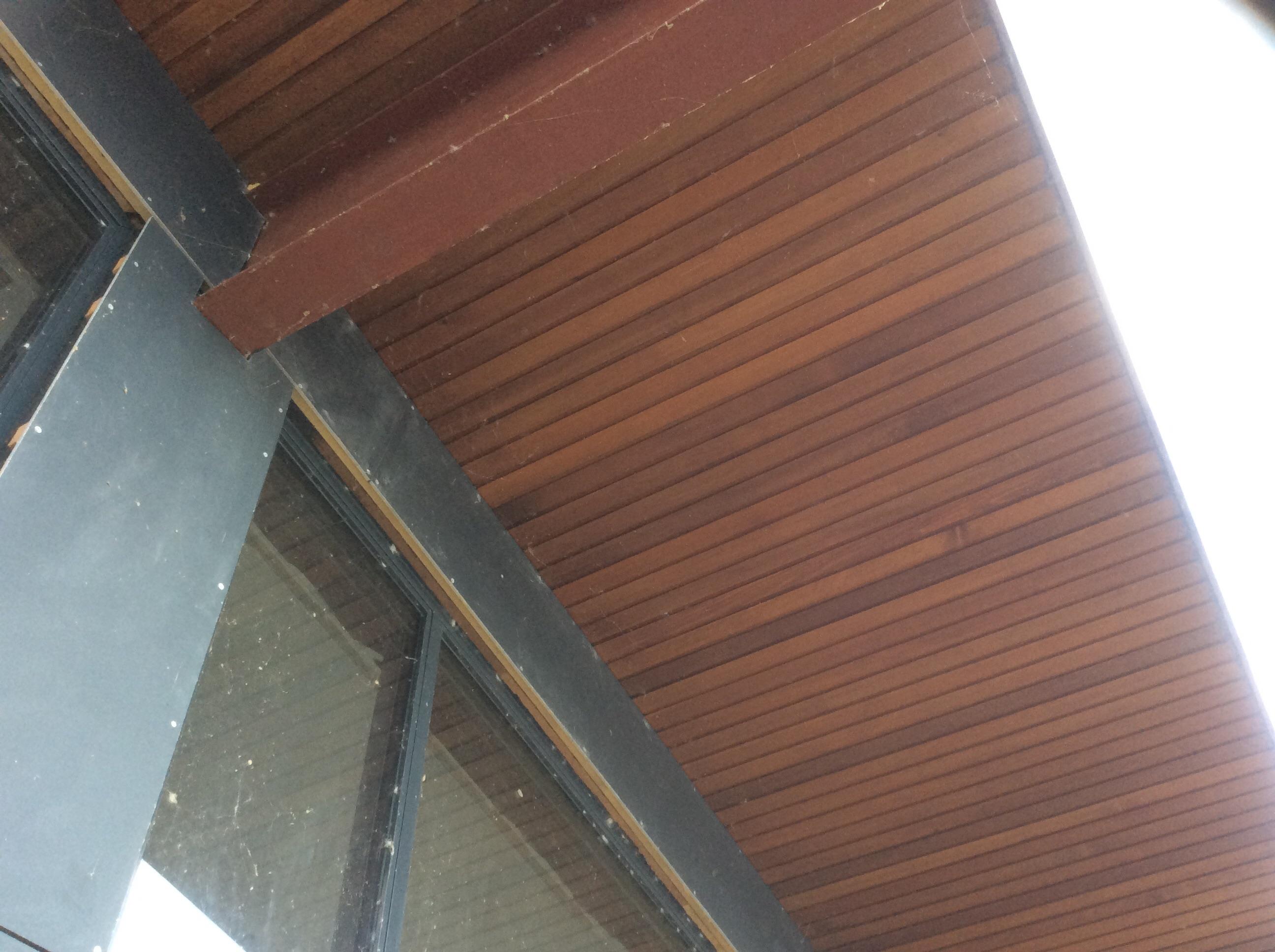

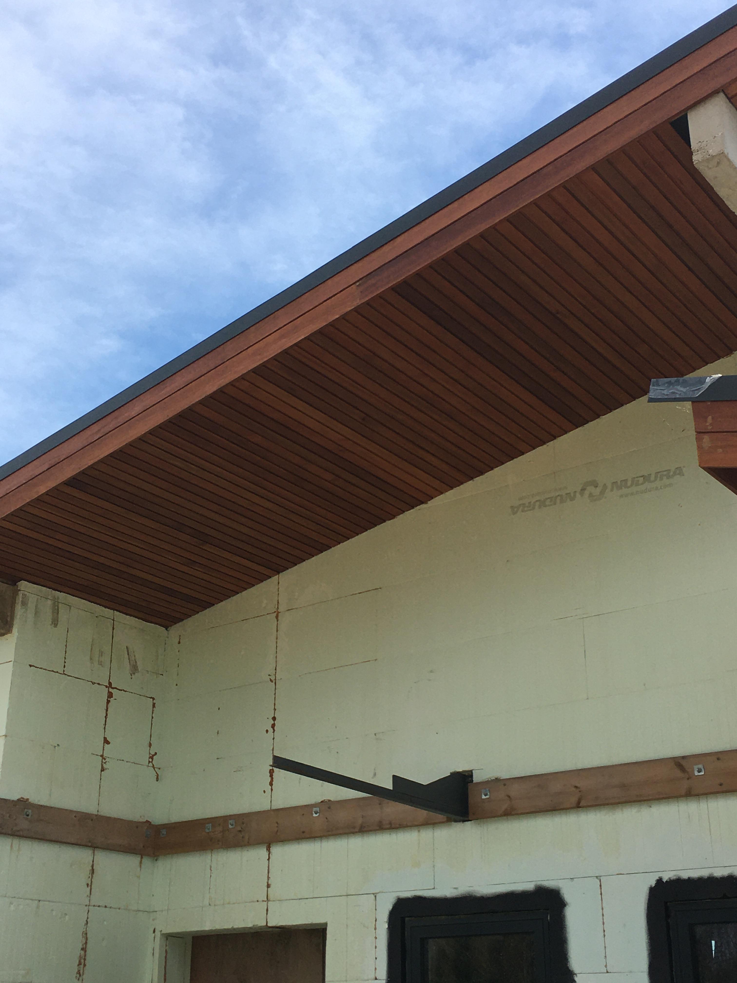

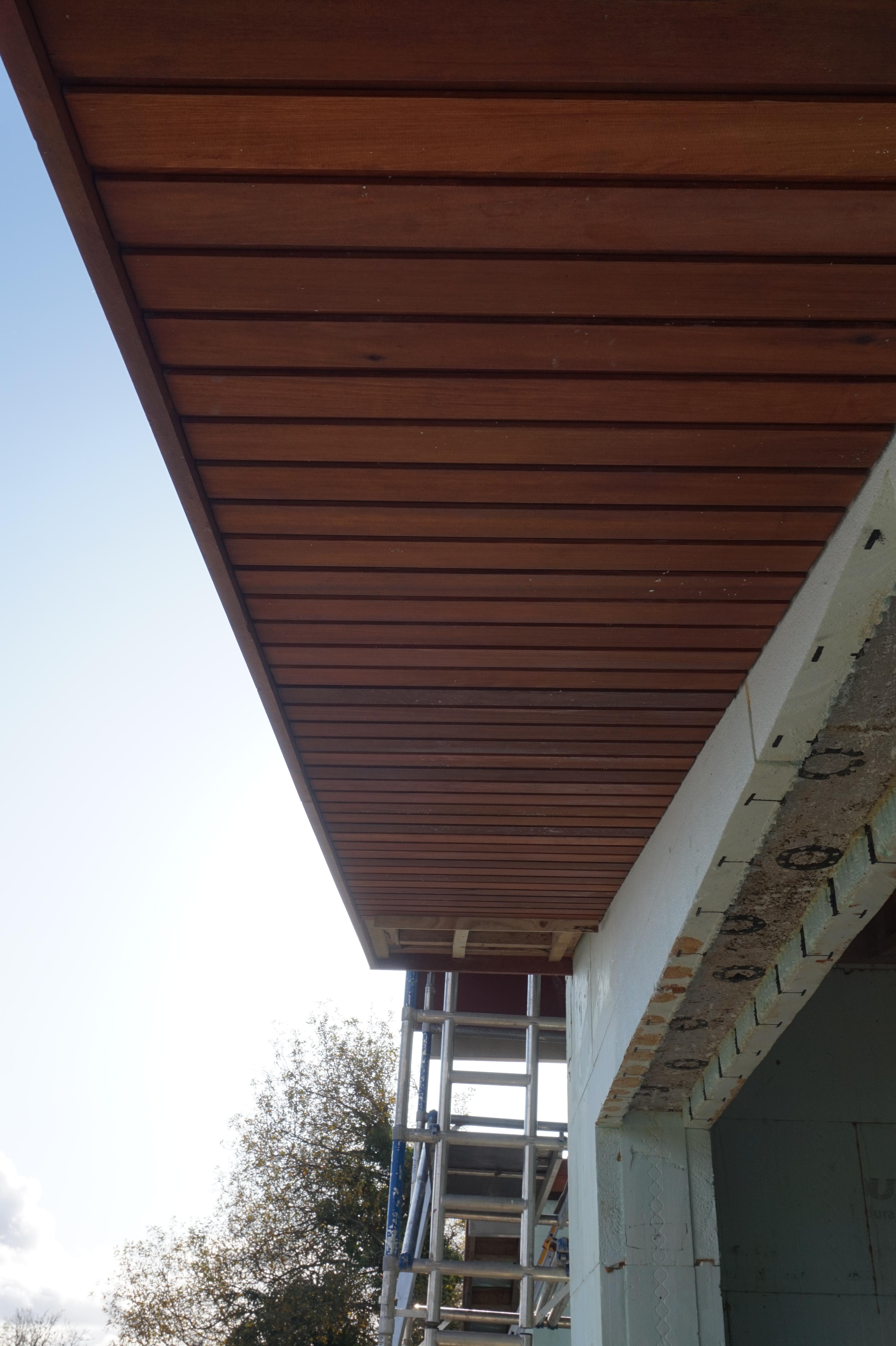

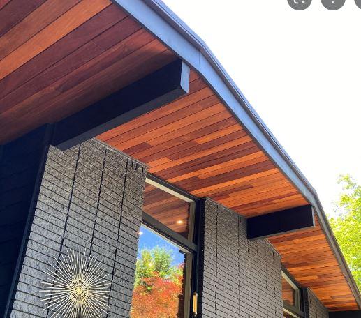

Andehh Posted September 21, 2022 Share Posted September 21, 2022 (edited) We have quite large over hangs on our white render, black windows, modern bungalow. Some of them are 1.8m, others 80cm and the rest 30cm....so they are quite a feature. The colour scheme/style we really like is below, but we are struggling on how to achieve this effect or what colours/stains we should be looking at. Our build has costed in for pine t&g boards for u to colour...but we have never done this before so are hoping for any tips or advice? Edited September 21, 2022 by Andehh Link to comment Share on other sites More sharing options...
twice round the block Posted September 21, 2022 Share Posted September 21, 2022 Wood colour looks like teak Link to comment Share on other sites More sharing options...
Russell griffiths Posted September 21, 2022 Share Posted September 21, 2022 looks like mine. 1800 wide, western red cedar and osmosis uv protection oil. It does depend what your after, you won’t achieve the look in your pic with pine, it has too many knots. You can stain it to whatever you want but it won’t have the clear appearance as in your pic. Link to comment Share on other sites More sharing options...
Dave Jones Posted September 21, 2022 Share Posted September 21, 2022 thermowood Link to comment Share on other sites More sharing options...

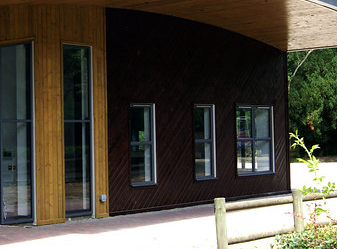

saveasteading Posted September 21, 2022 Share Posted September 21, 2022 Here is one I did, using extreme ends of the colour range from Sadolin Extra: Light Oak and Dark Palisander. The oak barely changes the colour of white pine but 'freezes' the colour for many years instead of going grey. Gives it a sheen too. Your colour is available, 'mahogany' probably. As pine will probably shrink after fixing, you should either stain beyond any overlaps before fitting, or give it a while to settle in before coating in situ, otherwise annoying 'tan lines' may appear. Horizontal (on another wall) , vertical, diagonal and overhead all on one building....Cross Referring to another discussion, I can see hiccups in this but nobody else has ever commented. Link to comment Share on other sites More sharing options...
