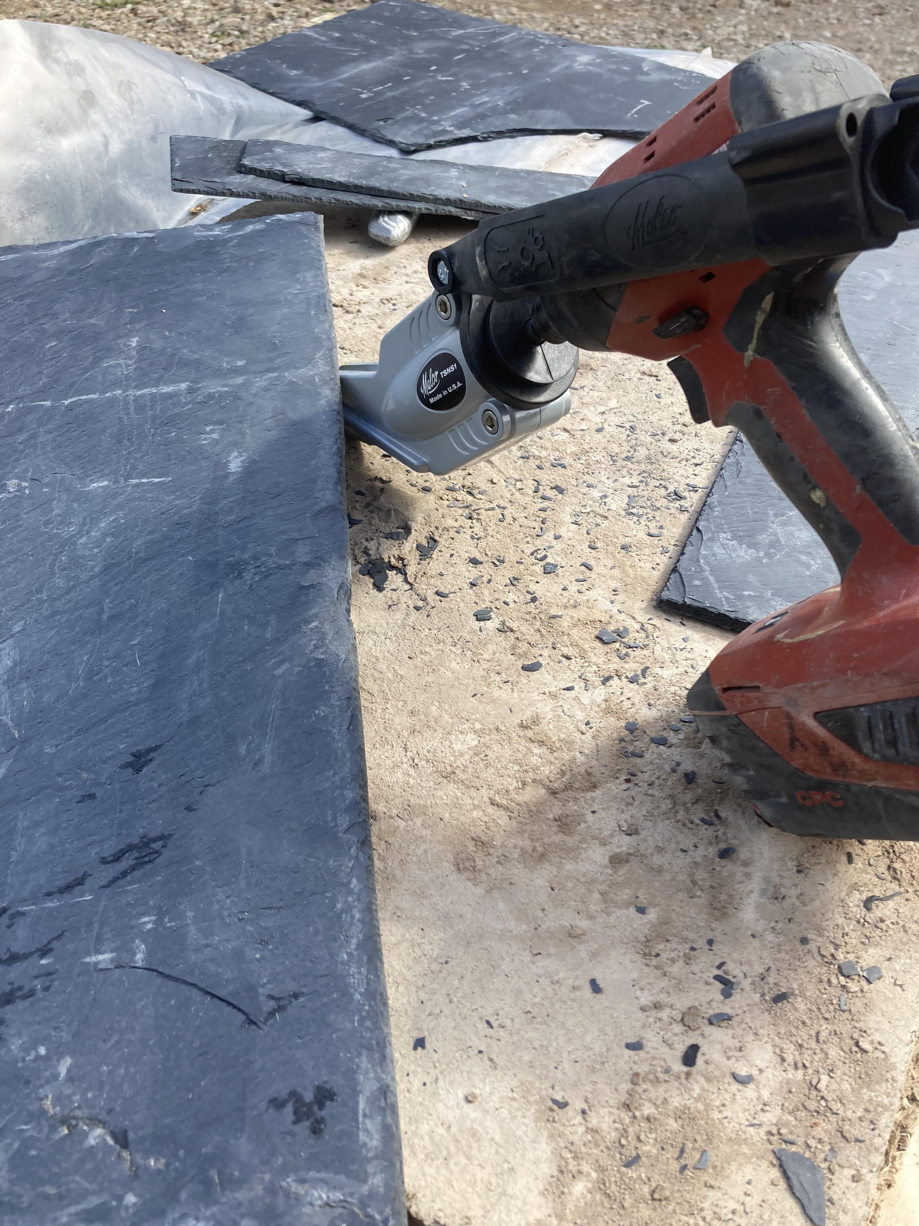

nod Posted September 16, 2022 Share Posted September 16, 2022 Just thought I’d share lots of valleys and cuts this time So I bought these from the US Give a nice cut and allows you to cut with the finished side up Instead of keeping having to flip and mark the back 1 Link to comment Share on other sites More sharing options...
Bonner Posted September 16, 2022 Share Posted September 16, 2022 Looks like a sheet metal nibbler, or is it designed specifically for slate? Link to comment Share on other sites More sharing options...
nod Posted September 16, 2022 Author Share Posted September 16, 2022 Exactly the same design But with a different blade Leaves the slate Riven 1 Link to comment Share on other sites More sharing options...
Radian Posted September 16, 2022 Share Posted September 16, 2022 Much better than a godawful angle grinder cut. Nice tool! Link to comment Share on other sites More sharing options...
Simplysimon Posted September 16, 2022 Share Posted September 16, 2022 1 hour ago, Radian said: angle grinder for slate? just used a slate knife Link to comment Share on other sites More sharing options...
