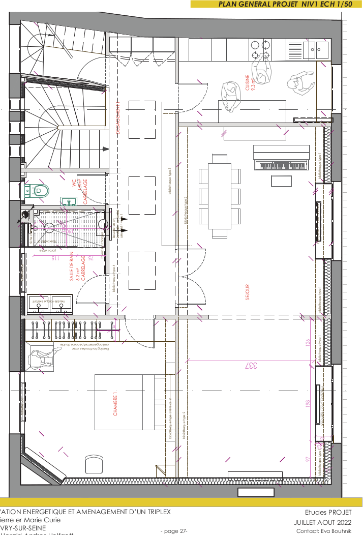

Garald Posted September 13, 2022 Posted September 13, 2022 [Preface: as quite a lot of people here know by now, I am doing a large renovation job on a place I bought in a near suburb of Paris earlier in the year. This is the last moment to make big decisions - work (demolition of some walls) should start this week. The place will be very well-insulated (for renovation standards) - 18cm cellulose on most walls, 11cm of cellulose+reflective insulation on the courtyard wall] So, (a) I am finally considering seriously installing a low-temperature heat pump, with low-temperature radiators, rather than simply switch over from a gas boiler to a HT heat pump. If I keep the number of radiators the same (14 radiators, for a place that will be about 120m^2 loi Carrez (= inhabitable area you can stand in, not counting staircases) and 180m^2 non-loi Carrez)), the net cost would be about 5800eur, including 800eur in increased work for the contractor and the architect. (Low-temperature heat-pumps are not just better, they are cheaper; however, low-temperature radiators are expensive - 650 eur a piece); (b) a friend who advises me (N. the Philanthropic Flipper) was telling me: insist on having fewer radiators; the architect finds their number to be right, but N. says architects and contractors always overestimate the number of radiators needed, at least in the Paris area. (c) the architect is a bit bothered by the possibility of a switch to low-temperature simply because low-temperature radiators are large, and we need wall space for bookshelves (I have about 1500 volumes currently, besides a vinyl collection, and the number of books seems to double every ten years) In short: how many low-temperature radiators are likely to be enough? It's a place with high ceilings on the ground floor and first floor (270cm to 290cm). Only the central part of the attic will be above 180cm. Here are the plans (already showing the insulation and the work that will be done): Presumably I want narrow, tall radiators, so as to use space efficiently (putting books right above a radiator is not necessarily a great idea in the long term, is it?). There are currently radiators under the windows, but it is very doubtful that low-temperature radiators will fit in there. For a climate table for Paris, see https://en.wikipedia.org/wiki/Climate_of_Paris Attention: the table there gives the average for 1991-2020. The climate is getting noticeably hotter in summer and milder in winter.
Garald Posted September 13, 2022 Author Posted September 13, 2022 PS. Yes, I did do the heat-loss spreadsheet, but I must have input something wrong, as I am getting unrealistically small values. Here it is. Heat loss calculator - Master (1).xlsFetching info...

Garald Posted September 13, 2022 Author Posted September 13, 2022 (edited) On 13/09/2022 at 08:56, ReedRichards said: How old are the radiators you have now? Expand Old, I take. Hopefully not from the 1930s, but old. > Do they have internal fins to increase the effective surface area? Uh... see pictures. (I'm not currently there - otherwise I could take close-ups.) >Could you cope with "fat" radiators that protrude almost 20 cm off the wall? Why not? Would fit nicely between bookshelves! >I ask because some of my new "low temperature" radiators occupy less area than the old ones they replaced. The old ones were were just double panel (c 1980) and my new >ones are mostly double panel double fins with a couple of "fat" triple panel tripe convector types. Sounds like a good idea. The architect made it sound like low-temperature radiators that fit under my (low) window-sills would be extremely expensive - is that really the case? Of course they don't have to fit there - tall, fat and narrow would also be very good. Edited September 13, 2022 by Garald
