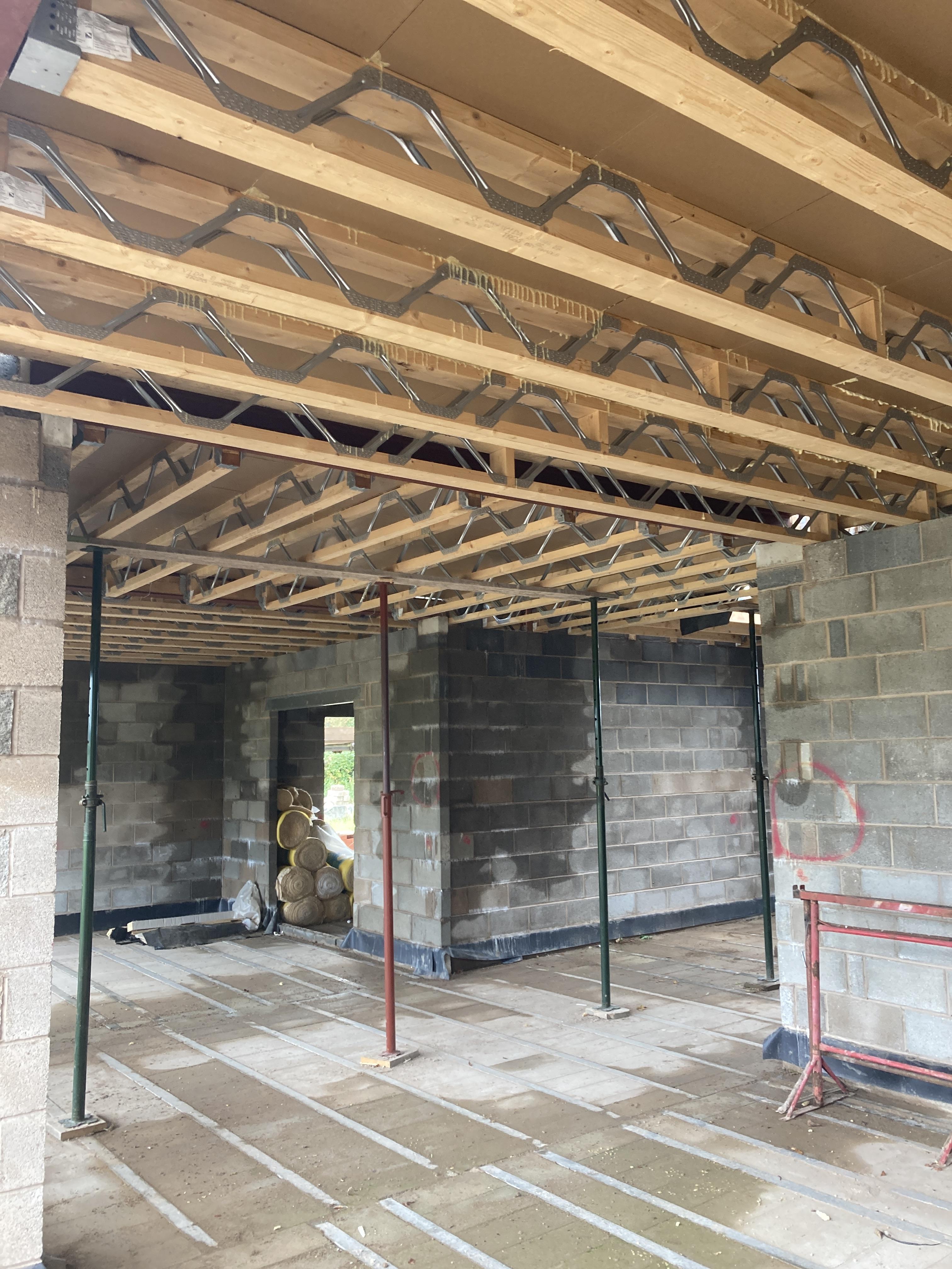

I am starting my renovation/extending/remodel project shortly where i will be adding another floor
I was planning on installing MVHR system throughout so was going to go the posi joist route
But I am toying with the idea of not installing MVHR now due to not probably getting the ACH/insulation levels where they need to be. But installing some form of MEV instead
Is it worth just installing standard joists now? Is there a big difference in cost?
I will need to run a couple of ducts (probably 125mm) through some joists, is there a way this can be done through a normal joist with support plates or something? Would only need to do 2/3
Thanks in advance
Joist selection comes down to span, floor loading, bounce, sound transfer plus ease/practicality of installation of services etc.
assuming the span is pretty average then solid joists are the easiest and cheapest for a small job. Cutting out big holes can be done but then moving to I’s or pozi’s is easier.
I joists can be fabricated on site or local joiners shop pretty easily, just add a percentage over factory produced spec as tolerances and glue is often better and more controlled.
We used I joists on our previous build
Main reason being was that they where a third cheaper than Posi
I regretted my decision as soon as I started first fix plumbing
Ive used Posi this time
Oh yes! 1st fix electrics aren’t too bad on I’s but pozi’s make plumbing or conduit (protected fire alarm cables) runs so much easier
