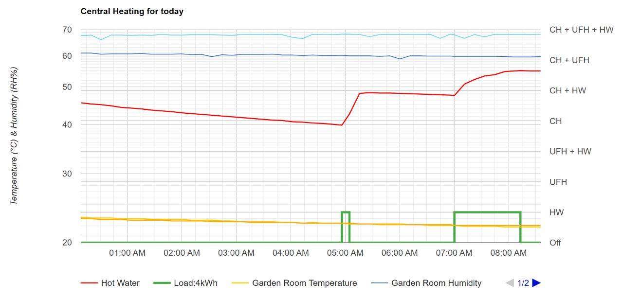

Radian Posted September 7, 2022 Posted September 7, 2022 I've been trying to reduce the flow temperature of our 30kW condensing system boiler to improve it's efficiency. The lowest I can practically operate it and have HW at 55oC, is with a flow temperature of 65oC. Any smaller difference results in extended running and short cycling. As this chart shows for the start of today, the cylinder temperature sensor governing the HW demand fell just below the overnight minimum setback temperature of 40oC and very briefly fired up the boiler at 4:56AM. The hysteresis is programmed at 2.5oC so the boiler demand ceased 8 minutes later at 5:04AM as the cylinder sensor reached 42.5oC Notice, however, that the temperature in the HW cylinder continues to rise to almost 50oC over the next 10 minutes which is how long the boiler overrun is programmed to be. This is another area that could do with more examination as it seems there was still plenty of energy to be transferred from the heat exchanger and pipe work. But the real issue comes at 7AM when the daytime temperature demand of 55oC kicks in. Initially the temperature rises quite quickly as it did earlier, due to the full 30kW being applied. But on reaching 51oC the boiler starts modulating and the rate of heating falls (as witnessed by the change in slope). When the cylinder sensor reaches 53.3oC at 7:33 the boiler switches off completely and commences to cycle on and off at 10 minute intervals at its minimum output of 10kW. This strikes me as being inefficient as it's only at 8:13, 45 minutes later, when 55oC is finally attained and the boiler demand is removed. From this it seems to me as if a HW temperature setting of 53.3oC would be about the limit of what the system was comfortable with - as this is where we get to when modulating reaches its limit and the boiler starts cycling off and on. If I drop the flow temperature below 65oC then this will push down the HW temperature by a similar delta. By inference from the numbers above, a flow temperature of 60oC would mean something in the region of a maximum HW setpoint of 48oC for sensible operation. I think this would be too low, yet people talk of boiler flows of 55oC! At the setpoint of 65oC the boiler flow itself reaches a self-reported peak of 68oC just as it clicks off. The actual return temperature at this point is 56oC also according to the boiler diagnostics menu. My cylinder sensor is typically three or four degrees lower than the return temperature which seems reasonable. Am I wrong to see on/off cycling as undesirable once the turn-down is insufficient to keep the boiler delta happy?
SteamyTea Posted September 7, 2022 Posted September 7, 2022 On 07/09/2022 at 10:13, Radian said: Notice, however, that the temperature in the HW cylinder continues to rise to almost 50oC over the next 10 minutes which is how long the boiler overrun is programmed to be. Expand When a cylinder is heated from the base, there is a fair amount of turbulence in it. Take away the heat source (no input to coil at base) and there will still be some turbulence for a few minutes. That needs to settle before a true 'spot' temperature reading can be taken. What does this mean?
JohnMo Posted September 7, 2022 Posted September 7, 2022 Couple of things going on. A cylinder with a coil is designed to have around 75 degree flow temp going into it. As you reduce the flow temp the heat exchanger coil cannot transfer the heat away very well. When you get a certain point in the heating cycle the boiler will trip on a high return temp. Then go in to short cycling. As you are seeing. Not efficient. You may use less gas by ramping up the flow temp to 75, your return should be around 55. The heat cycle should be quite quick.
SimonD Posted September 7, 2022 Posted September 7, 2022 What boiler make and model have you got? It's worth checking if it can be configured for priority domestic hot water. Some system boilers can't and are dependent on the same setting for both CH and DHW. And some boilers that can be configured that way don't tell you they can be so you have to figure it out. I can tell you that Ideal boilers can and it's very simple, giving 80 deg DHW and modulating CH even though the installation manual doesn't tell you this explicitly.
Radian Posted September 7, 2022 Author Posted September 7, 2022 On 07/09/2022 at 11:12, SteamyTea said: What does this mean? Expand It's an estimate of the gas consumption. On 07/09/2022 at 11:52, JohnMo said: You may use less gas by ramping up the flow temp to 75, your return should be around 55. The heat cycle should be quite quick. Expand If the return was 55 then yes it should be in condensing mode but in practice (my experience) a 75 flow will result in a return over 60 and lose out on efficiency. Obviously there's a trade-off here somewhere but it'd take some finding. On 07/09/2022 at 12:11, SimonD said: What boiler make and model have you got? Expand It's a Glowworm Flexicom 30hx The manual is very opaque on HW priority hinting that it all happens using auxiliary eBus control but I don't have that. Not unless I hack something together.
