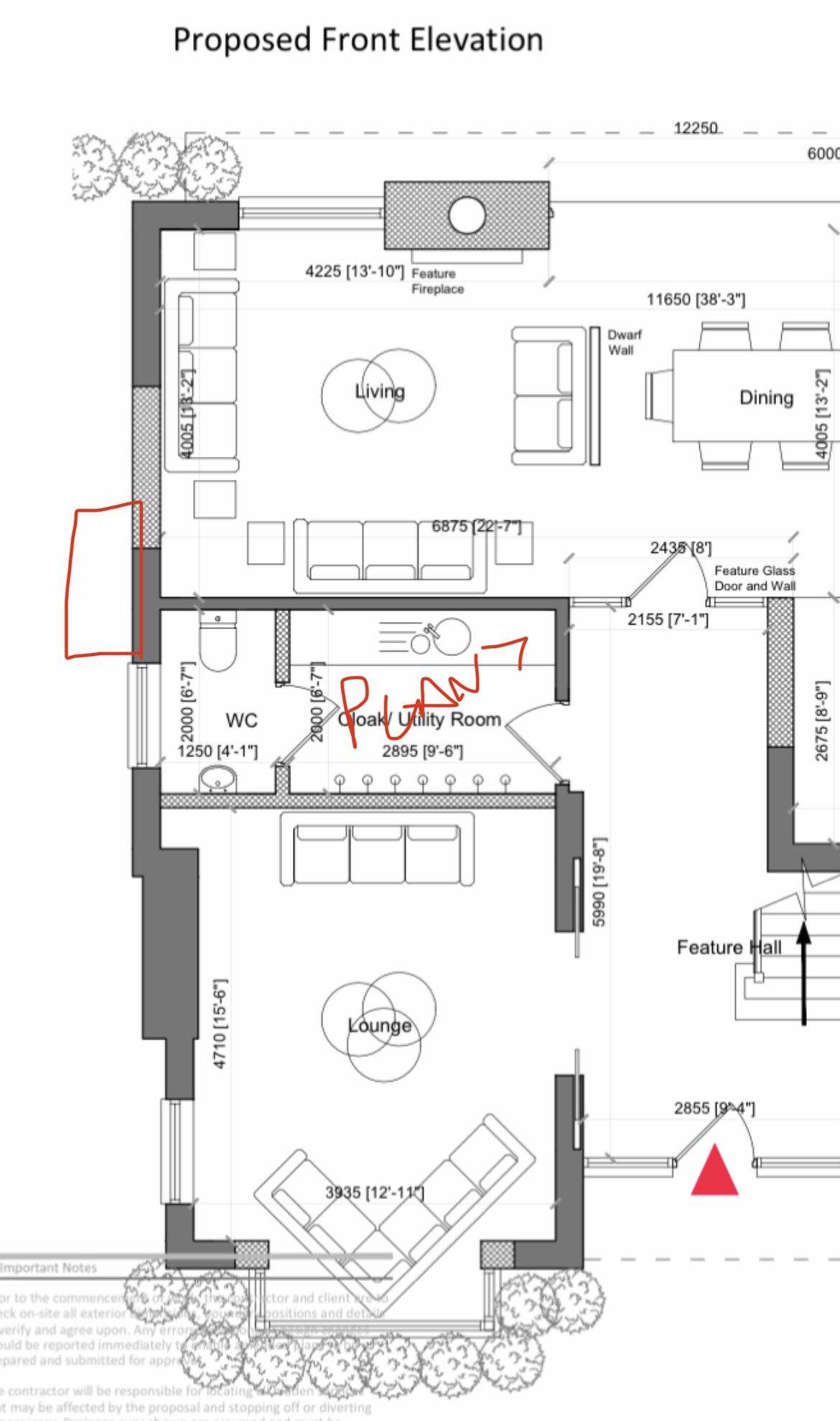

richo106 Posted September 3, 2022 Posted September 3, 2022 Hi We are having an ASHP installed in our renovation project and the contractor has requested 2 x 28mm insulated main flow and return pipes from our plant room to ASHP outdoor unit. (See attached pic) They said it’s better under the floor, we are having a complete new floor put in, 200mm hardcore, 150mm concrete slab, 200mm PIR, UFH pipes, 50mm screed. whereabouts within the floor would you put these pipes? Would you put them in a duct incase they need replacing or anything? Any advice or information greatly appreciated Many Thanks
TonyT Posted September 3, 2022 Posted September 3, 2022 I would swap the WC and plant room about and no worries about underground pipes, just straight through the wall..
ProDave Posted September 3, 2022 Posted September 3, 2022 I would run the ASHP pipes, and don't forget cables as well, within the thickness of the wall between plant and living room. Assuming it is a stud wall? It is a brave plumber and electrician that wants to drill the holes for pipes and cables before the ASHP is on site. Last one I did we waited until the ASHP was there before drilling holes and running cables and pipes.
richo106 Posted September 3, 2022 Author Posted September 3, 2022 On 03/09/2022 at 19:21, ProDave said: I would run the ASHP pipes, and don't forget cables as well, within the thickness of the wall between plant and living room. Assuming it is a stud wall? It is a brave plumber and electrician that wants to drill the holes for pipes and cables before the ASHP is on site. Last one I did we waited until the ASHP was there before drilling holes and running cables and pipes. Expand Good idea, it’s not a stud wall it’s a block wall. I can just stud the back wall of the WC anyway to house the pipes and cables as required
