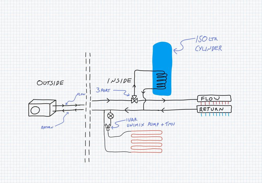

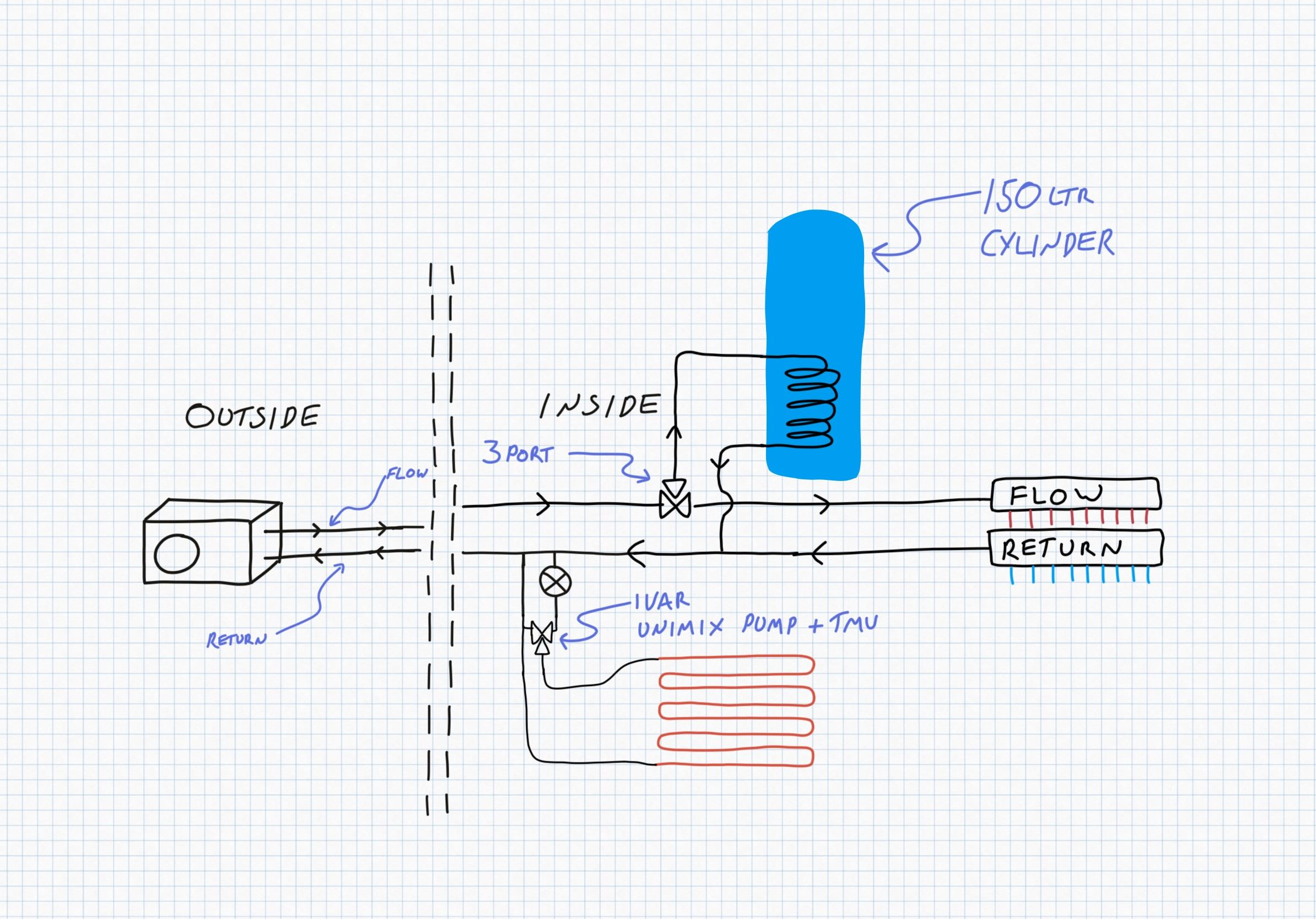

HughF Posted September 2, 2022 Share Posted September 2, 2022 I'm going for UFH in 100mm slab in the extension (south facing), tied to the mesh on 50mm stilts, new rads in the rest of the house (as it's a retrofit)... Whole lot will be driven from a 9kW (max) ASHP running in weather comp mode. I can't size the rads for the UFH flow temp so I'm going to set the weather comp up to suit the rad sizing then use a blending valve and pump station at the UFH termination. I want to do this without a LLH or buffer if possible (for efficiency and space constraints) but I'm pretty sure I'm going to need at least some sort of hydraulic separation between the different flow rate emitters. Anyone have any input on this? Should I make allowances in the design for a buffer or LLH? Link to comment Share on other sites More sharing options...
JohnMo Posted September 2, 2022 Share Posted September 2, 2022 You could run you piping to the rads and use two close coupled tees on the return line to supply the UFH. So the return water out of the rads if no UFH is on would flow direct back to the UFH. If UFH is on, water would be borrowed from the return via the first tee, then after flowing through the UFH would return to the radiator return via the second tee. Using the close couple tee there is hydraulic separation, between to boiler pump and the ufh pump. You will need to find the min flow rate and system capacity for heat pump and make sure the system is big enough and there is enough flow Run the whole lot as a single zone, will keep the system from short cycling. 1 Link to comment Share on other sites More sharing options...
HughF Posted September 2, 2022 Author Share Posted September 2, 2022 3 hours ago, JohnMo said: You could run you piping to the rads and use two close coupled tees on the return line to supply the UFH. So the return water out of the rads if no UFH is on would flow direct back to the UFH. If UFH is on, water would be borrowed from the return via the first tee, then after flowing through the UFH would return to the radiator return via the second tee. Using the close couple tee there is hydraulic separation, between to boiler pump and the ufh pump. You will need to find the min flow rate and system capacity for heat pump and make sure the system is big enough and there is enough flow Run the whole lot as a single zone, will keep the system from short cycling. Assume that you meant 'So the return water out of the rads if no UFH is on would flow direct back to the ASHP'? The setup with close-coupled T's in the return line makes perfect sense, cheers. I'll design around this. I was planning on having all the heating emitters on a single zone but manifold plumbed, just so I can easily balance at the manifold (I have the manifolds already, and all the mlcp pipe).... Link to comment Share on other sites More sharing options...

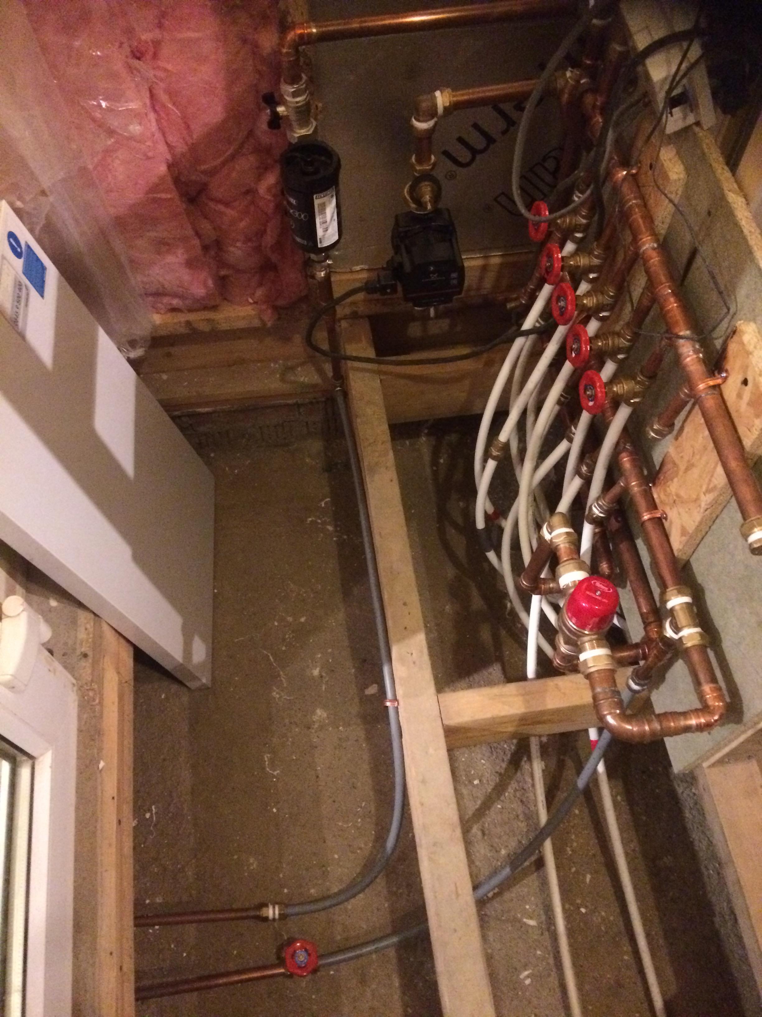

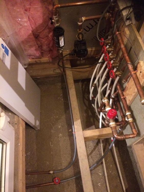

Gus Potter Posted September 2, 2022 Share Posted September 2, 2022 3 hours ago, JohnMo said: You could run you piping to the rads and use two close coupled tees on the return line to supply the UFH. The close coupled tee is a good concept.. I experimented with this.. it worked for some of the time but not all the time. My rads have TRV's so things / flows were always changing.. or maybe I should stick to other stuff.. I probably know enough about plumbing to be dangerous! I made a home made manifold to test how I could couple an old council house up with a modern extension with UFH. It's working great so what luck! Photo uploaded Link to comment Share on other sites More sharing options...

HughF Posted September 4, 2022 Author Share Posted September 4, 2022 On 02/09/2022 at 23:08, Gus Potter said: The close coupled tee is a good concept.. I experimented with this.. it worked for some of the time but not all the time. My rads have TRV's so things / flows were always changing.. or maybe I should stick to other stuff.. I probably know enough about plumbing to be dangerous! I made a home made manifold to test how I could couple an old council house up with a modern extension with UFH. It's working great so what luck! Photo uploaded No trvs for us. the doors are always open to all the rooms, the house is tiny and we don’t have the luxury of unused rooms 🤣 Link to comment Share on other sites More sharing options...
HughF Posted September 12, 2022 Author Share Posted September 12, 2022 Done a quick sketch, anyone care to comment? Single manifold set shown for the rads, I’ll probably have one upstairs and one downstairs. Link to comment Share on other sites More sharing options...
