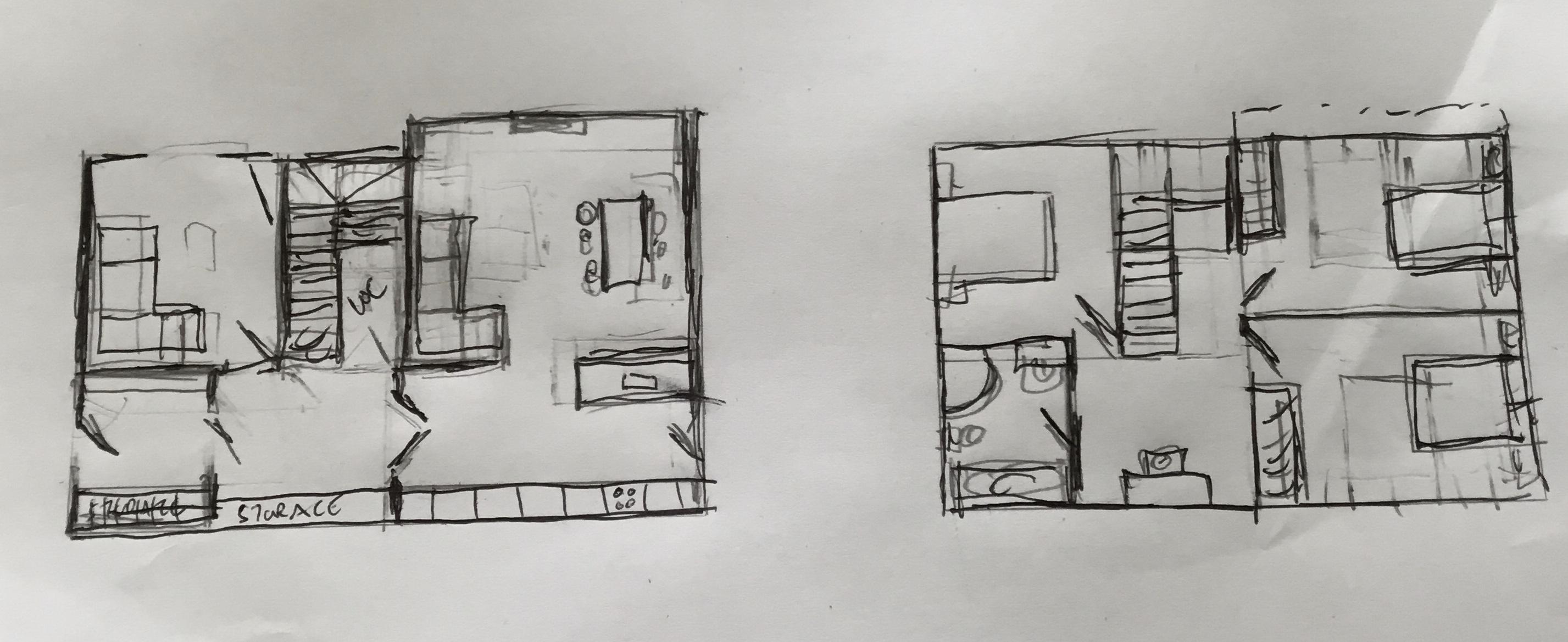

On 31/08/2022 at 19:52, morgan_22 said:
Me and my partner are currently in the process of buying a plot situated in West Wales to build our first home.
Well done to you both. The main thing it to also enjoy the journey!
I wonder though about the layout of the kitchen living area and lobby. They say first impressions count. The first thing you'll see (and your guests coming for the great grub) when you come into the room from the lobby will be the kitchen and your cooking innovation / what you are up to. Also I think that they will see not least the narrowish space between the peninsula unit and the hob.. it could look like you are going into a small flat? You want the wow factor when you come in and that is the open living space and being able to see the fire place. Where you have the stair invites the eye..so take as much advantage of that as you can. I would look to create the impression of open space as soon as you come in the front door.. then tease with the staircase.. what else is up stairs??.. just how big is this place?
Also remember that at say xmas the house could be full..where is the oven and where is door to open? Will an open oven door further restrict the kitchen activity space and pedestrain route to the ground floor wc ? Check the building regs for Kitchen activity spaces / accessibilty at this stage.. better to do this now.
I can see you have got someway with the screen concept.. keep going. Have another go at the kitchen and living space. Things to think about are.. yes you don't want the front door open and a huge draft coming into the room.. but you can have walls that don't go all the way to the ceiling. This also lets you shine diffuse light over the top of them while still cutting out the big drafts. This can work both ways.. the living space could be dark with diffuse light coming over the top from the "lobby".
It also means you can have kitchen units hidden behind. Walls can be solid but split with glass, again with careful choice you can invite the eye to appreciate the whole room as one space while still achieving the practical side of things.

The Living / Dining / Kitchen area layout was a real headache to design as i tried to maximise each space without creating any wasted space. I might have a rethink with regard to the lobby & what you see when you enter the front door as your points are very valid. Please have a go yourself if you have the time.
We currently have 1200mm between the peninsula & wall cabinets so that should allow sufficient space to allow someone to walk through when a cabinet or oven door is open.
Yes, we'll need a beam to span where the ground floor steps out and a post & small beam at the corner between the sliding doors & full height window.
I was thinking of using a CLT/Glulam ridge beam (budget depending!) but splitting it into 3 and making sure there's a solid wall below is a good idea.

Agree with comments that budget too low.
Agree with going through kitchen to get into house bad idea.
If you can mirror the external house design you could have something like this.  Maybe you cannot for some reason.  Might even get three bedroom in upstairs but if space more important than bedroom numbers, two big bedrooms.  Thrown together this just to give you ideas.  If you only need 2 beds upstairs so be it.  Is 2 bathrooms upstairs a necessity in a wee house.
rotating house to put kitchen at back gives easier access to like of bin store etc near shed etc.
with a more modest size house incorporate as much integrated storage as possible. Looks sleeker, and means you need to buy less furniture.  You don’t get VAT back on a built wardrobe, but you do on an built in cupboard.  Having separate snug downstairs, convertible into bedroom,  in addition to open plan living space v good idea.

Thanks for the comment!
Will have a re-think regarding the entrance layout & kitchen (and maybe the overall layout).
Regarding the budget, what figure would you think would be more realistic?
We are currently in the feasibility stage and at the moment we are struggling to see how building would be cheaper than buying a small house & renovating, even though house prices are at an all time high.

I've had a play around with the layout & spaces in the last week, we decided to change the layout to fit two small dbl bedrooms instead of one large dbl bedroom on the first floor as this would increase the value of the finished house.
Attached the updated plans & elevation drawings for your comment!

I like the project as well, especially the upstairs open to the warm roof.
You should know being an AT, but check if the number of bedrooms you submit with requires an extra parking space or other stuff (minimum private outside space is a common one - may require an opaque tall front gate so your front lawn is private) under policy. It should be easy peasy to leave it as 2 big bedrooms upstairs and divide one later.
Does your downstairs shower room meet disabled 'turning circle' regs?
Personally  I prefer roof windows to be towards the top more than you have it, so there is a sense of light from the sky - unless they are ones you need a view through.
Keep your staircase gradient as shallow as possible (ie towards 35-37 degress rather than 42), as it makes the whole house feel more luxurious. If you can.

Do you plan on living here a while? If so do you need the extra bedroom or will it be a room that never gets used? I think you should design your house for you and use every sqm and not the next people but have enough flexibility in the design to easily change it should you sell it. Our house design only has two rooms described as bedrooms, one upstairs and a guest bedroom downstairs beside a big wheelchair friendly bathroom. Upstairs is a master bedroom suite with large bedroom, large bathroom, and a large dressing room that’s open at the top of the stairs. It also has a study downstairs that’s beside the downstairs bathroom. Therefore can either be a two bed house, three bed house or a 4 bed house with a little modification.
On the rooflights - I agree with Ferdinand, if you have a nice view then make sure you can see it from upstairs. If not then maximise light. Ours are 1600x900 to let us see the view we paid for and to let in lots of light.

Yes, 2 car parking spaces will be sufficent for a 3 bed dwelling as we are in a suburban area. The plan was to have a tall gate & fencing to give us plenty of privacy to use the front garden.
No it doesn't comply as an accessible shower room but this is not a necessity as we only need space for a small downstairs WC & shower.
That's a good point regarding the roof lights as they will only be used to flood the landing/staircase with light so i'll definitely move them higher towards the ridge.
I doubt we'll be able to reduce the pitch of the stairs as i'd like to keep the staircase area as compact as possible to retain the small upstairs study space.

Is not the issue with the downstairs loo is that wheelchair accessibility is a Building Regs requirement? I am not sure whether the shower is required to be accessible. But this is again your subject, so I guess you have that covered.
Also I think I recall that a raft of new Building Regs came in on I think June 15th this year.
I'd encourage you to do the more relaxed stairs to the extent you can - you lose about half a square metre and it makes a noticeable difference.
