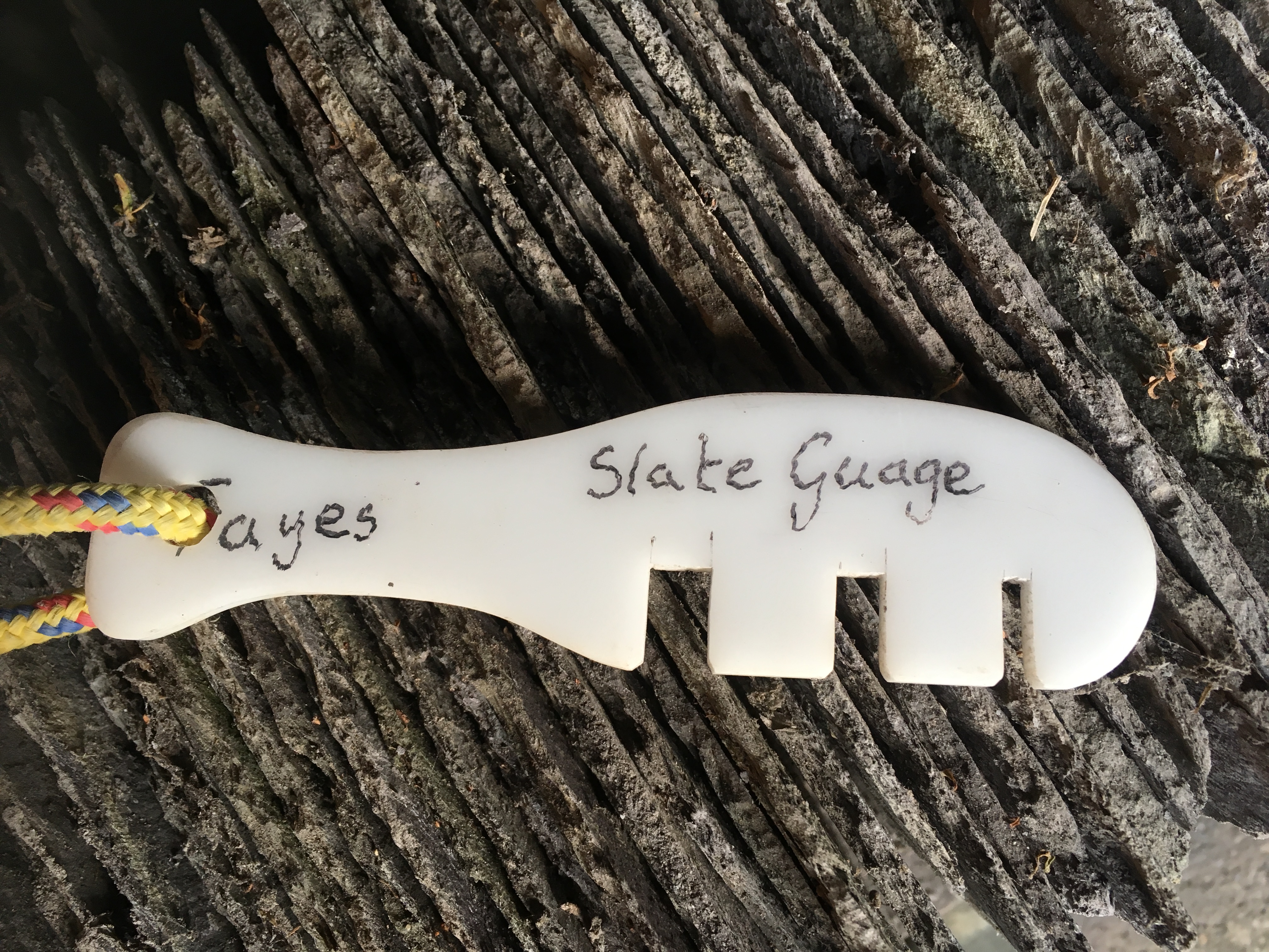

Construction Channel Posted June 10, 2017 Posted June 10, 2017 Ignoring Faye's poor spelling it is great for its job. Sometimes you can tell at a glance but it's been nice to have just to check the borderline slates.
Onoff Posted June 10, 2017 Posted June 10, 2017 Lucky she doesn't teach kids how to spell! For a minute I thought you'd got the letters wrong on that clay brick.
Construction Channel Posted June 10, 2017 Author Posted June 10, 2017 10 minutes ago, Onoff said: Lucky she doesn't teach kids how to spell! Anymore 1

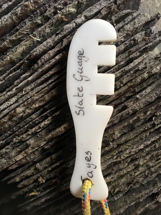

MikeSharp01 Posted June 11, 2017 Posted June 11, 2017 So only those that fit in the middle slot are acceptable? If so why do you need three slots OR are you sorting them into three thicknesses and rejecting everything else in which case you need three? The go / no gauges (guages) I have ever used only had two slots / ends, what have I missed, its early?
Construction Channel Posted June 11, 2017 Author Posted June 11, 2017 You have missed nothing. After I made it I realised the big Slot was pointless. I'm useing it to grade the slates into 3 thicknesses. Thin ones go at the top. But assuming the slate didn't fit in the thin or medium slot then it goes in the thick pile anyway. ?
Barney12 Posted June 11, 2017 Posted June 11, 2017 1 hour ago, Construction Channel said: You have missed nothing. After I made it I realised the big Slot was pointless. I'm useing it to grade the slates into 3 thicknesses. Thin ones go at the top. But assuming the slate didn't fit in the thin or medium slot then it goes in the thick pile anyway. ? How did you decide on your slot widths?
Construction Channel Posted June 11, 2017 Author Posted June 11, 2017 28 minutes ago, Barney12 said: How did you decide on your slot widths? just guessed really, I went through a few slates and picked a thick, thin and medium slate, then measured them with an adjustable spanner because I couldn't find my calipers, then cut out the corresponding slots on the band saw 1
